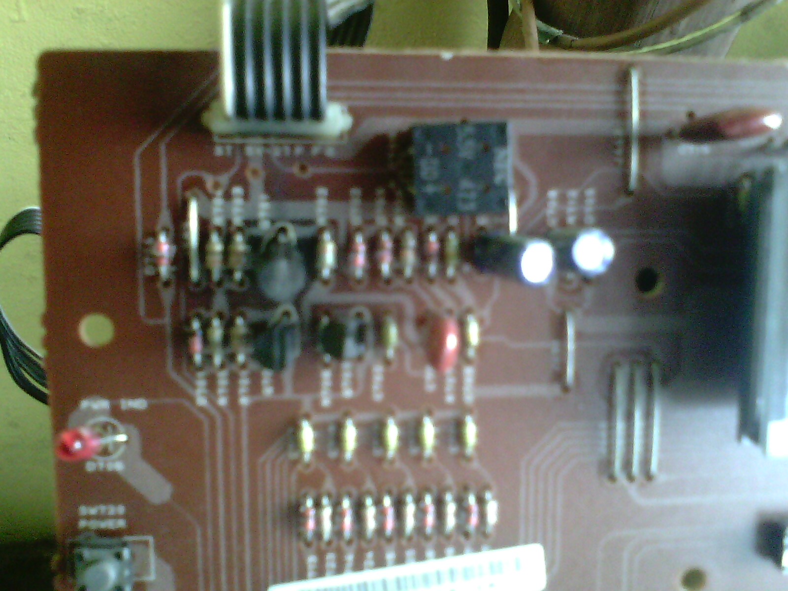

Hi diy friends....I've bought a unit of sherwood es-5030r from a local junkshop for 10 usd equiv. it looks clean and no severe scratches....when i opened it it seem that some fuse are missing and no rating is indicated on the board...its a surround a/v amplifier...3 channel using STK400-090 chip as amplifier...

I had replaced the fuses with low values 1A, upon power on, no fuse blows but the stand by trafo is working and the power led lit and the 6 equalizer mode led lit, pressing the button will not turn on the main trafo since it is triggered by a relay. Anybody has an idea? I can't find schematics so I'm tracing it manually.

Finally got hold of the service manual and found out the problem. Just replaced 2 small over heated trannies and bingo!..I got a Digital surround processor at 10 USD worth plus a dollar worth of parts....not bad..
Here is the faulty ckt board and the system..Sherwoord DSP, 6R2p Tube amp on old pioneer chassis and Luxman Hybrid LV103...
I have sound output problem with the same device. I replaced the stk400-090. Now signal is input to KIA4559 but no output. I have ordered for KIA4559S to see if the problem will be solved by replace the ic.
