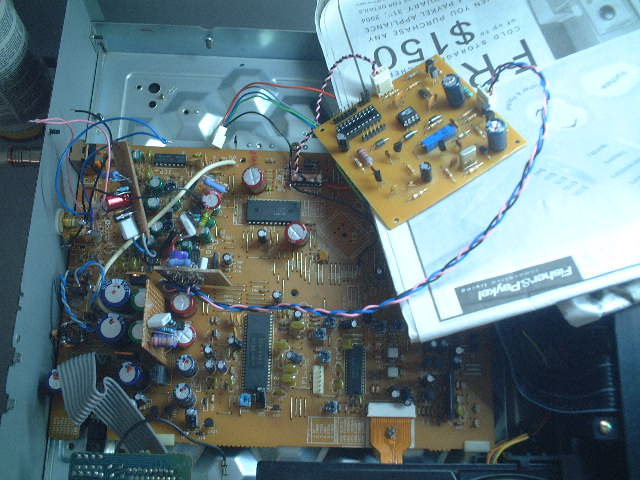

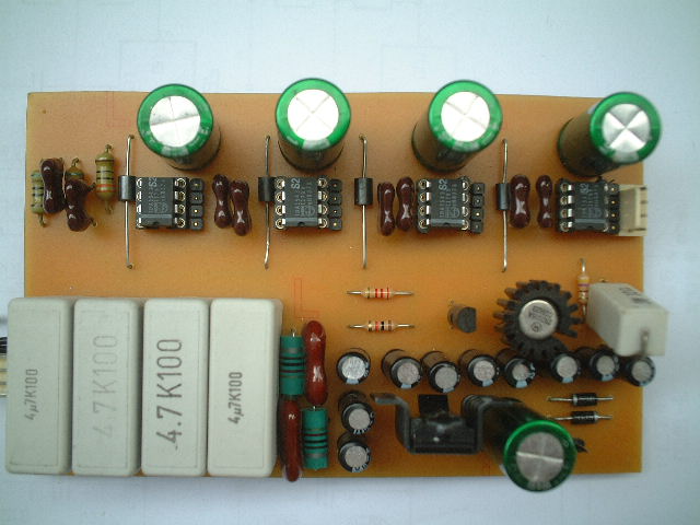

My heavily modified Pionner CD player. Made all these changes:
1. All diodes changed of schocky 1N5817. Bypass the diodes with caps.
2. COmmon mode choke before the bridge rectifiers.
3. replaced all the 78xx and 79xx regulators with TL431 derived ones, with LC choke inputs and Sulzer inspired cap across cathode to ref to reduce gain as freq increase ( gives better trebles )
4. NE5534 changed to LM6172
5. removed coupling caps and muting caps at output.
6. implemented KC7 clock. Picture below shows the PCB ( with Elso's asychn reclocker not completed yet - cannot find 100 MHz crystal. I will not provide the PCB as it is not my IP to give.
Alternative output:
1. Tapped EIAJ signal from CXD1135 to connect directly to TDA1543As
2. EIAJ converter to I2S to connect to TDA1541As
3. Valve output for the TDA1541A

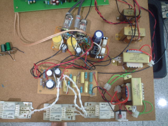

Pictures of the valve output stage:
Yes, I used common flourescent lamp ballast as chokes, and two halogen lamp transformer for the PS. One for the filament, and the other to step back up to 240Vs. The 13W ballast are cheap, 3H in value, and can take 170mA. I hope my missus do not find out that certain lights in the house no longer work not because they failed....

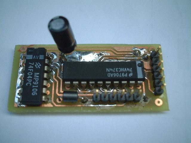

My Sony EIAJ format to Philips I2S converter:
This is a simple circuit. After analysing the timing diagrams of the two formats, what is actually needed is a simple delay of LRCLK by 7 BCK clocks, and for it to be inverted. Data and BCK can pass through.
The circuit consist of a VHC374 wired as a shift register – input at D1, Q1 to D2, Q2 to D3 etc. BCK is inverted to clock the 374 as it is rising edge, and then inverted again to output as I2S BCK. LRCLK is inverted by three gates and fed to D1 of 374. I added two more gates to delay LRCLK so that it is two gates delayed from when the inverted BCD clocks the shift register.
I have used up 5 of the 6 74F04 NOT gates and hence cannot buffer DATA by two NOT gates. Hence I just feed it through. Timing is not an issue as Data is clocked in the middle of BCK and hence the two gates delay of BCK is not significant. However, if you load Data by more than one gate, it might be a problem. I have loaded it with four TDA1543 with no problems.
The above works if you have 16 bits EIAJ to 16 bits I2S. I have provided taps at D5 and D3 so that you can use 18 bits and 20 bits EIAJ as well, but I have never tested it.
You can use the same scheme to convert from I2S to EIAJ. Just delay Data rather than LRCLK, and invert LRCLK.
I have the schematic and PCB in Protel 99.
For my Pioner player, it uses a CXD1135. The pin outs are:
BCK - pin 76
LRCLK - pin 80
Data - pin 78
It is the same pins for CXD1125. I do not have the datasheet and found the pins by probing for the signals, 2.11Mhz, 44.1kHz, and a random signal.
