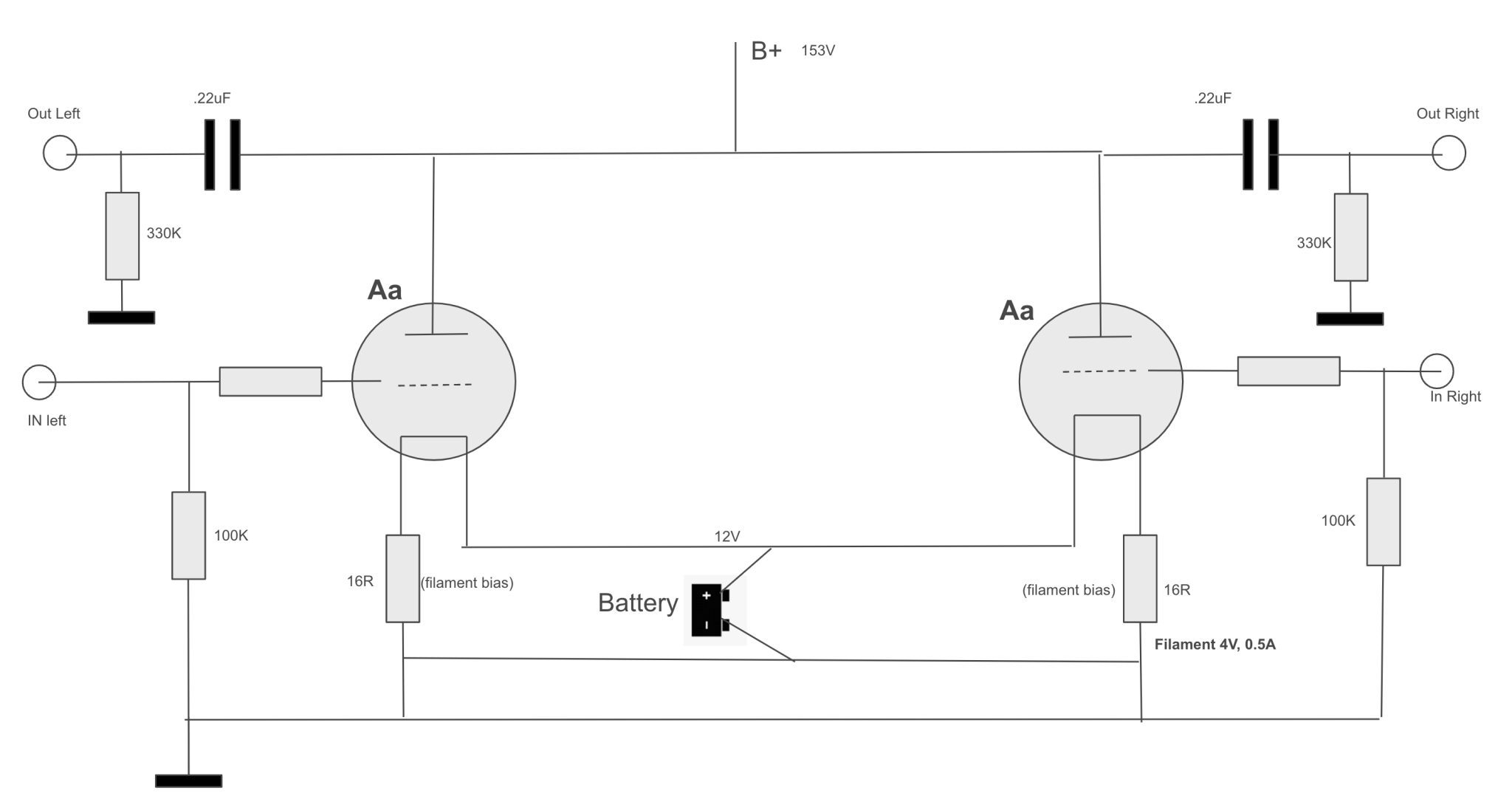

Q: Can tubes (2 final tubes in a pre-amp) share the same DC battery filament supply, assuming sufficient current and voltage from the battery? This would be using LED cathode bias. Or, I could go with filament bias. Not sure if there will be crosstalk between the tubes as they share the same DC supply. Thoughts?

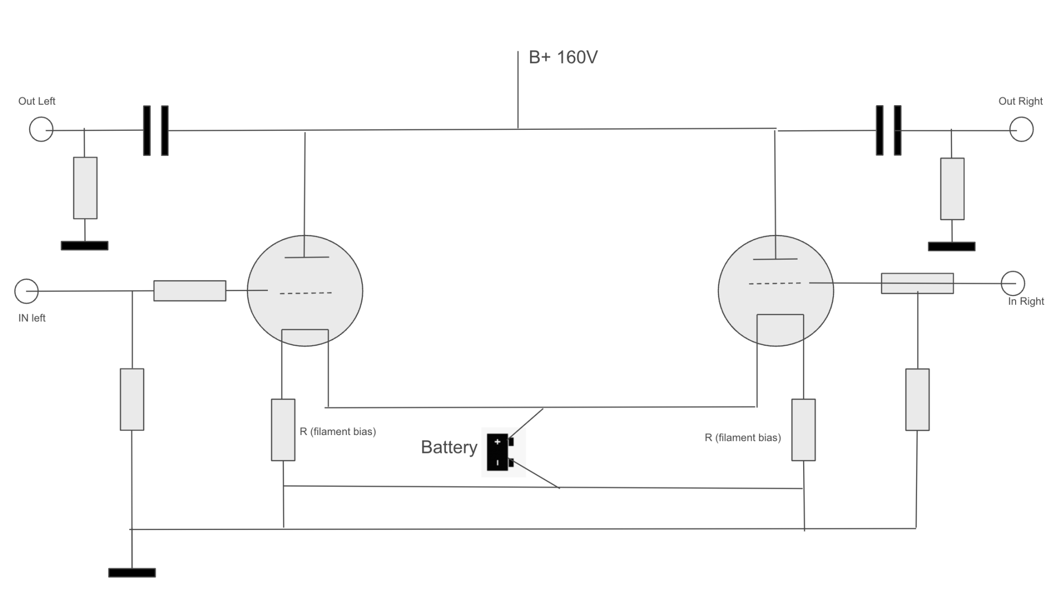

Stereo pre-amp, with shared B+ and shared Battery filament supply.

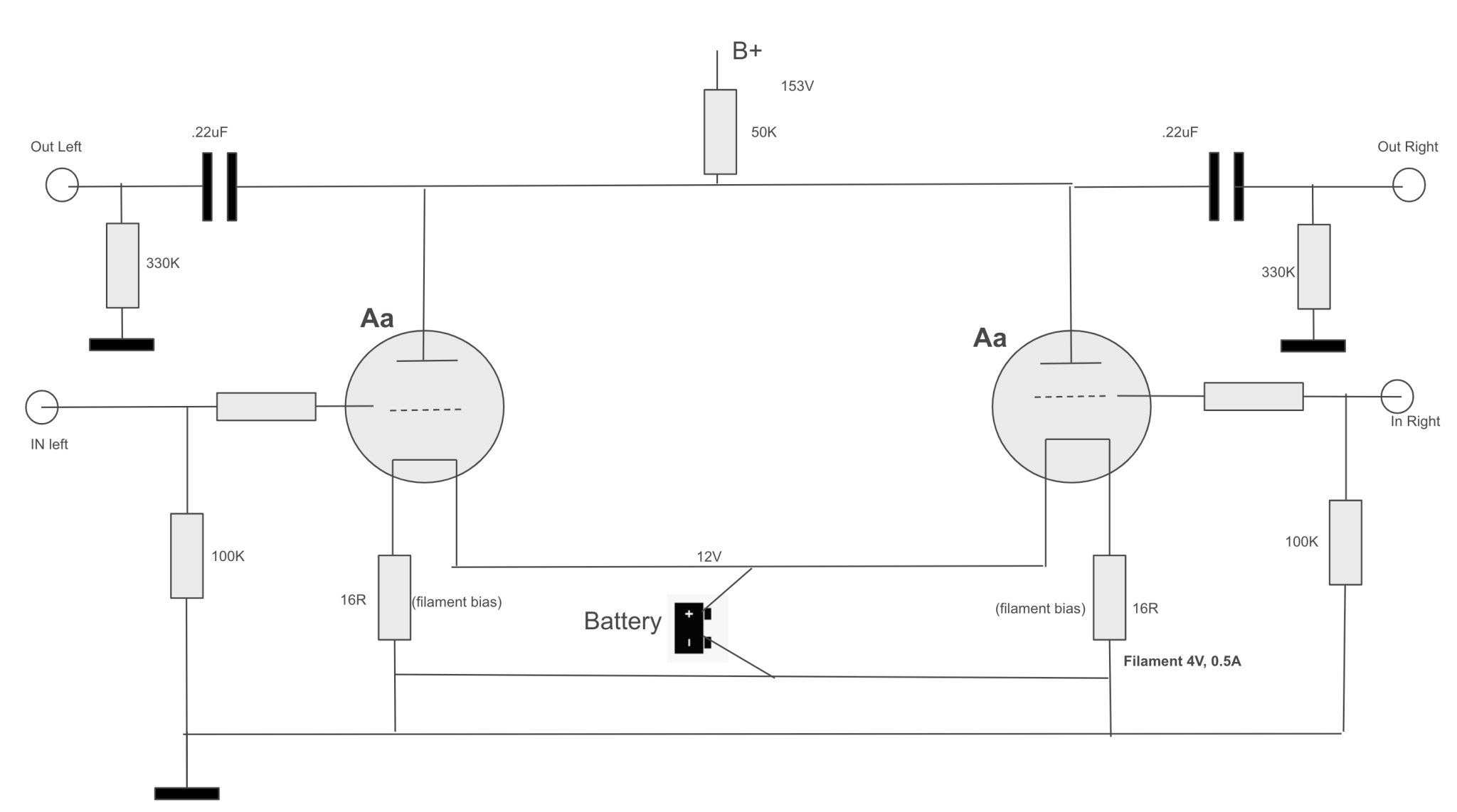

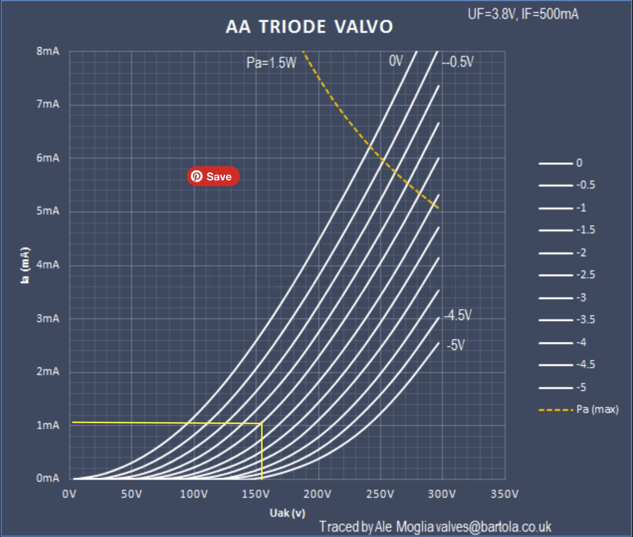

This is going to drive a solid state power amp with impedance of 10K. Attached is an updated schematic with the 50K plate resistor. I don't need much gain. Rather, I am after the tonality of the Aa tube, which is fantastic. Maybe we should consider lowering the 50K plate resistor to minimize gain? The Aa internal plate Ri = 30K. See attached schematics and Aa curves. This pre-amp is biased for 2V.

There's a few issues I see. Typically, a triode wants to see 3-5x it's plate resistance to minimize distortion. 50K is already way too low. Next, the ROT for impedance matching between stages is a ratio of 1:10. For your 10K input impedance amp you need a preamp with an output impedance of 1K or less. This is going to be nowhere near that. Speaking of input impedance a 0.22uF cap is way too small. You will have low frequency rolloff. Think more like 10uF.
To answer your original question,yes it is typically advised to use separate floating supplies with DHT's.
Ps. You need a plate load for each tube
If this preamp is going to drive a power amplifier that has a low impedance 10k Ohm input, then . . .
The plate impedance, rp, that is in parallel with the 50k plate load needs to be less than 1k Ohm. Is the plate impedance less than 1 k Ohm?
The steepest plate curve I see on your graph is at 0V grid bias.
From 4mA to 5mA, from 190V to 210V.
Plate voltage changes 20V, and 1mA. 20V / 1mA = 20,000 plate impedance. That is Much larger than the needed 1k plate impedance.
You put the 50k in the wrong place.
Each plate has to have a plate load resistor between the plate and B+. (2 plate load resistors, and do not connect the plates together).
You are going to need one of two things:
Either a solid state amplifier with at least 100k Ohm input impedance . . .
Or,
Add a cathode follower that can drive a 10k Ohm input impedance solid state amplifier like the one you have.
A 4V, 0.5A filament has 8 Ohms DC resistance when warm.
You have 12V in series with 16 Ohms and 8 Ohms = 24 Ohms.
12V/24 Ohms = 0.5A so that part checks out OK (per tube).
Sorry, I had to check to get my thinker awake, it is very late, or very early here.
One end of the filament is 12V above ground, and the other end of the filament is 8V above ground.
The average bias voltage is 10V above ground (the Virtual center of the filament wire).
That means the quiescent bias of -8V is not even on your tube graph.
Keep going, you have lots to calculate, check, answer, and redesign.

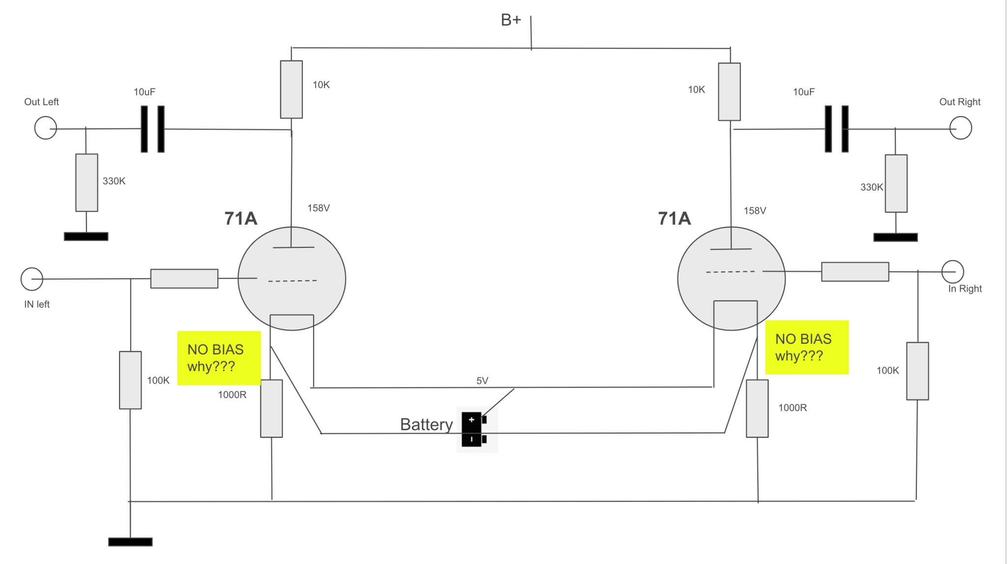

Hi guys, thanks for the continued input. Since the Aa has a plate resistance = 30K and mu=30 (recall, I don't need the amplification, I am after tone), I am going back to use a 71A (plate resistance = 1.8K). The attached is an update schematic.

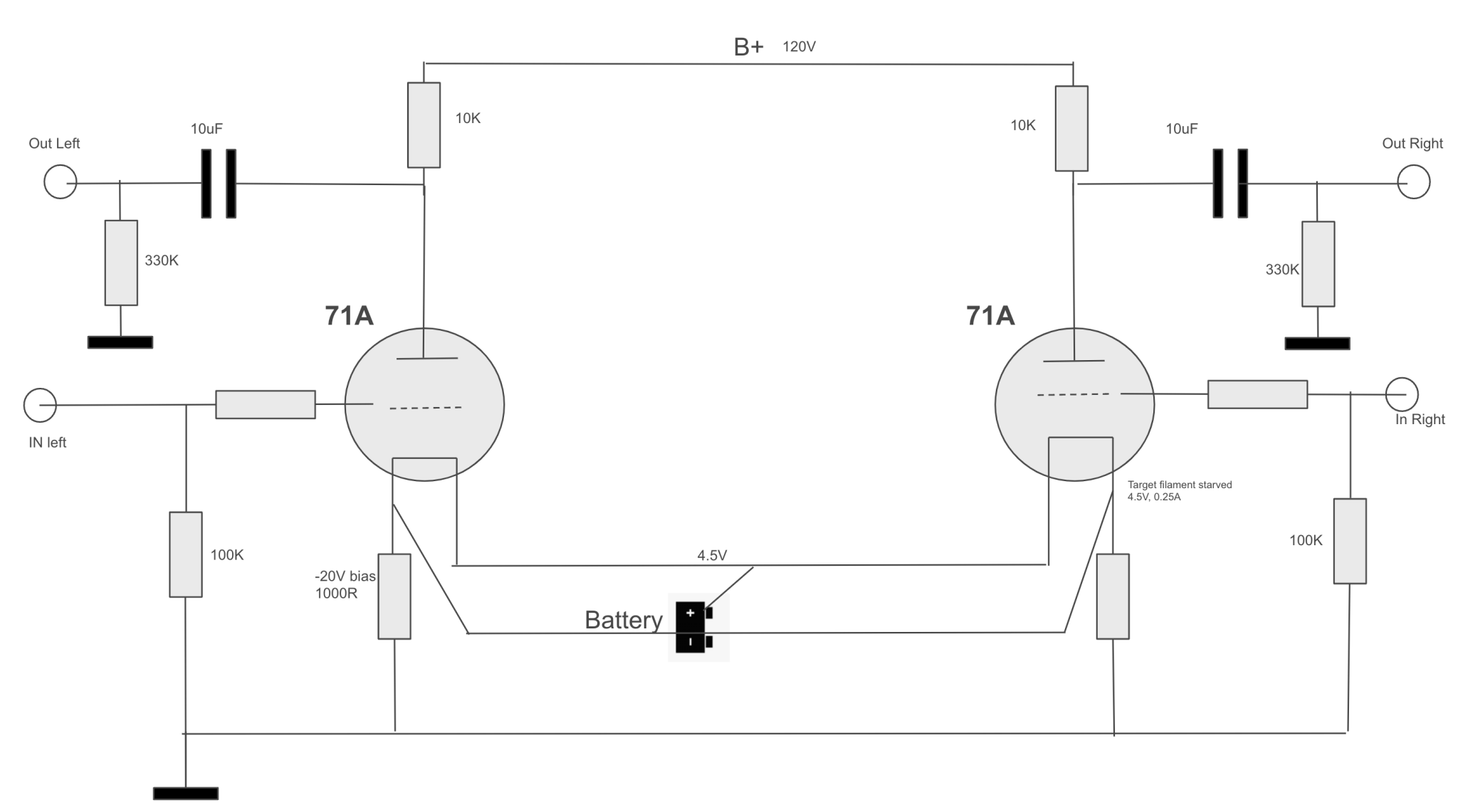

I am going to use 4.5V 0.25A for the filaments (starved). With 120V B+, I am aiming for -20V bias. Vbias = -20V = 20mA * 1000R. Sound right?

I feel that I missed something from the beginning. Firstly, you ask about a shared battery supply for the heaters. I never saw that answered, but I have used such a thing in my builds. Thread then goes from that to the amplifier design, which apparently is something that you are doing yourself? And if the heaters are 6 or 6.3 volts DC, then 5 volts may too low.
