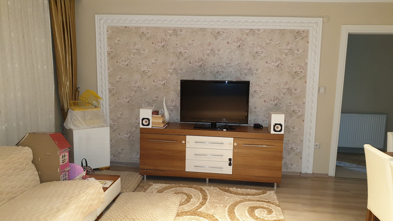

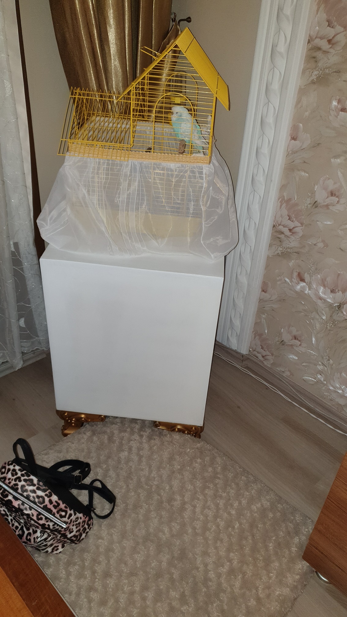

Hi.I already built a cube 100 liters decorative downfiring subwoofer on the left with SB34NRX75-6 and wanted to make same one at right of tv too.But wife did not accept it.We fighted with her about it.Only permits slim towers and dimensions are 25cm wide and 35cm deep and 105cm high max.Does not want wider tower..Finally we talked with her and she told she will only accept slim towers with white color.No other choices.Maybe i can keep the cube subwoofer working and make a dummy left tower and working right tower.But they will have different frequency responses.Or another option is putting different subwoofer into the cube sub and buy another SB34NRX75-6 and make 3 subwoofers.

I am puzzled: subwoofers don't have lefts and rights although it is clearly better to have two than one.
You can (and should) stick them anywhere in the room where they are beneficial. And while the jury is out on mixing the bass (my opinion reverses from time to time), if the XO freq is low, just doesn't matter where they are located.
So you could put your sub in a closet... if you remember to open the closet door when playing music with low freq content. Or maybe in another room.

Hi.Sorry i have sonic obsession (But i am getting normal day by day) and wifey has image obsession (plus cleaning obsession).Even i think am a handsome man and some girls like my face a lot ,she always wants to dress me good even at home sometimes and says it is much better when i am good dressed.And she does not want any other subwoofer anywhere,only slim towers accepted at living room.
My main goals are
1)having homogenous spl at living room because in the middle of carpet and near tv bass is very much and on sofa which i am sitting and listening to music it is very low.(with the 100liters sub box on the corner)
2) I will change crossover frequency of towers and make some experiments.(100Hz and 340Hz.I will make towers upside down at 340Hz) I will use active crossovers with OPA627 opamps I already built.

1] Sounds like you're sitting in one the room nulls [even order harmonic, with center of the room the biggest/deepest] instead of one of its peaks [odd order harmonic such as each end] like the stereo apparently is, but guessing SWMBO won't tolerate rearranging the room to improve the audio experience.
