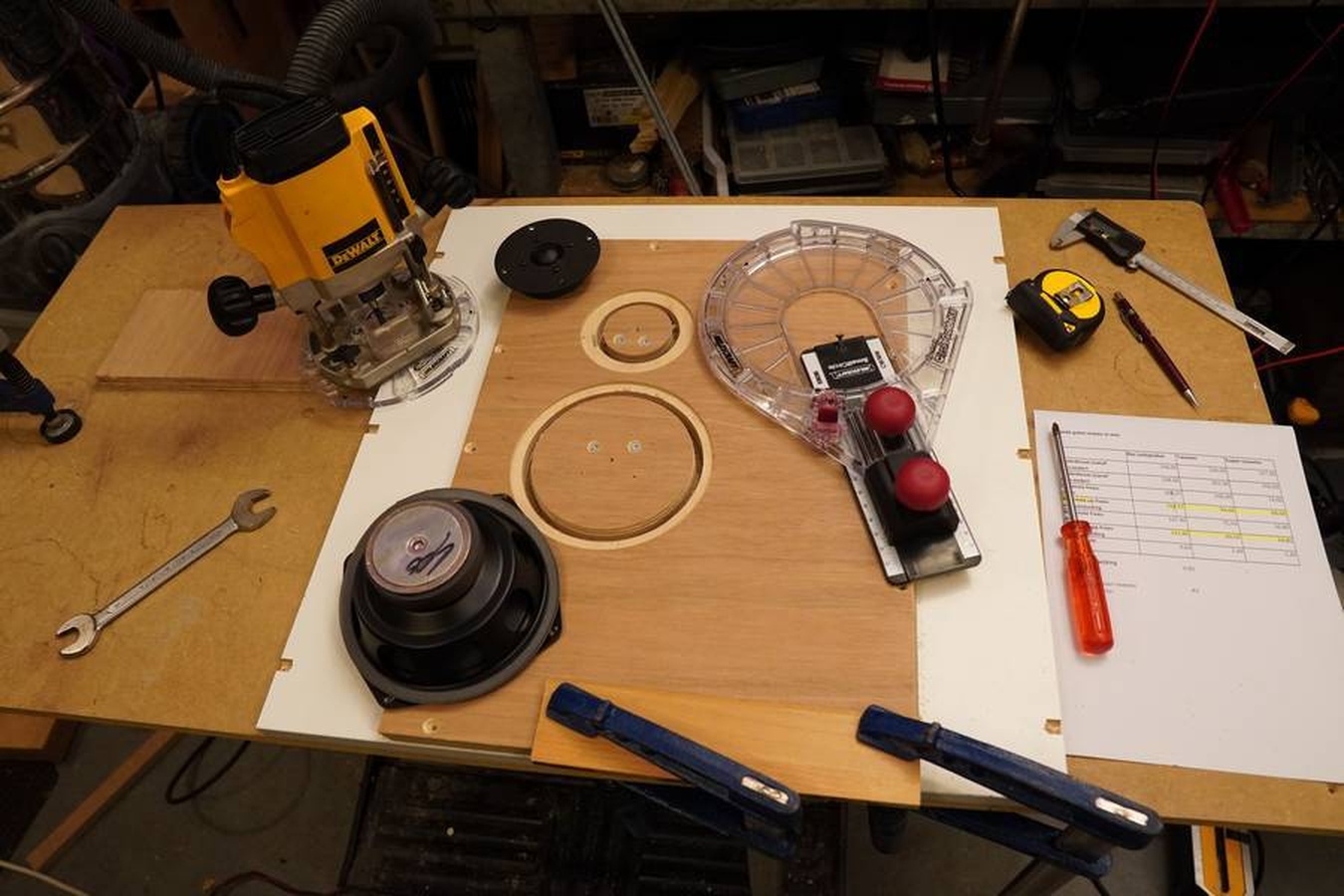

I made this topic to show my first home-made speakers. I came to this project because the form factor I had in mind can’t be bought. Since I didn’t have any experience with building speakers, I took a second-hand pair of my favourite speakers: the Hepta Gem. It’s a Dutch brand. I re-used the drivers, the crossover, the bass-pipe and the dampening material. And I could take it’s internal volume of 9 Litres as a reference.
Then I started drawing in the program Geometry Expressions. This is a frontal view and a cross section.
The speakers are 50 cm high, 35 cm wide and 7 to 16.3 cm deep. That’s about 20 inch high, 14 inch wide and 2.8 to 6.4 inch deep. The front is angled 15 degrees towards the listener, since I listen to them sitting very close to a wall behind my electric piano.
I used 1.8 cm (0.7 inch) thick multi-ply:
When trying out my speaker, it didn’t sound very well. It turned out the multi-ply was vibrating quite a lot. This could be fixed by adding some reinforcements and self-adhesive vibration dampening material:
Because of the 15-degree angle I couldn’t use clamps and ended up using 75 temporary screws for each speaker to tighten the glue joints. I later filled these holes:
The end result without the speaker-cloth was already quite to my liking:
For the speaker-cloth I made two wooden dodecagons (twelve-sided polygons) with a 45 degree angle on the sides.
The best way to attach the speaker-cloth turned out to make grooves with a multitool, fill these with glue and then push the speaker-cloth in the grooves. This way the speaker-cloth can be mounted without worrying the glue isn’t dry enough yet to hold the tension.
This is the end result.
