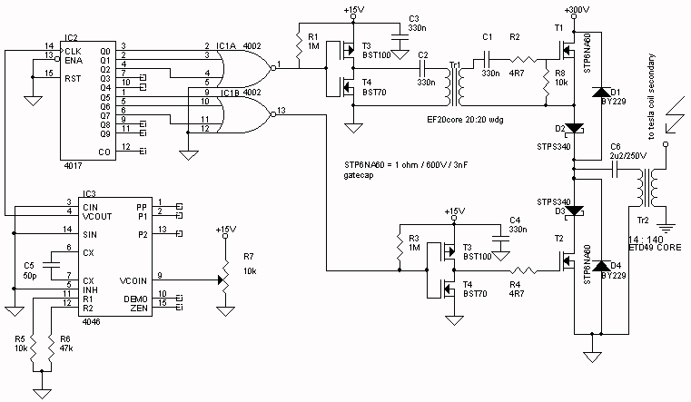

SG3525.pdf figure 11
Does anyone have a scope of that circuit: can SG drive driving ferrite itself and to give good square ???
Do I need mosfet driver like IR4427 ?
djQUAN said:
I mean for driving HALF bridge mosfts with ferrite!!!
What about this with two mosfets(N and P channel) for driving
