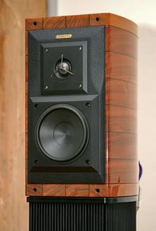

Hello,
Just got my hands on a lovely pair of SF Guarneri Homage. They are really good, so good they'll replace my much more modern and very costly Raidho speakers. The Homage may not have the same resolving power or deep bass but they still resolve just right and bass is tighter though half octave less or so. Otherwise the beat the Raidho with great margin.
I am thinking if some mods could be done BUT they should be of the art so they could be reverted to original.

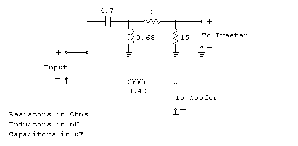

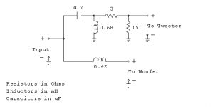

It seems to be a 6" polycone bass and metal tweeter. A fairly classic combination:
Vifa 2-Way Loudspeaker System
I think you need to delve into the crossover to see what might be done. I doubt it's a bad design.

Well digging into the x-over for function/spec testing each component is the only way to go of course. The x-over is in no doubt an excellent construction my concern was about components that could be affected by time (15 years) like caps.

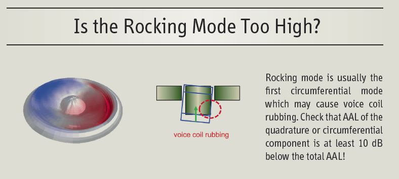

What happens with a little 6" bass at high volume is it goes into breakup and non-linearity due to excessive movement and bass outside the magnet gap. It can get ugly:

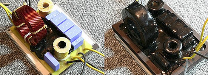

The crossover looks impossible to disassemble. But obviously competent and second order, or higher. Capacitors are plastic film, so shouldn't deteriorate.
So not much to do with that one! Polish it? 😀
