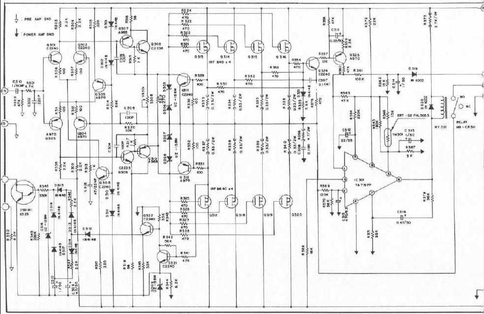

Hi, here I have a schematic that is identical as far as I've checked.
I also have included the bias procedure (it references the wrong resistor numbers, but I've figured that out). So from what I understand, when I turn up the bias, I want all the voltages measured across all the power resistors to be roughly equal (that will satisfy the equation given).
My problem is that the first N FET and the last P FET consistently are way higher than the others. So when I turn up the bias so that the first N FET is 10mV, the last P FET will be ~8mV and everything else is ~1mV or less. The procedure tells me to replace those FETs with a higher reading, but I've done that a couple of times with the same results. What else could be causing this?
The amp is working right now, but in this state I will get massive distortion if I crank it up, correct?

If the schematic is correst, as far as i can tell, this amp has no bias thermal compensation, considering it is using vertical MOSFETs, this is at least a design flaw, and at worst criminaly irresponsible. The bias current will increase as the temerature rises, and looking at the datasheet fior the IRF devices, it may even be fatal.
Secondly, are all your FETs the same manufacturer? At the very least, all the 640s and all all the 9640 should be the same manufacturer. Thirdly, have you checked that all the 0.33 ohm resistors are actually still 0.33 ohm, and not open circuit? (that 0.1mV across one of them is very suspicious).
