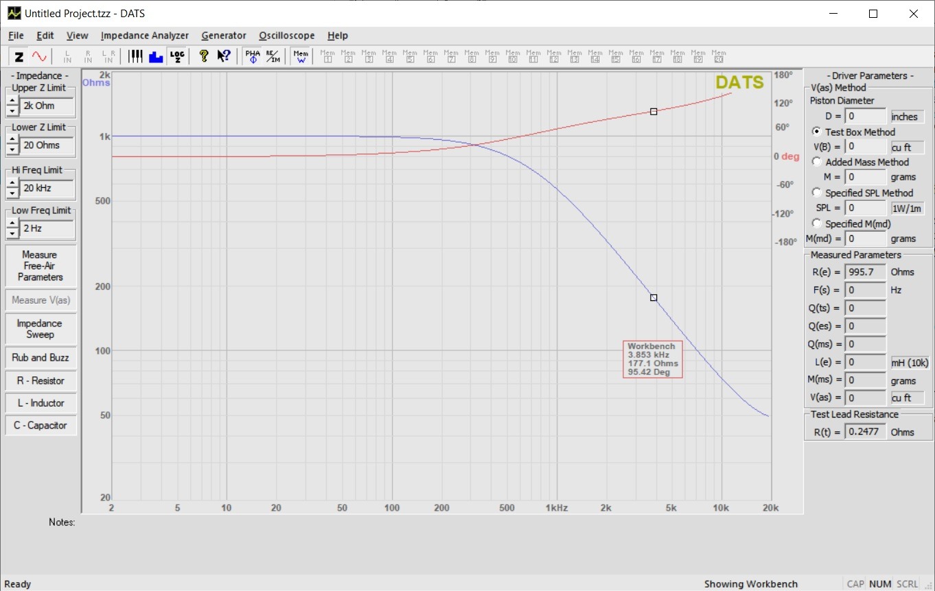

I tried installing the 3.16 software. Now, I'm I'm at least getting roughly sane test lead measurement results, but I'm getting some erratic measurements of resistors.
From the DATS Help menu:
Impedance Analyzer Menu
I'm getting 0.2477 Ohms, so I think that's probably okay.
But when I measure a 997 Ohm test resistor, I get this graph:
Should the results be linear straight across the graph?
