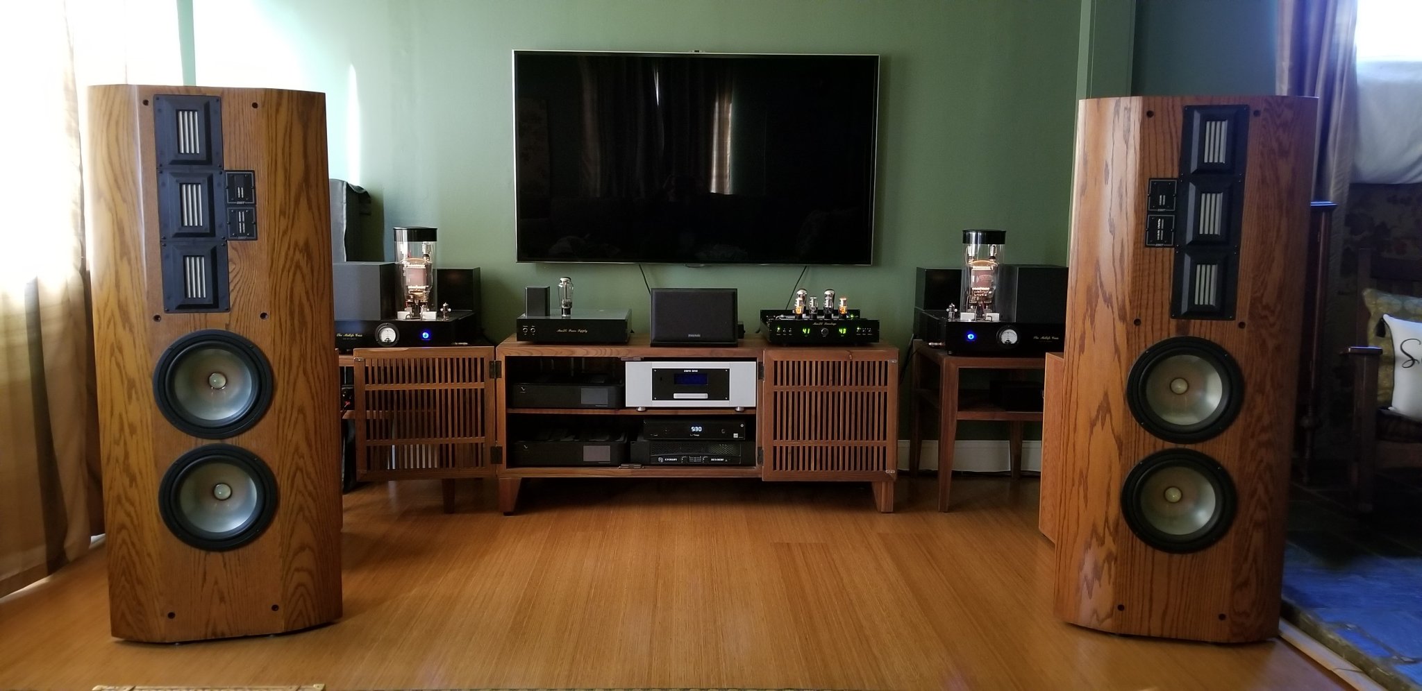

Well, in my experience it's nice to have brute power output in an SET because that allows one to trade some voltage swing for driving current using a stepdown autoformer such as the Spelz Zero. Of course, overbuilt amp power supplies are a must.
Personally, I drive Infinity RSIIb speakers with my 200WPC SET in this manner. The addition of the Speltz in 4:1 step-down really gave the amps a hammer lock on the speaker drivers. A solution worth trying if you have power to spare.
