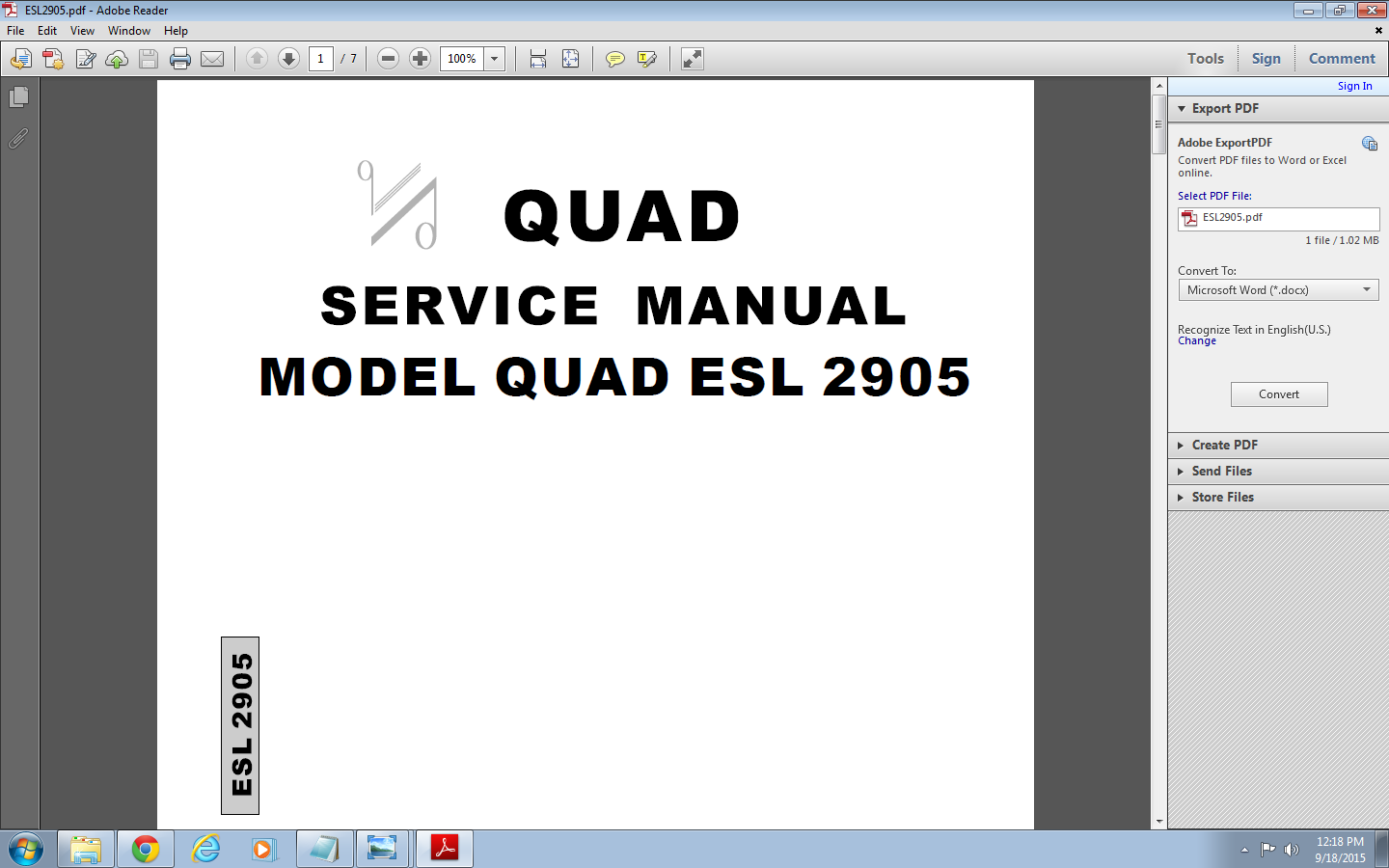

Hello Hennyo,
I also need a Service Manual for ESL-2905, there is heard a chirping sound at 2/3 of a height without any signal.
Maybe punching high voltage, damaged diafragma?!
Thnx in advance
Regards.
Robert

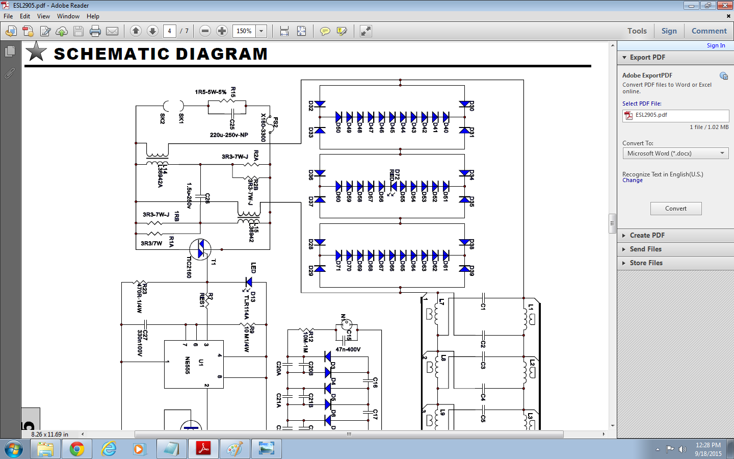

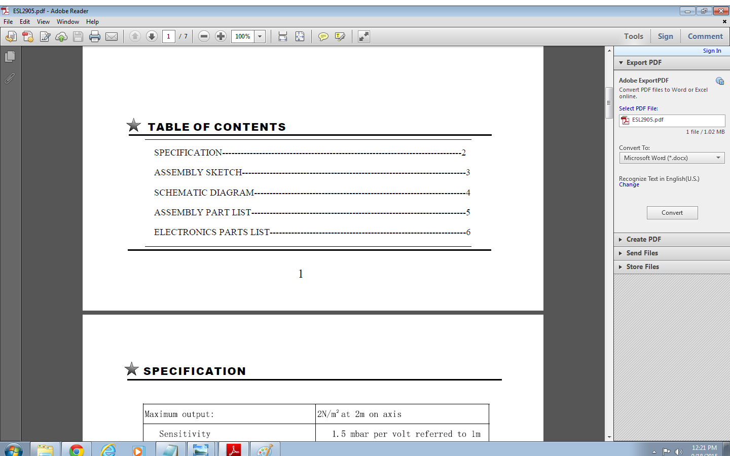

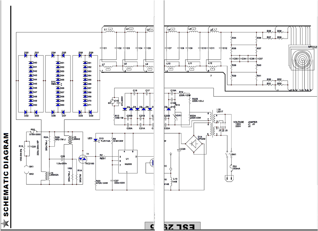

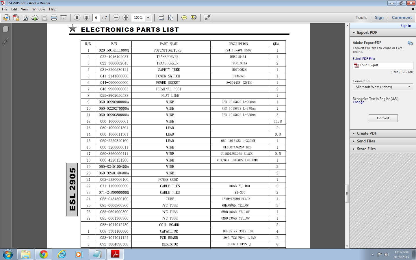

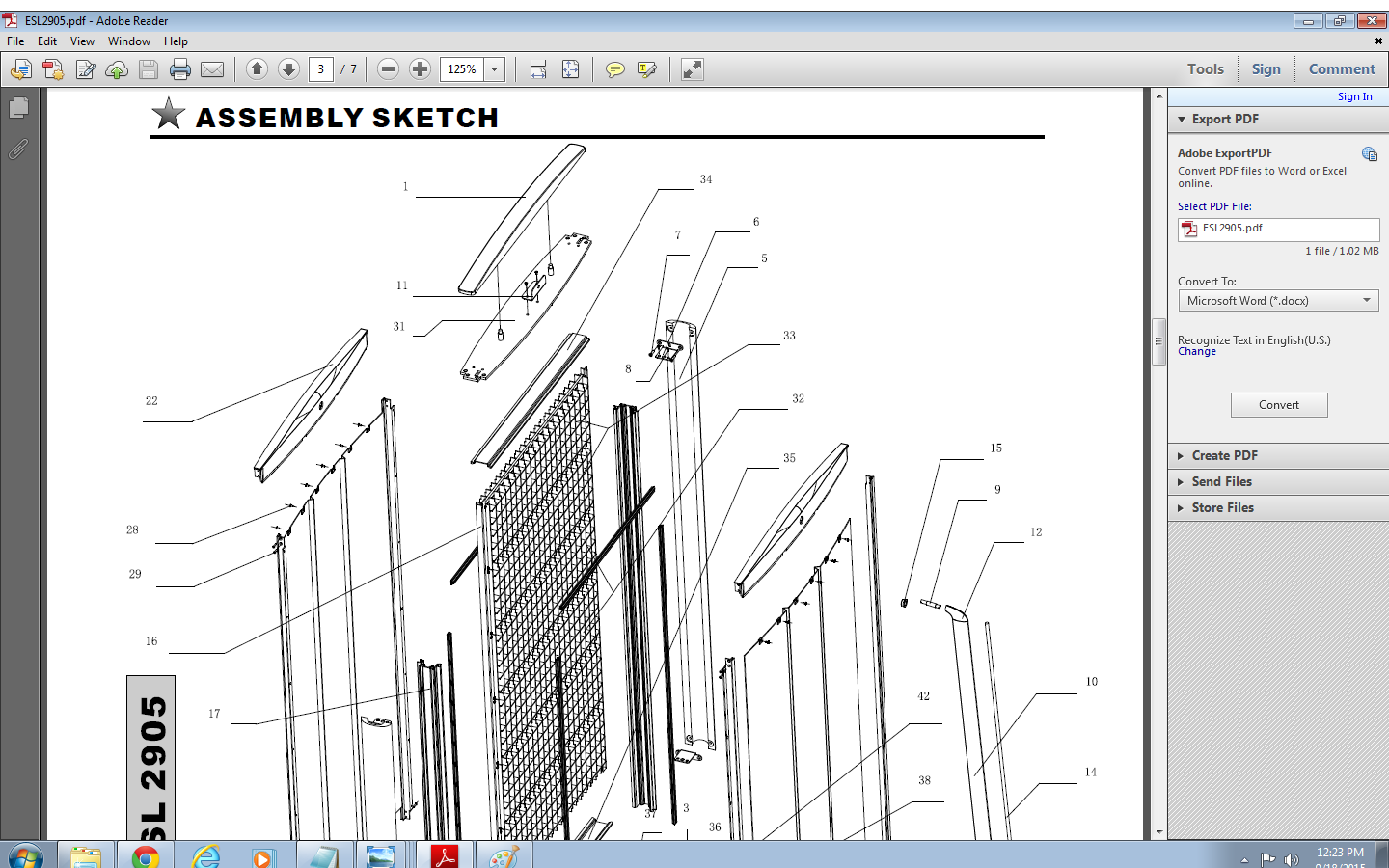

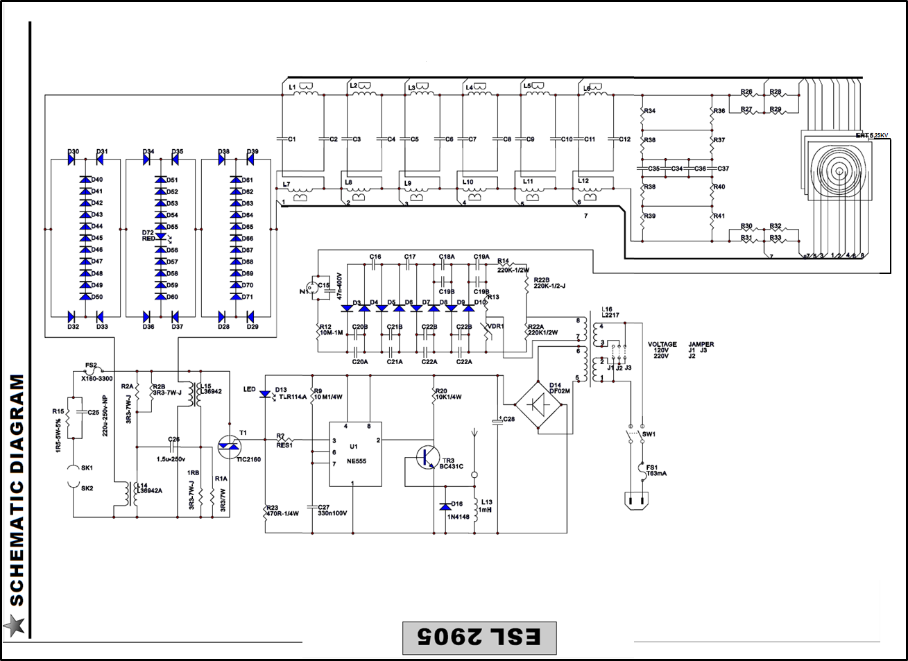

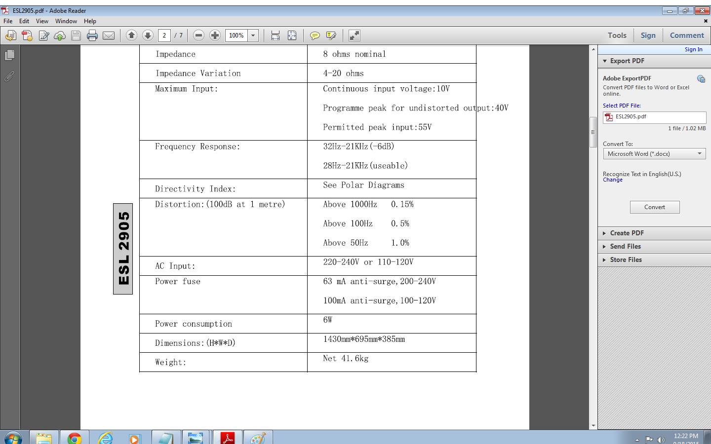

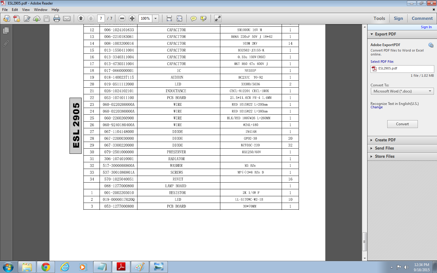

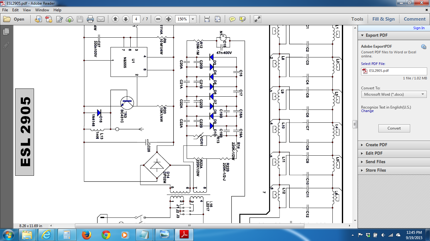

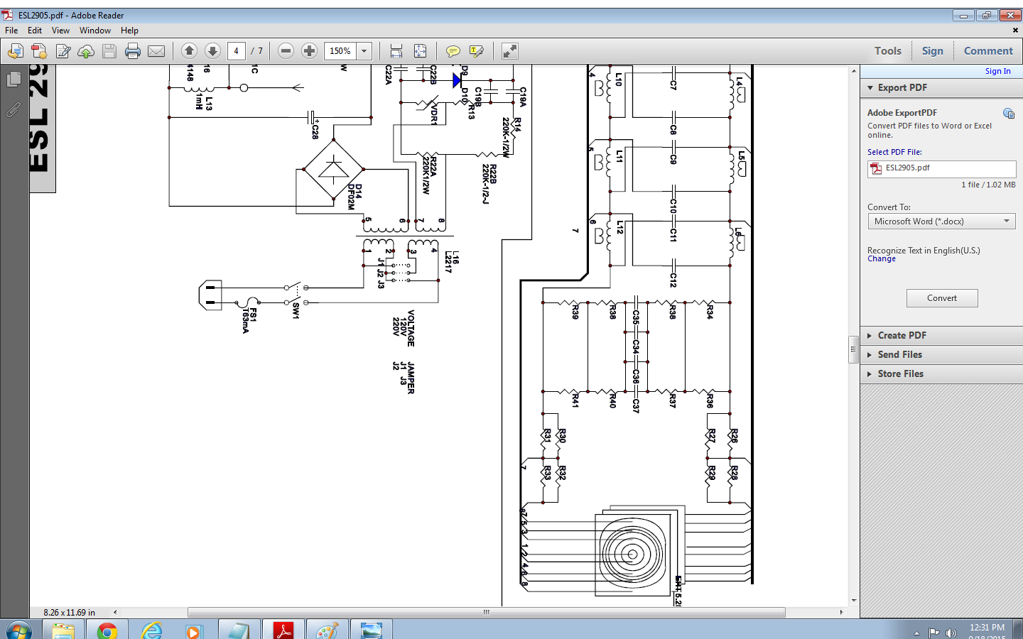

Thanks for sharing the ESL2905 screen shots. 🙂...Thought I'd go for sharing a pdf link, but turns out I'll share the screenshots.. Somebody else can piece them together/convert to pdf.
It looks like we are missing about a 1" wide section of the middle portion of the schematic.
If you can post that, I'll stitch the pieces together and post as one image.
ESL 29/805 Service Manual

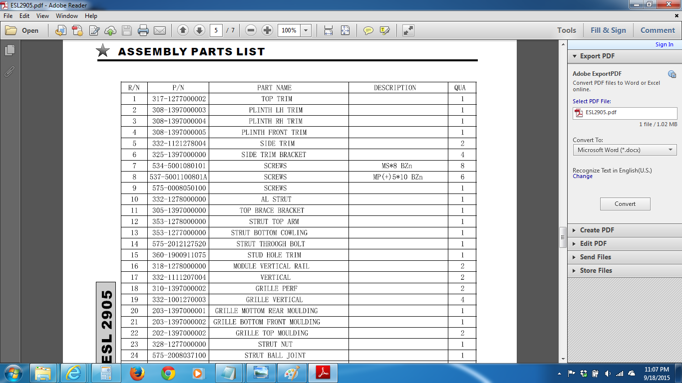

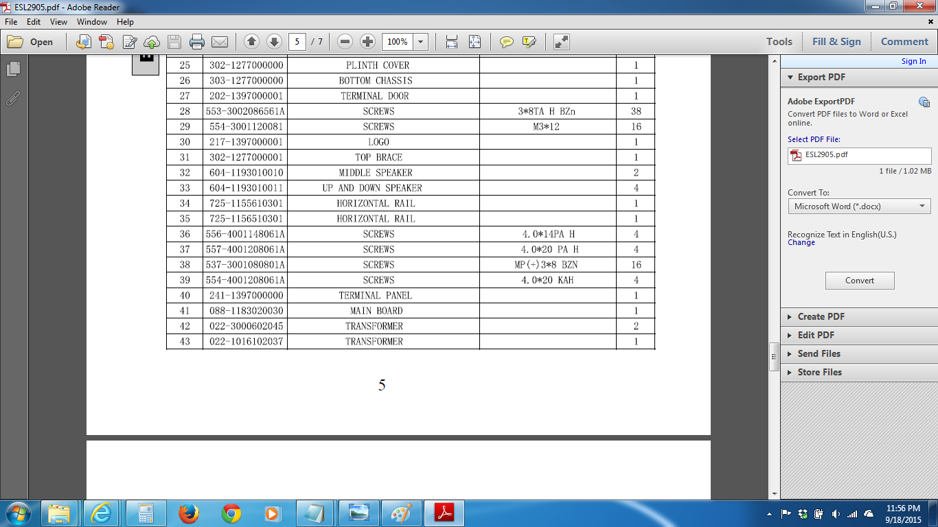

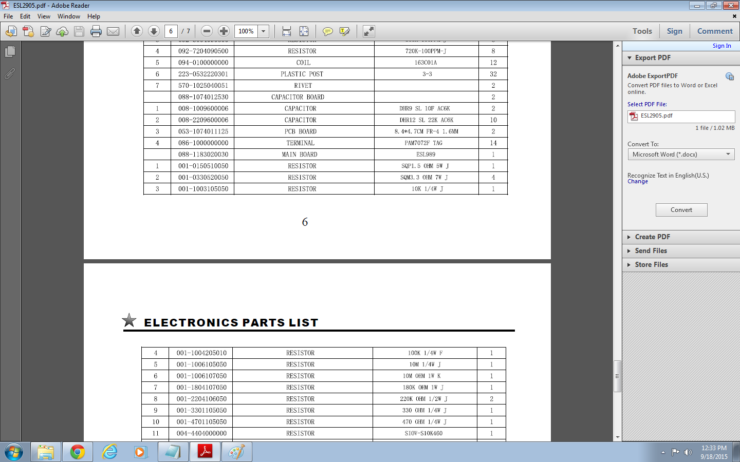

I skimmed through it and omitted the "assembly parts" list; ordered after the electrical schematic. Thanks bolserst.

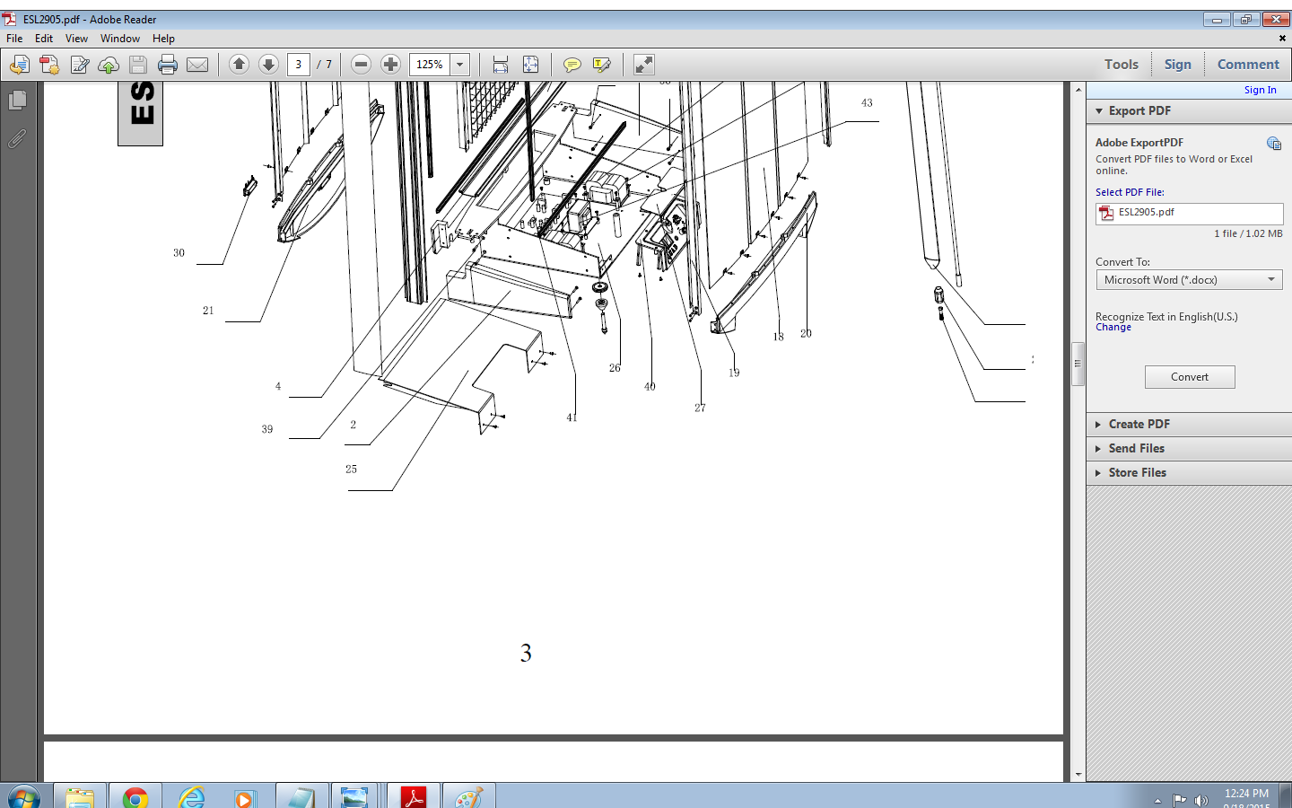

The unlabled "1' wide portion" -in exploded schematic- ...is very much what Quad apparently circulates: this pdf also affected their new American distributor; A bit obnoxious? [The UNLISTED locking collar/securing bracket is also confounding; why Screenshots were attached to facilitate liaison/procurement] Guess it would be great if I labeled the parts. 🙁
Particularly as/when the No. 14:13 conjugation bits (steel rod/"Strut through bolt" conjoin cowling/tensioning apparatus) are some of the most likely parts to 'break' (or emasculate) by presumably developing thread/tap meld/conjoining degredation.
So Suffice You really don't want to touch/or bump that Alu Strut/steel rod and bend it beyond modulus. To do this often spells bad news for No. 24, the 'Strut Ball Joint.'
In mine, for example the extrusion (No. 10 - AL Strut) is robustly -comparatively- fine; the rod (and by extension No.13 cowling) not so much. My particular "cowling to Strut Ball Joint" mate subsequently/coterminously is also affected just enough to mind.
If that's rather dull I err, share your compunction.. Attempting to be helpful, diplomatic..

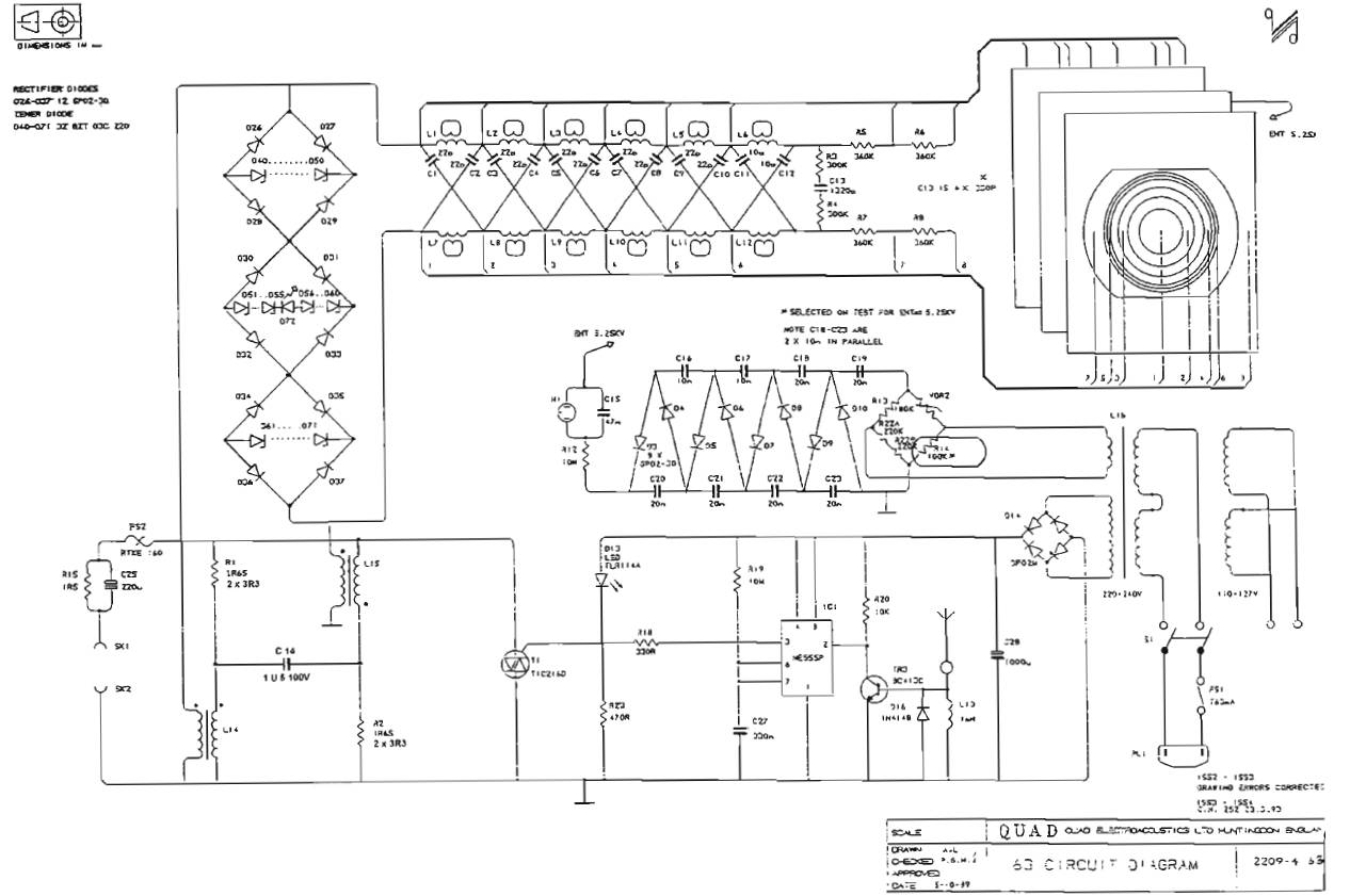

Huh...circuit-wise, it looks to be identical to the last iteration of the ESL-63.
I thought I had read that the protection circuitry was slightly different on the 2805/2905.
Does anybody see any differences?
