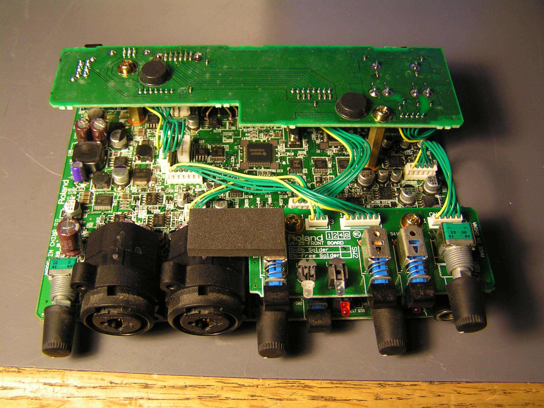

Using an FPGA does not have to be expensive. The Edirol FA66 is a good example of a very good cheap DAC based on such.

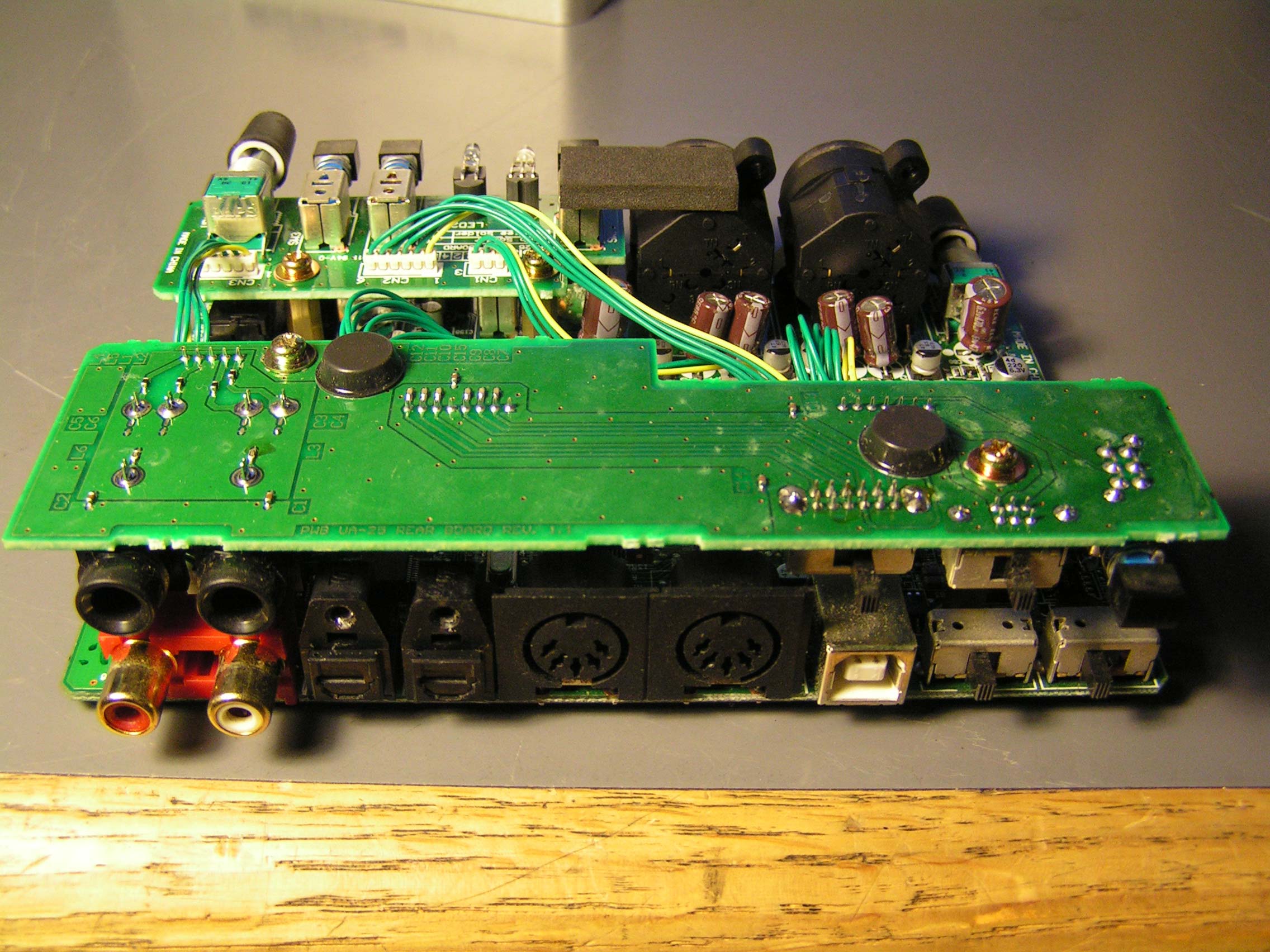

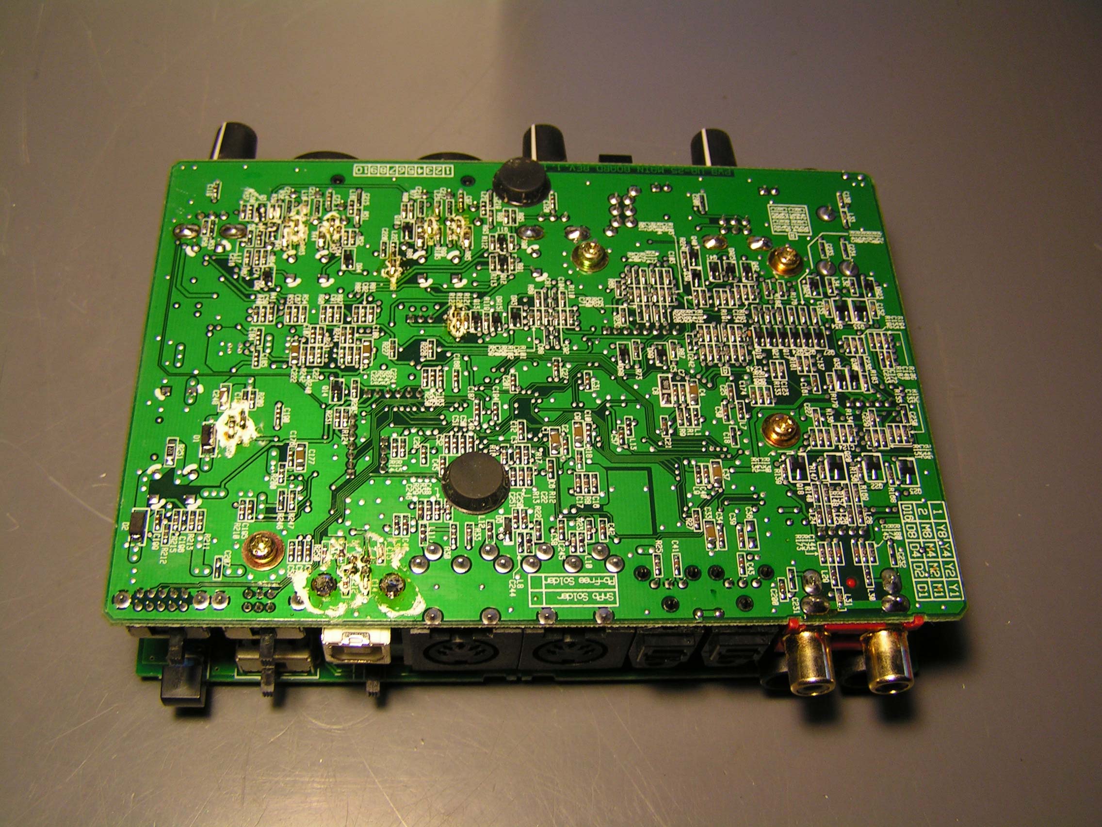

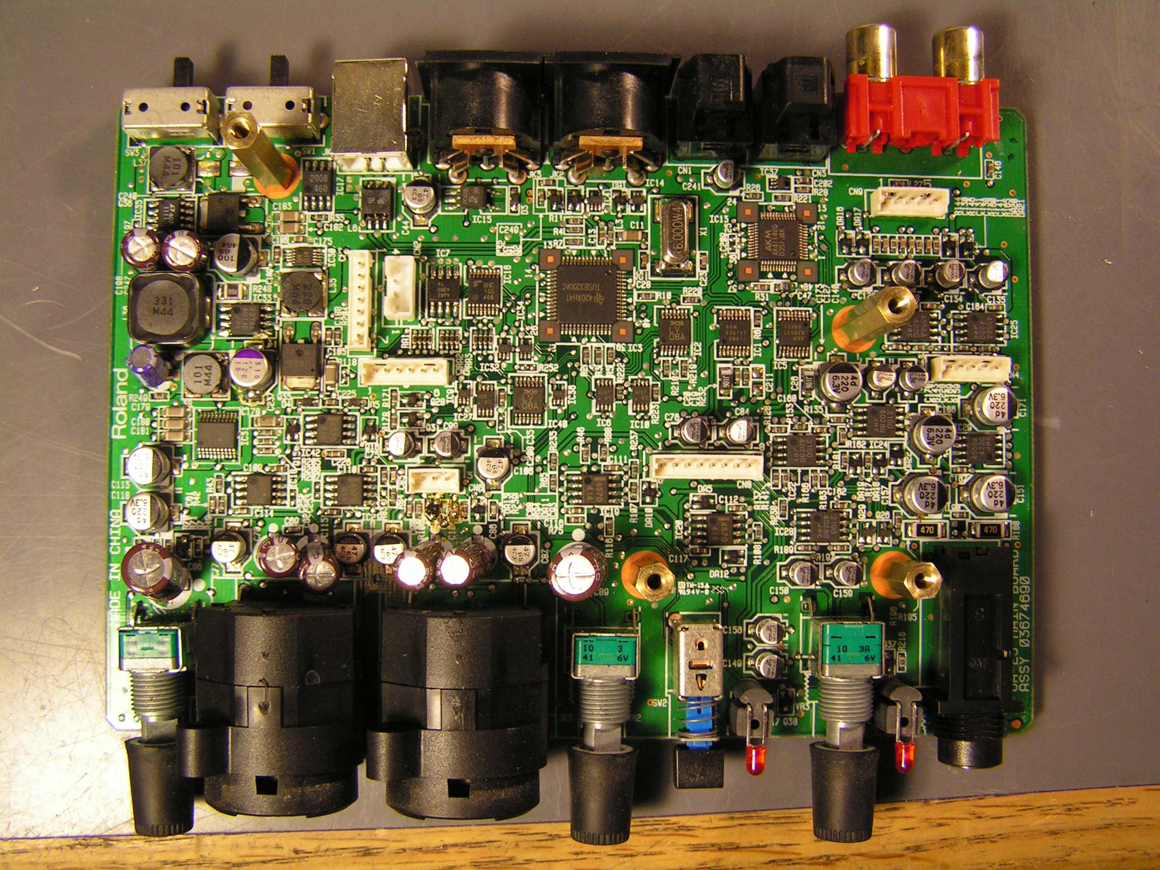

Doesn't the FA66 use an AKM4385?
My tech says the FA-66 i have has no DAC chip.
I have pictures of the inside if you want to do a check to see if that is right.
dave
Dave, a look at the chips involved (unless their markings are gone) would go a long ways to closing that loop. (I have no dog in the fight!)
There's at least one AKM chip on there (which could easily be the ADC), although I'm having a devil of a time reading much more. Thanks for getting those, Dave.
AK4114? A 192/24 digital audio interface transceiver.
