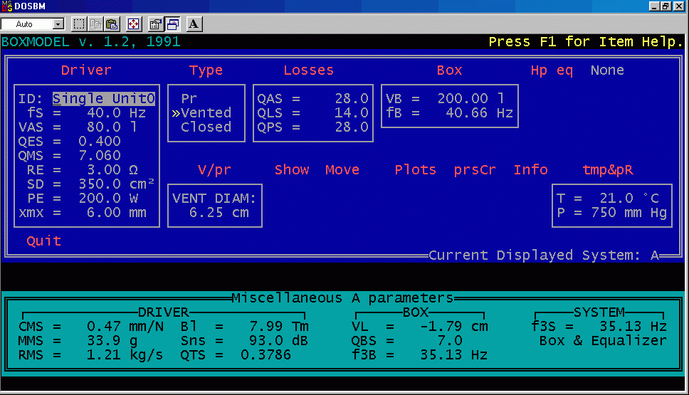

Erwin:
Let's try this a different way.
Let's compare a ten inch single unit speaker to a series unit speaker, as if the two speakers in series are one speaker.
To do this, we use Bullock and White's Dos BoxModel, where the user inputs certain speaker parameters in the dark blue area illustrated below, and the aqua green area shows the calculated values. One of these calculated values is sensitivity per watt-not per 2.83 volts.
Forget the box section for now-we are just dealing with the driver.
Bullock and White's program, available here is very useful in this respect. Note: Ignore the TL program-they admit that it was an experiment which failed. But the Dos BoxModel for closed, vented, and PR is just fine.
We take a typical 10 inch speaker with a sensitivity of 93 dB per watt, and fill in typical Thiele-Small values for it below:
Now, in order to combine two speakers into one, we change three things:
We double the Re - It goes from 3.0 ohms to 6.0 ohms.
We double Sd, the Cone Area. It goes from 350 sq cm, (56 sq inches) to 700 sq cm, (112 sq inches).
We double the Vas. Everyone knows you must double the box volume when you add another speaker to get the same response. So Vas goes from 80 L, (2.8 cu ft), to 160 L, (5.7 cu ft).
What happens when we do this? We find our sensitivity per watt jumps from 93 dB to 96 dB.
Of course, since our 8 ohm somposite spekaer is an 8 ohmer, it will get only hald the power delivered to it that the 4 ohm single speaker will, so the SPL [per 2.83 Volts will equal the 4 ohm speaker. Even though it is only drawing half the power. Because the the 8 ohm composite speaker is 3 db more sensitive per watt.

One interesting thing I never realized until now. When we combine the two speakers together, and therefore double Re, Sd (Cone Area), and Vas, the the calculated BL rating also doubles from 7.99 to 15.99.
Makes sense. When we combine two speakers, we are also combining two voice coil and magnet systems as well.
