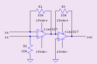

Please see/find my enclosed file for the schematic.
I want to build my own analog stage for my minidisc player (which I use as a DAC.)
The DAC has 2 outputs per channel, therefore I want to have a differential buffer and then a gain stage.
I am no EE and barely know how these opamps work so I copy designs and put them together
Will my design work? Any thoughts on the design are appreciated (Except op-amp fetishes) It uses the TLE2027AI opamp. The only thing I don't want to change with this design
is the opamp. Cause I have a couple of them lying around 🙂
Bas Horneman.
For starters......
The inverting input is a virtual ground. The non-inverting is 10K. You would need to put 10K in series with the inverting input to make it the same.
I assume your DAC is a voltage-out type since it has 2 outputs.
