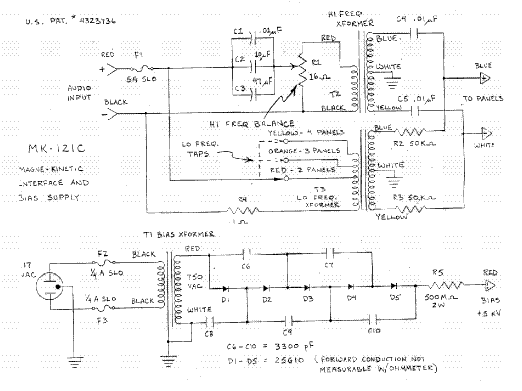

Was just thinking.....is it possible or even desirable to physically isolate the bias voltage circuit from the audio circuit in an Acoustat Servo amp and go with two enclosures?
Man i did like the sound of the old Acoustat X...even if it was a littel dark sounding...But thay were in a box an canted back....the frist Acoustat i owned back in the 80s... I would not deal with the Sevos i would just add a bias an leve the SevoAmps stock or as thay are...have fun an goodluck
I intend to do this my self, my reason is to keep the panals charged. In the Interface design, the bias has nothing to do with the passive transformers. Based on this, I assume it will work just fine. How ere you going to build the power supply?
Thanks, guys. I'm eventually going to do a full rebuild of the Servos using Analogue Associates parts. I was thinking about getting/making new circuit boards, which then got me wondering if there is any advantage to keeping the two portions apart.
I am not sure if there would be in benefit to separating them ,unless the bias voltage is common to the amplifier plate supplies.

The plate supply and diaphragm bias are fed from the same supply, as there is only one high-voltage transformer. Making the two supplies seperate might offer some sonic benefit, plus having the diaphragm bias as a seperate supply does offer the highly advantageous benefit of allowing the panels to remain charged even when the amplifier is in the 'sleep' mode.
The circuit shown above for the MK-121 bias supply should work well. I do see the 750-VAC Acoustat bias transformer for sale on eBay occassionally, and possible other sellers. Part number is TTA-117 for the 110/120 VAC input model. Other transformers with different output voltage could be used by adjusting the number of stages in the voltage multiplier (within reason, of course). So nice to see a schematic that I drew so many years ago, still getting good use. Who knew?
