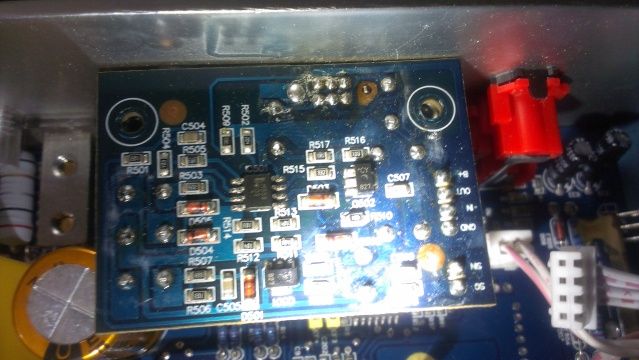

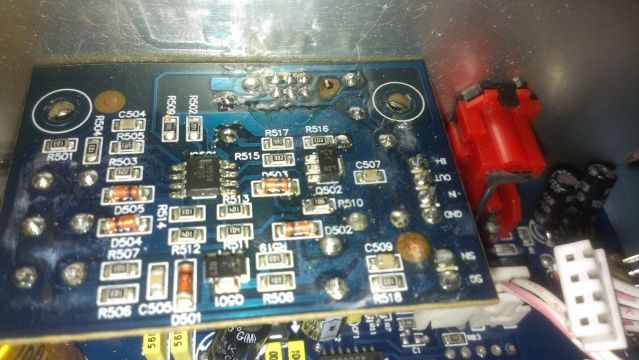

This was the issue!! An unintentional solder bridge at the auto/rem switch. 🙂 You can see the six pins near the top of the picture with the two lower left jumped, they are directly shorted. I reassembled and tested after cutting the bridge.
