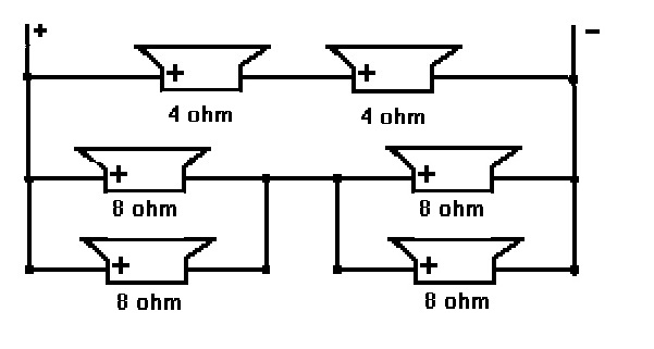

I have several drivers, both 4 and 8 ohms of 82 dB sensitivity, to use together.
If, for example, we use four 8 ohm and two 4 ohm together in series/parallel,
will the 4 ohm drivers play louder than the 8 ohms?

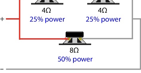

I looked up " power sharing" and saw the distribution of amplifier power (but determining the sensitivity/output level are still uncertain).

so do the 4 ohm drivers receive more (or less) power than the 8 ohm drivers in the above diagram, and by how much? (I saw a few examples circuits on the power sharing webpage, but none resembling my array).

so do the 4 ohm drivers receive more (or less) power than the 8 ohm drivers in the above diagram, and by how much? .
Just simplify and look at them as plain resistors with a DC voltage across the lot of them and then it's a simple case of working out the V^2 / R (i.e. the power) on individual drivers (resistors) to work out the share of power.
In this example it's very easy to visualise this without the use of a calculator.

2.83V@1M is the equiv of 1W@1M - for an 8 ohm load
For a 4 ohm load that 2.83V would produce 2W, so you need to reduce the sensitivity by 3dB to get the same
Power is V^2/R so 2.83^2 =8V, divided by the load (8ohm) = 1W
If you plug 4 ohm load into the calculation that spec produces 8/4 = 2W
If both 4 and 8 ohm drivers are essentially the same model, than the correct "sensitivity" is 82 dB/1W/1m for both models, or 82 dB/2.83V/1m for the 8 ohm driver and 85 dB/2.83V/1m for the 4 ohm driver.
Power distribution per schematic in your post #1:
Each 4-ohm driver get 25% of amplifier power, each 8-ohm driver get 12.5% of amplifier power.
Sensitivity of two 4-ohm drivers in series = 85 dB/2.83V/1m.
Sensitivity of parallel/series combination of four 8-ohm drivers = 88 dB/2.83V/1m.
