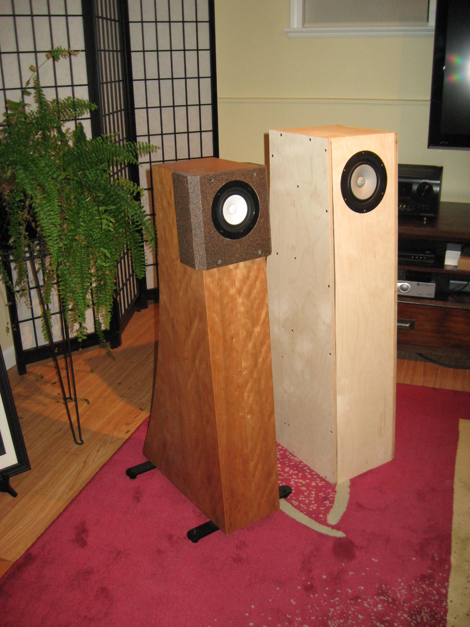

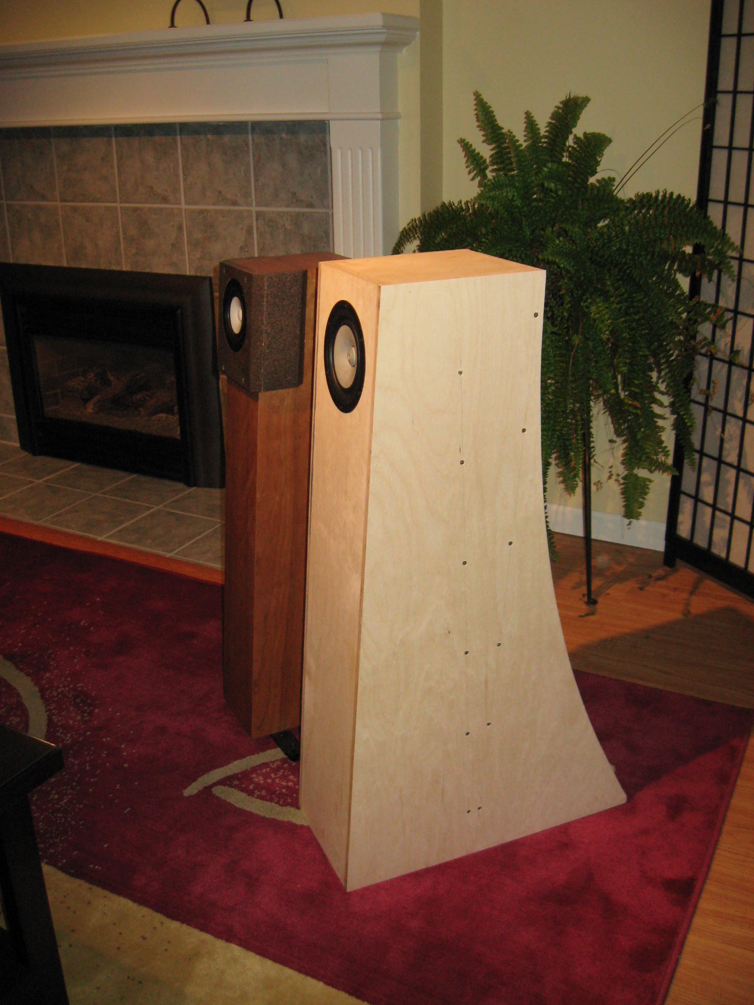

Depends on the driver, and to a lesser degree placement in the room but the FH3 was intended for the smaller size class of 3-4" - my personal favorite so far has been a very special version of the Alpair7 - MAOP7. I'm not aware of any in room frequency response measurements of the FH3 / 7.3, but my guess would be mid to low 40s
If you want higher sensitivity and bass extension with your KT120 SE, you should consider the larger FHXL enclosure and either of the Alpair 10s, or even FF165WK - the latter I've not heard yet, but there's no reason it shouldn't work - all of them would dig deeper than the 7s.
To give a sense of scale, below is FH3 with the white coned MAOP7, and initial unfinished prototype of FHXL with A10P
