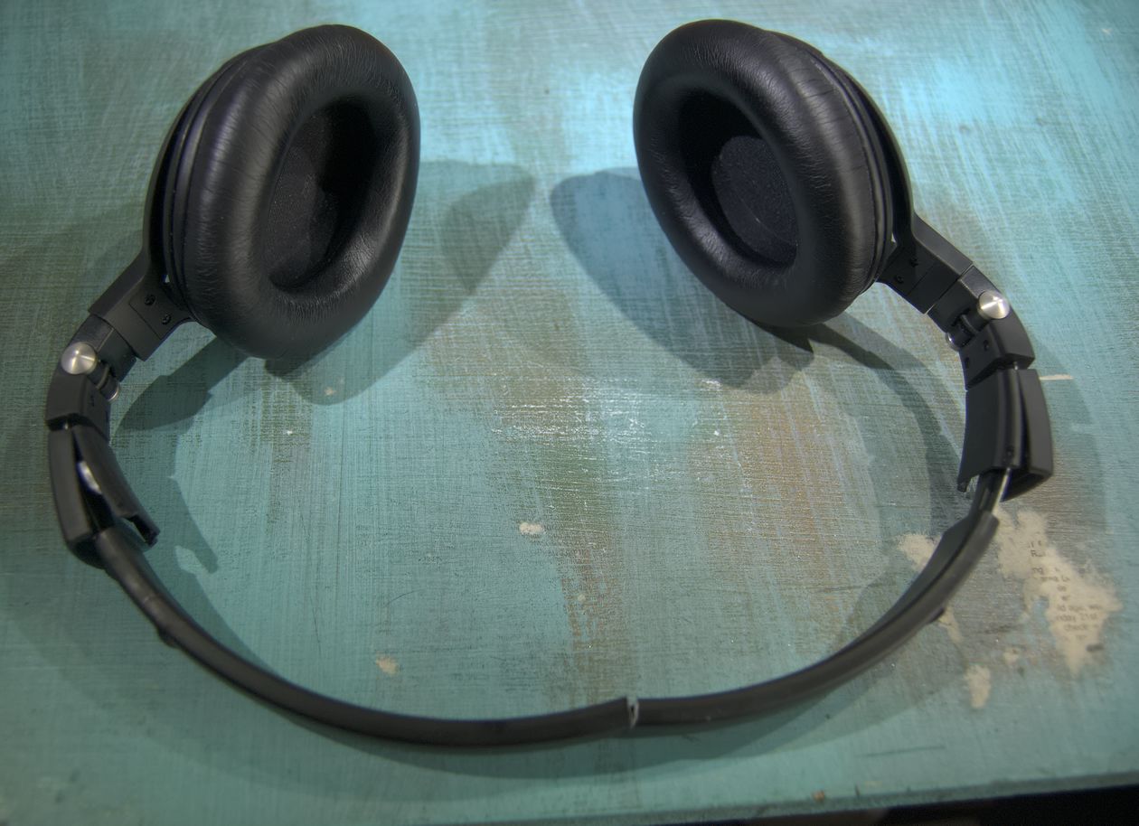

The headband of my Sennheiser MM 500-X headphones broke recently (because of course an expensive pair of headphones is made of cheap plastic), and thought it might be useful for other people to see how I fixed them.
The first of the attached photos shows the break, right in the middle. There are three pieces to the headband - one on top that spans the full length, and two peices that cover only half the length underneath. Because those two peices are joined in the middle, stress is concentrated on the upper piece.

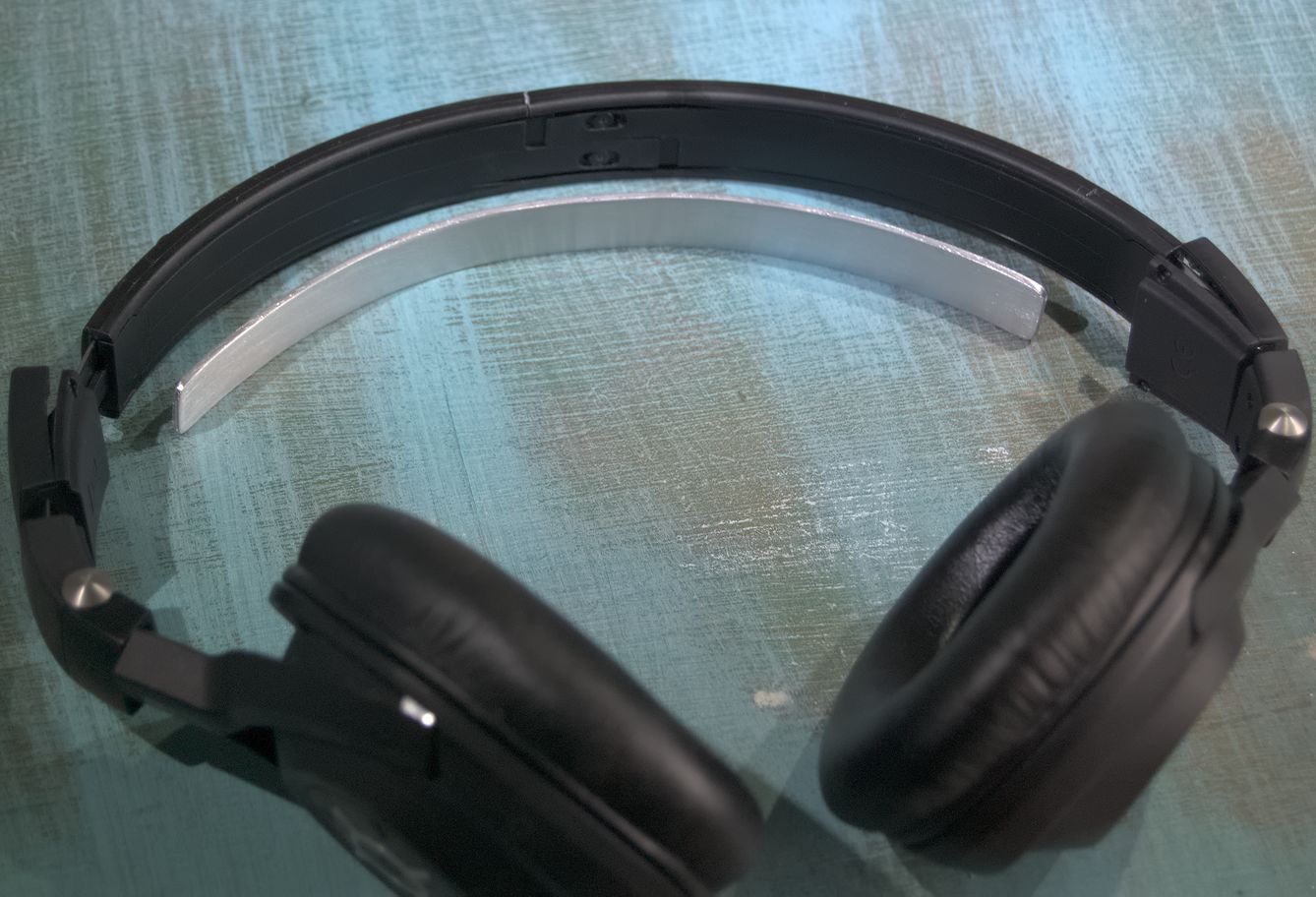

The second photo shows the strip of aluminium I cut and bent to support the headband. A bit of spring steel would have been better (and is what the headband should have been made of in the first place), but I didn't have any spare, and aluminium is much easier to cut anyway.

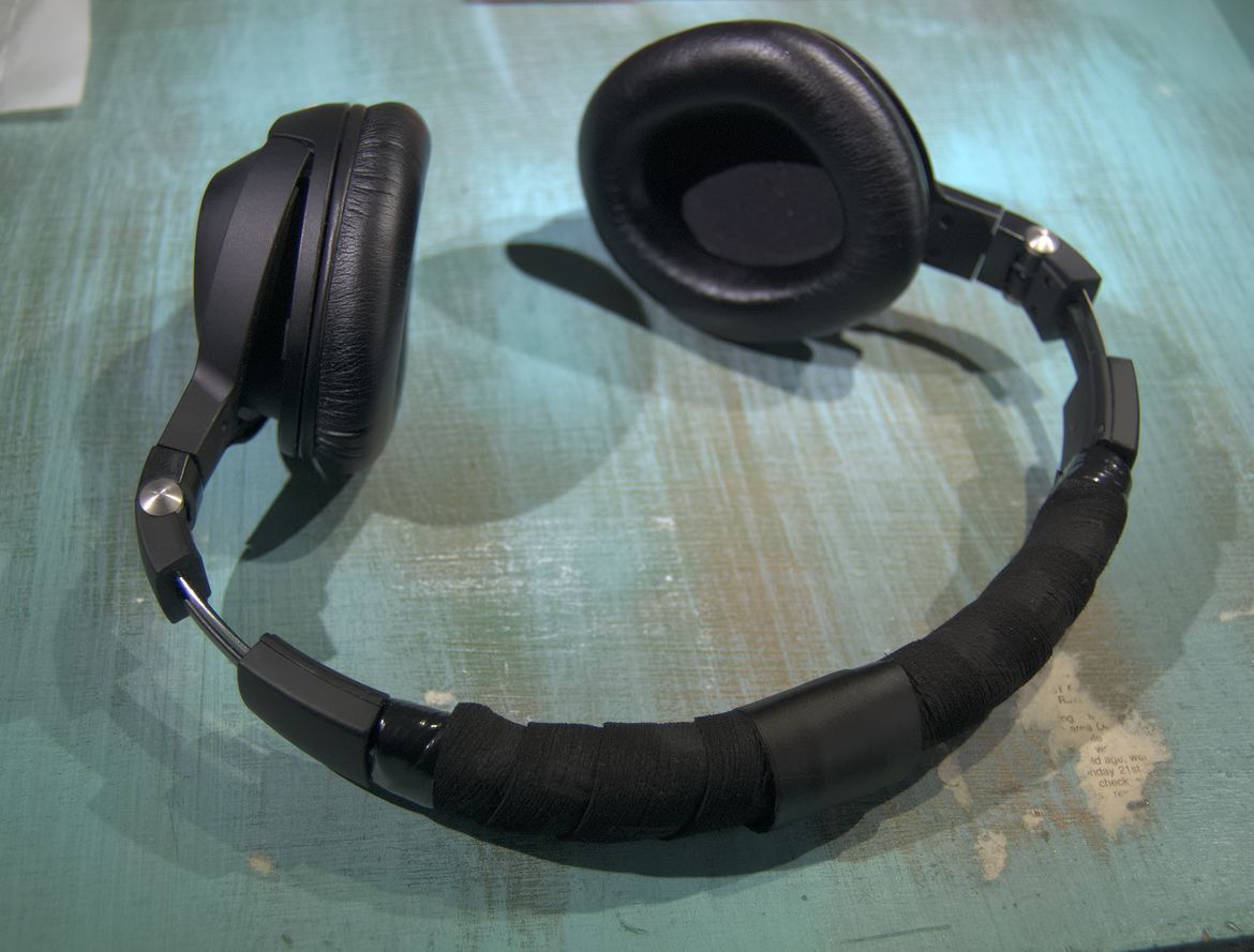

I used some duct tape to attach it to the broken headband, then covered it with a couple of scraps of bicycle handlebar tape to replace the original padding that I had to cut off to make the repair.
