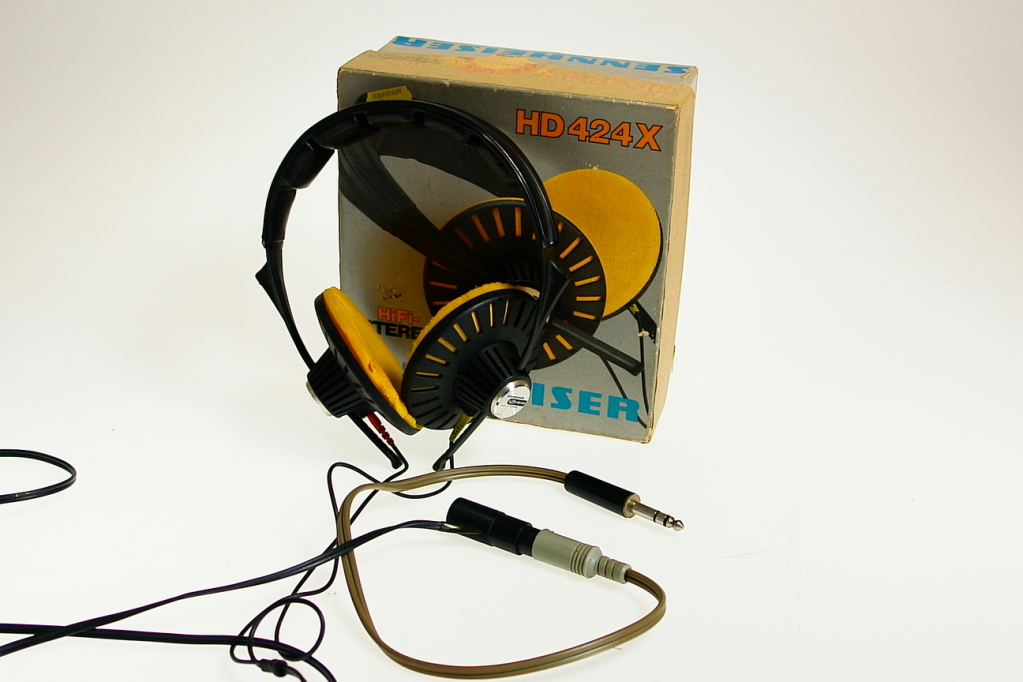

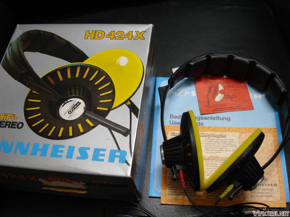

How do I know at used offers (e. g. from ebay) whether it is a 1700 ohms version (I don't want a 600 ohm version)?
Sennheiser inform me by phone, that the impedance for the "HD424-X" (HD-424X) is 2000 ohms/each system (produced in the 70s) and for the "HD424" 600 ohms/each system (start production: 1976).It has metal endcaps on the driver housings, as seen on your pictures. The newer 600 ohm versions are all-plastic.
If one have the "X" version, this isn't identify by the metal endcaps - only in the owner's manual and on the package.
by this link and in the attachment there are additional pics

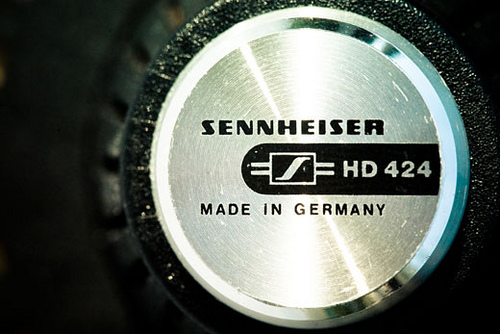

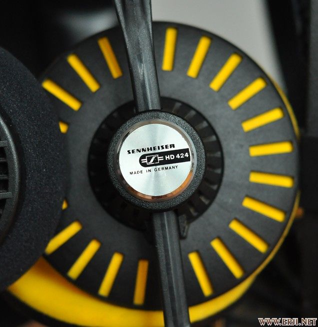

I think that I have heard somewhere sometime that 424 use Alnico magnets. The shape of drivers suggest that too. Is it true?
I have HD424X (with metal endcaps) in pristine condition and these are my favorite headphones.
Apparently the drivers in 2 kOhm HD424s and HD414s are identical.
