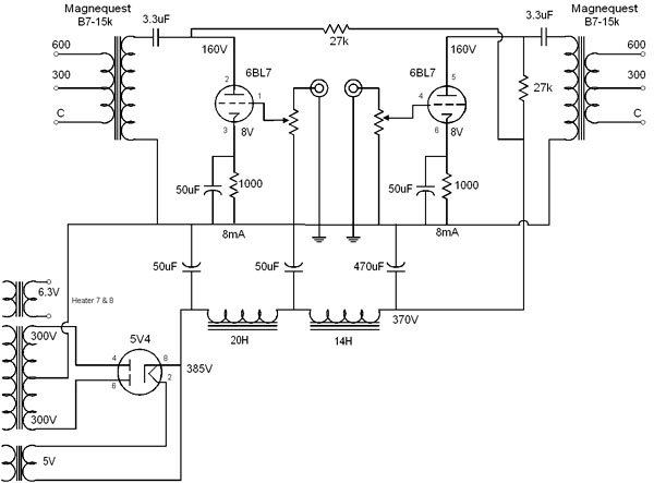

Here's a simple headphone amp I built to use with the Sennheiser HD 650. You can use any triode you want as long as it has reasonable gm. I wouldn't use a high mu tube; you're building a buffer not a voltage amp. You can use any of the small signal transformers with a primary around 15k and the secondary 600 or 300 and 600.
HD 650 specs say that Pmax = 500 mW. If I consider a power a bit less than Pmax, let's say 400 mW as a maximum power to be delivered to HD 650 by the amplifier then:
Umax = sqrt(P x Rh) = sqrt(0.4 x 300) = 11 Vrms
Thus, if I consider input signal of the amplifier as of 0.1 Vrms than the amplification of my amplifier should be 11/0.1 = 110.

The transformer I will use for my SE amplifier has two primary windings of 10 kOhm each and two secondary windings of 300 Ohms each. Thus, I could have nine combinations of primary/secondary impedances depending on how windings are connected: series, parallel or separate one is used. From these nine combinations five are different and assuming that HD 650 have impedance of 300 Ohm I could have five possible loads (RL) “viewed” by a tube:
40k (N = Nprim/Nsec = 11.55)
20k (N = Nprim/Nsec = 8.16)
10k (N = Nprim/Nsec = 5.77)
5k (N = Nprim/Nsec = 4.08)
2.5k (N = Nprim/Nsec = 2.89)
So, I am going to choose a tube. As far as I understand this choice also depends on RL/Rp ratio, where Rp – plate resistance. I saw different recommendations: 2, from 3 to 5, from 3 to 10, etc. What is a justification of such recommendations and where I could read about this in details on internet? Also, could somebody please recommend me good sounding tubes based on the above RLs and Ns?

Hi Igor,
With the primary inductance of your transformer wired for 10k ohms, the circuit shown above should work fine as drawn. I would suggest you build a power supply that has a filtered voltage of about 350V to 400V at least 20 mA.
Try the circuit, the transformer primary impedance, and the 6BL7 and see if you like it. Try the 5k or 20k primary impedance and see if you like it better. You can try other tubes such as the 7119 or 12B4. You might want to leave room on the chassis for two tube sockets a 9 pin and an 8 pin. Experiment and see what you like. You will need to adjust the plate and cathode resistors to work properly with your chosen tube. Consult the online tube manuals for this information. Note: the 6BL7 used as an example has a Rp of approximately 2200 ohms.
I have a power transformer with the following specs:
260 V - 0 - 260 V @ 35 mA
6.3 V @ 1A
I believe I could go with this in my project. I am going to use a rectifier tube and a filter with capacitor input.
As far as I understand I could evaluate PSU output voltage as 260 x SQRT (2) or ~360 V. My question is: if I would need a lower voltage than how I can change it? Simply using resistor voltage divider? Or there is a smarter way?

360V is perfect for the circuit above. Don't forget you will drop some voltage across the rectifier tube and any choke. If you end up with about 300V that will be fine. I would adjust the cathode resistor to drop half the voltage across the tube and half across the plate resistor.
I have just bought RCA 5R4GYA and 6BL7GTB and will start building shortly.
My output transformers have rated current of 15mA and maximum current of 30mA. As far as I understand I have to take this into account when choosing an operational point for the tube. So, do I have to choose OP to be at 15mA or I can do it at 30mA? And what could happen if I will choose OP current more than 15mA (or 30mA)? For, example transformer frequency response will be worse or not? Will burn down if more than 30mA? Please advice.
Thank you,
Igor
Notice that your output transformers are rated for DC current. The output transformer I used was not. I had to use parallel feed and a plate resistor. You have a very different transformer.
That said, there is no reason you can't build a great little headphone amp with those transformers. You can either build the amp as shown in my drawing and parallel feed the transformer or you can use the transformer with the plate tied to one end of the primary and the other end to B+.
If you decide not to parallel feed I would try for a current of 15mA to 20mA through the tube; measure across the cathode resistor, and vary the resistor to get the current in the correct range. You may have to bring the B+ down some to get the current in the correct range.

As the schematic shows each triode draws 8mA as biased in this application. So the total current draw from the transformer under these conditions is 16mA.
And this is limited by rated value of the transformer primary?
The power transformer secondary.
If we have this as 200mA, does it mean we can supply current to approx 20 triodes?
If the secondary is rated for 200mA at a particular voltage that's what it will deliver.

I am thinking about headroom and need an advice if I am doing it correctly. So, I made an operational point analysis using ECC99 plate characteristics, which are similar to 6BL7. I used a load line based on:
E = 300V
Zp = 20k
Zs = 600
RH = 300 (HD 650)
RL = RH x (Zp/Zs) = 10k
I chose Io = 15.5mA based on my transformer rated current and Ug = 4V. Then Uo = 146V (see PDF attached)
Let’s assume that input signal have average level 200mv RMS. From the PDF we can see that grid voltage can change from -0 to -8V (peak values) or from 0 to -5.6V RMS or with amplitude of 2.8V RMS. So,
20log(2.8/0.2) = 23dB
Does it mean that the amplifier has headroom of 23dB?
