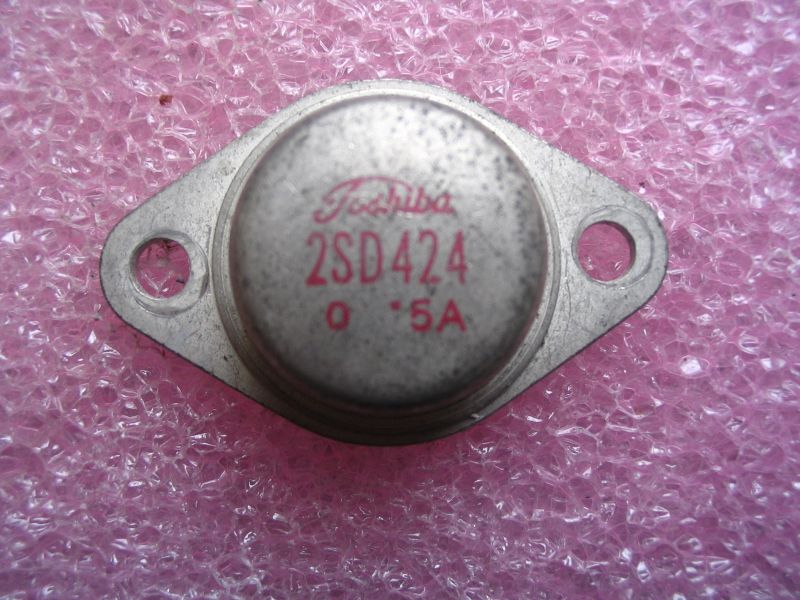

Almost looks good.
They should handle the copper coin with more respect. Nicked up like that they don't work well.
The die looks good sized, too bad they don't rotate it 45° like it should be.
I guess that's a generic high power die, I don't think they make different die's for their very big portfolio.
I bet if I'll order a MJ15003 there will be the same die inside. Too bad I cannot measure the dynamic characteristics...
If one can/will do some testing, I'll be happy to send him/her one for free.
cheers
cheers
jacco vermeulen said:Maybe Toshiba is faking Chinese parts.![]()
Jacco are you joking?😀
That was the idea, yeah.
But as China has been producing these numbers for a long time and maybe longer than Toshiba has not manufactured them anymore, it makes you wonder what is real and what is not.
In 20 years from now the clones will be the genuines and the originals merely antiquities.
(must be the weather)
jacco vermeulen said:That was the idea, yeah.
He, he, in that case you're right😉
