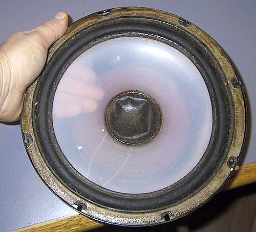

Polypropylene is transparent in its natural state. It also degrades in sunlight.
The very 1st MTMs i built (triangulated TLs/1976) were Harbeth (IIRC) factory units that were claimed to be the 1st use of PP and they were clear.
PP is usually doped because they have a fairly distinctive colouration in their natural state.
The speaker below is an example (found on the side of the road -- its mate suffered from cone failure from UV exposure.
dave
dave
