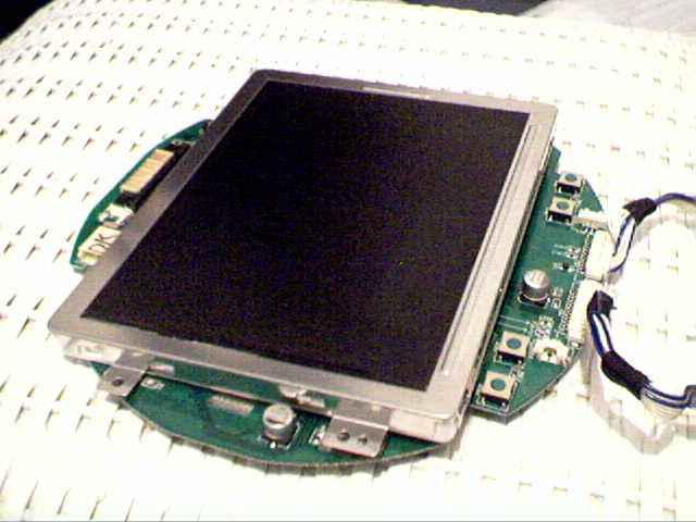

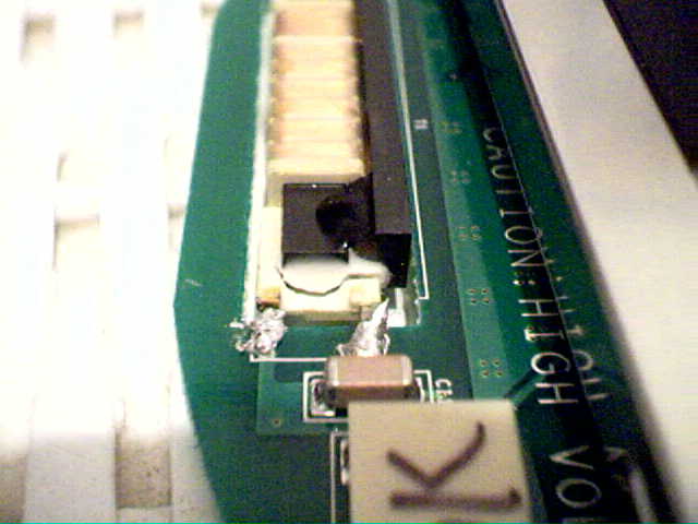

well the worst happen. i had everything ready and perfect for projection. anyway i think maybe i hit the lcd on something and this peice on top cracked. now i cant use it. so if anyone wants this ill give it for like 20 dollars or best offer.
i guesss i need to but a new lcd
here are the pictures.

try it!
Maybe that is part of the backlight circuit, which you don't need anyway. You should try it, to see it it still works.

with that backlight thing broken you will not see any picture without shining a light through it. Also the psone lcd has no splash screen or anything you will need to power it up (obviously) and supply it with a image source before you will see anything other than a slight change in the blackness of the screen. Dont give up hope yet.

i think that peice controlls all of the power. because when i use to plug it in it would turn black and now it doesnt turn black and i dont get any sound or anything

i'm sure that piece is just for the backlight. the one i bought off ebay awhile back had the same problem, that piece was damaged and the backlight would not light up. but the LCD itself worked fine.
strip it and shine a flashlight (or whatever) through it and you will see.

that's the ccfl back light coil it really shouldn'y matter
