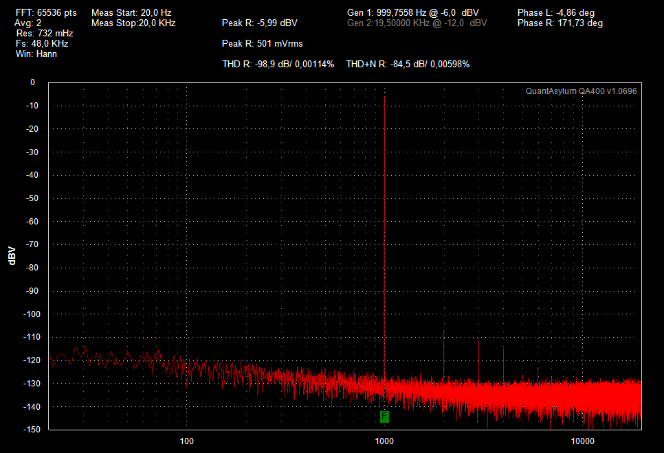

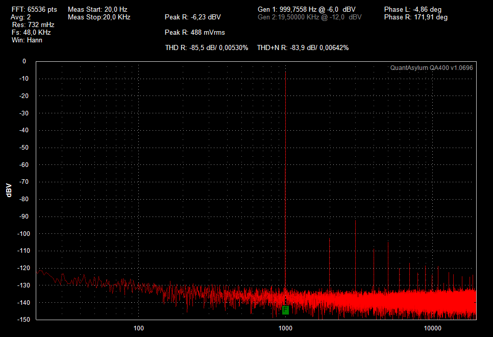

The first two attached pictures show the results from self oscillating operation.
Picture 1: 1W into 4R
Picture 4: 10W into 4R

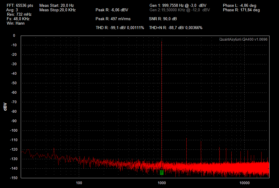

Third and fourth picture are in clocked mode.
Picture 3: 1W into 4R, clocked
Picture 4: 10W into 4R, clocked

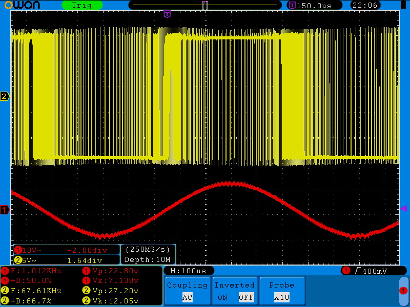

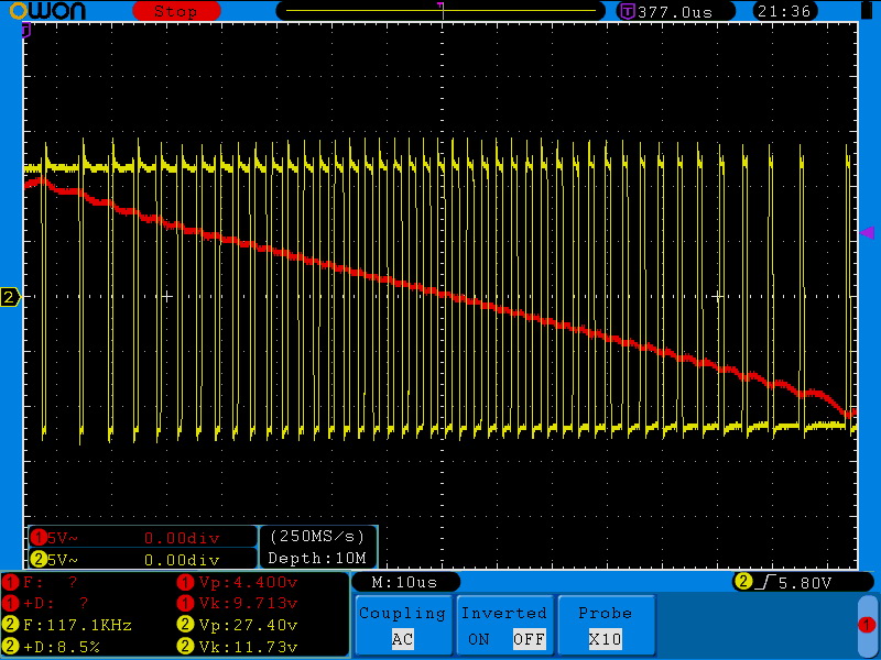

Anyway,i want to share some thoughts with you guys."Problem" with self oscilating amp is in its sigma delta modulation.....which means frequency and duty cycle together are changing during the time when input AC voltage is applied(on modulation).This (for now) looks impossible to synch becouse we have to know "middle point" of each pulse to make synch pulse from which we can generate oposite size pulse (for second channel) , and frequency is changing ultra fast.With constant clock thats easy as i mentioned before,we need simply to invert triangle wave.Here if we apply input clock ,and this i tried, we are blocking natural sigma delta modulation and amp is forced to do something which is not good for sound.
This can be done with some tehnique pulse to pulse ....... find-center-lock system or with some simetry related to MODULATED triangle.Still any of that two requires ultra high speed circuitry.
Also one more thing .... i am talking here (and we all i think) about integrator input type self oscilating class d amplifier.Does anyone here made digital chip (D fli-flop or other logic) based self oscilating class d amplifier which has sigma delta modulation?Maybe that concept is easyer to synch.I didnt try to do a researsh on that and if there is something that you guys know and want to share i will be very thankfull becouse i will test it and do all tests to be open source if schematic is good.I dont care if schematic is for 1W i will make and test it.

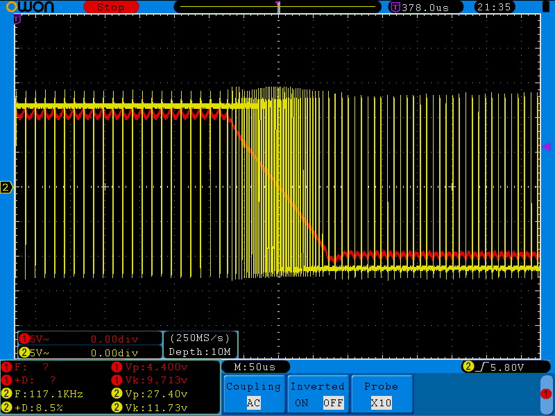

I will upload here a photo to show how sigma delta look like on one of my amplifiers.I dont need schematics for amplifiers doing this what i am talking about.I am interested to learn to how to make this as working concept for 1W amplifier which means to improve what i/we already know about all this.
I dont have humps-bumps and huge issues.....just distorted sound.Very distorted.
Very distorted sound is a huge issue.

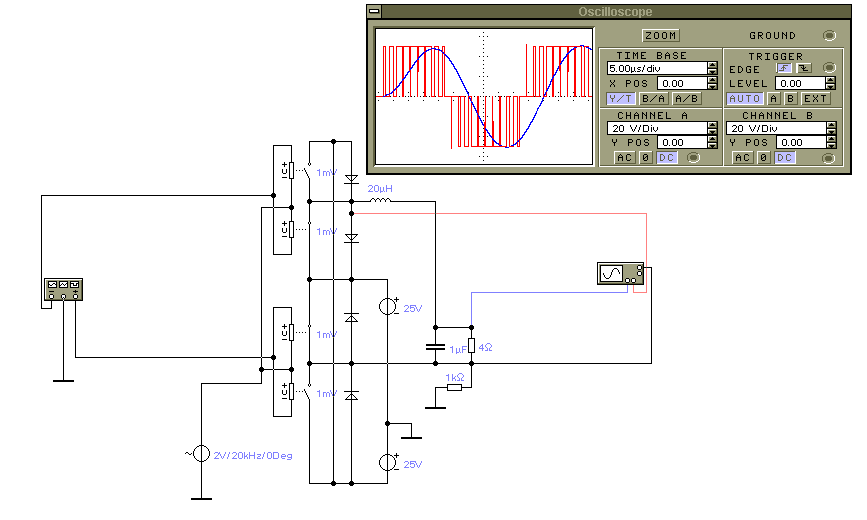

BD modulation is very simple.
Can be done in practice many ways. But what is the relevance to synchronising?

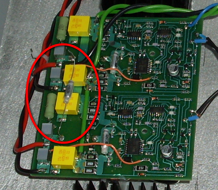

I'm not pride, but once I used synchronisation in order to avoid some interference between 2 channels. It introduced some distortion (not really low, about 0.1 %), but the users didn't notice.
2 UcDs, outputs coupled by a 15 nF capacitor.
Some distortion is always unavoidable. The right question is: how much, and how to lower.
The most important rule: injected signal must be free of steps and ringing.

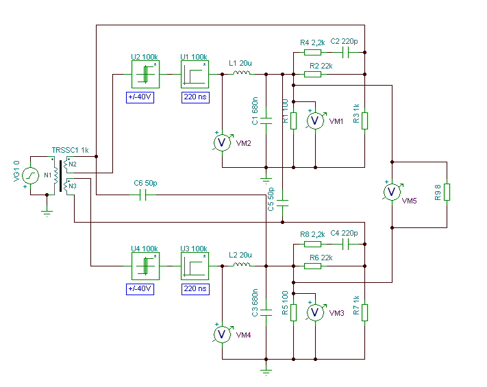

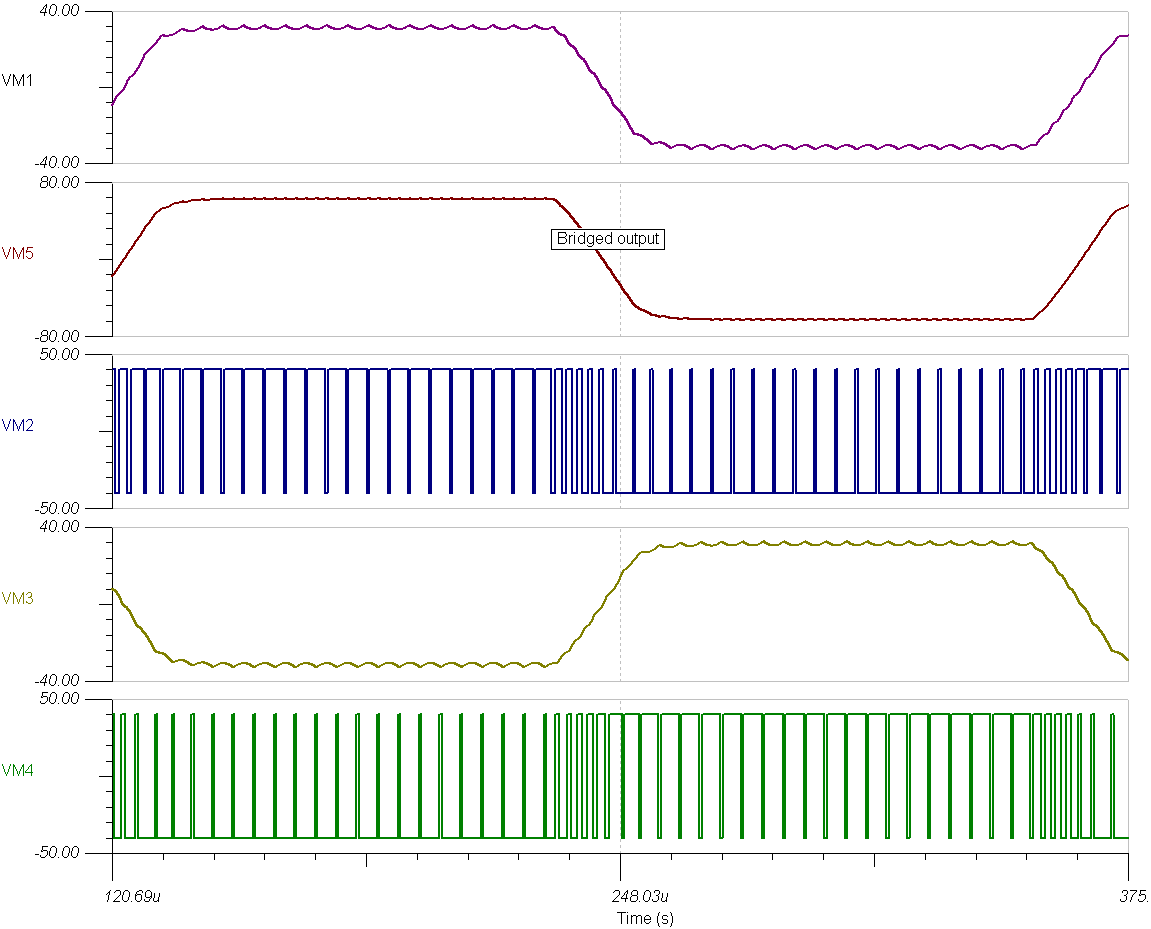

To make it clear: the channels are synchronised together, not to an external source. (That is a wrong way, however can be done, but inferior in terms of quality.)
To be specific: I'm designing a post and pre-filter, matrix feedback, true phase-shift self-oscillating, bridged amplifier. The pre-filter feedback is really neccessary only in case of the efficient, common mode filter, otherwise post-filter feedback also has a chance to work correctly, and actually this is the first I'm trying.
I believe this works, but I'm not convinced it's better than a clocked ClassBD, because a clocked ClassBD has a doubled effective switching freq regarding to the feedback stability, while self-oscillating amp has to be designed for the real switching freq. They are probably the same both in quality and in issues. 2 differences I see: the clocked design can be synchronised to other amplifiers, but the self-oscillating design can be more insensitive to complex load.
Update: extremely sensitive to delay mismatch.

...then you have to figure out such a feedback (matrix) loop topology that is anti-symmetrical for the modulating signal and symmetrical for the carrier. For the first time it seemed to be impossible for me, but now I realised it is possible. I'm working on this now, and the simulation is promising.

The load also has a sync effect, but fortunately it helps. Without load the carrier phase difference is extremely sensitive to delay mismatch, but if I increase load sync with a parallel 330 nF (the same amount as the LPF), it becomes much better, and if I replace it to 330nF+2ohm in series, then it becomes almost insensitive to mismatches (both for inductance and delay). I tried it even without the sync capacitors, but they are still needed, however only 10% of the normal feedback was enough to maintain satisfactory phase balance. Next step is trying in real life. Then to modify feedback to pre-filter.
