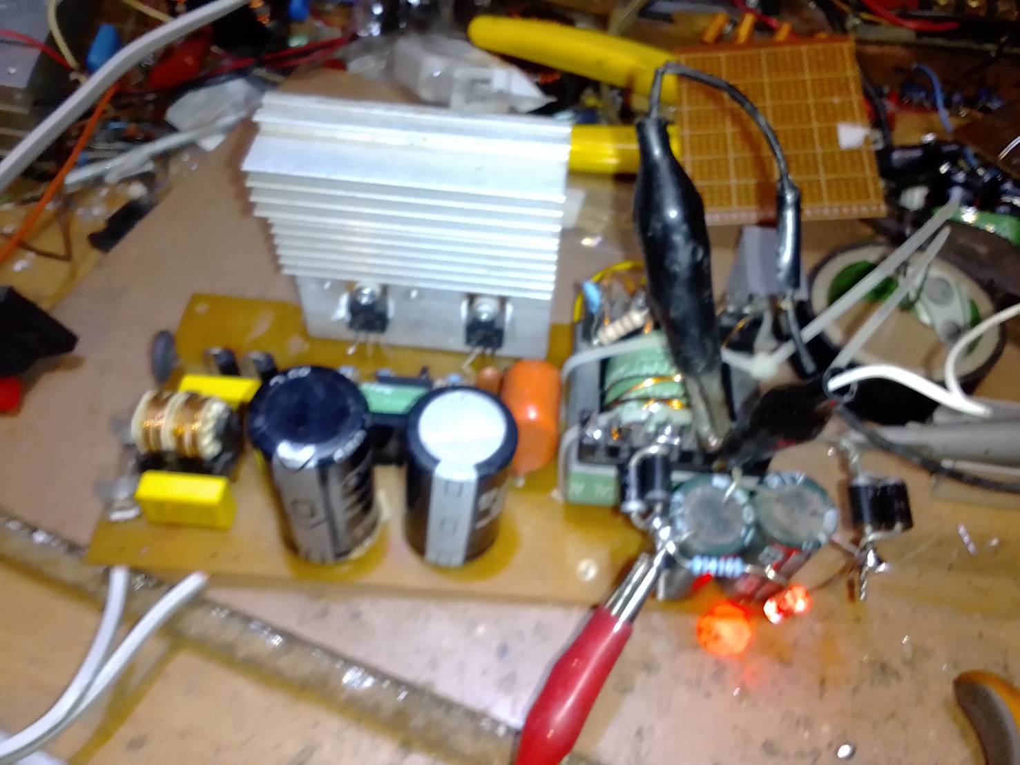

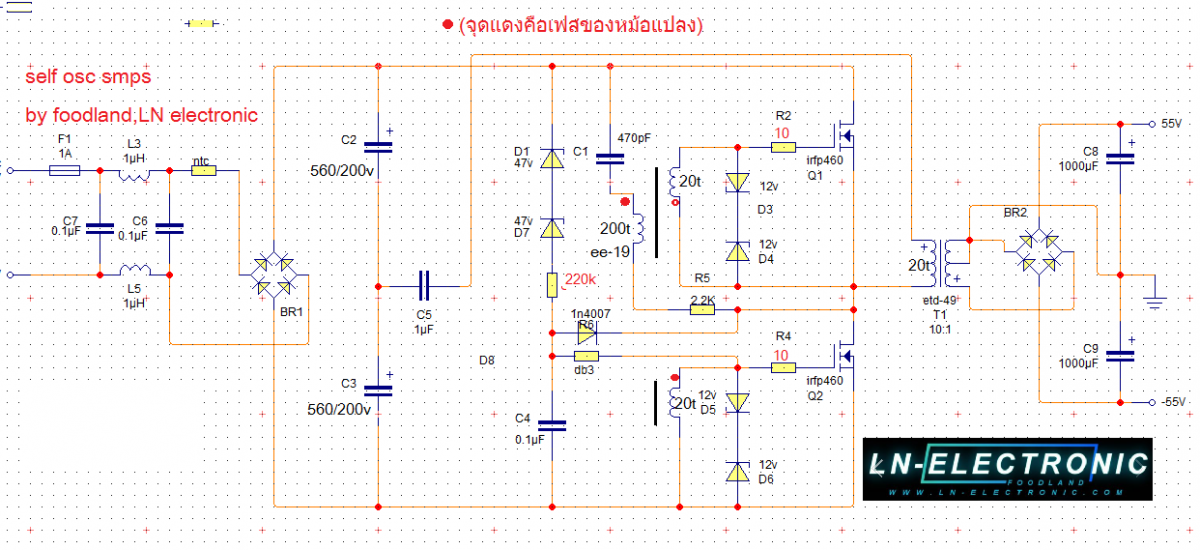

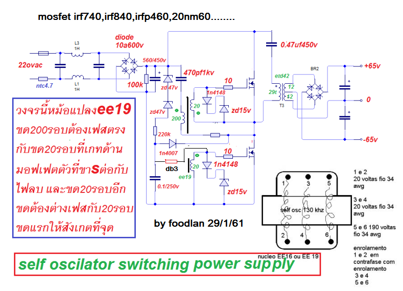

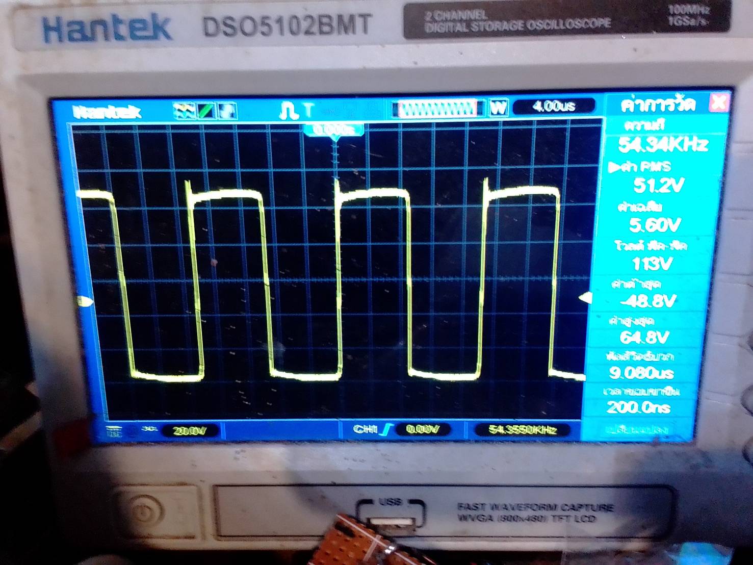

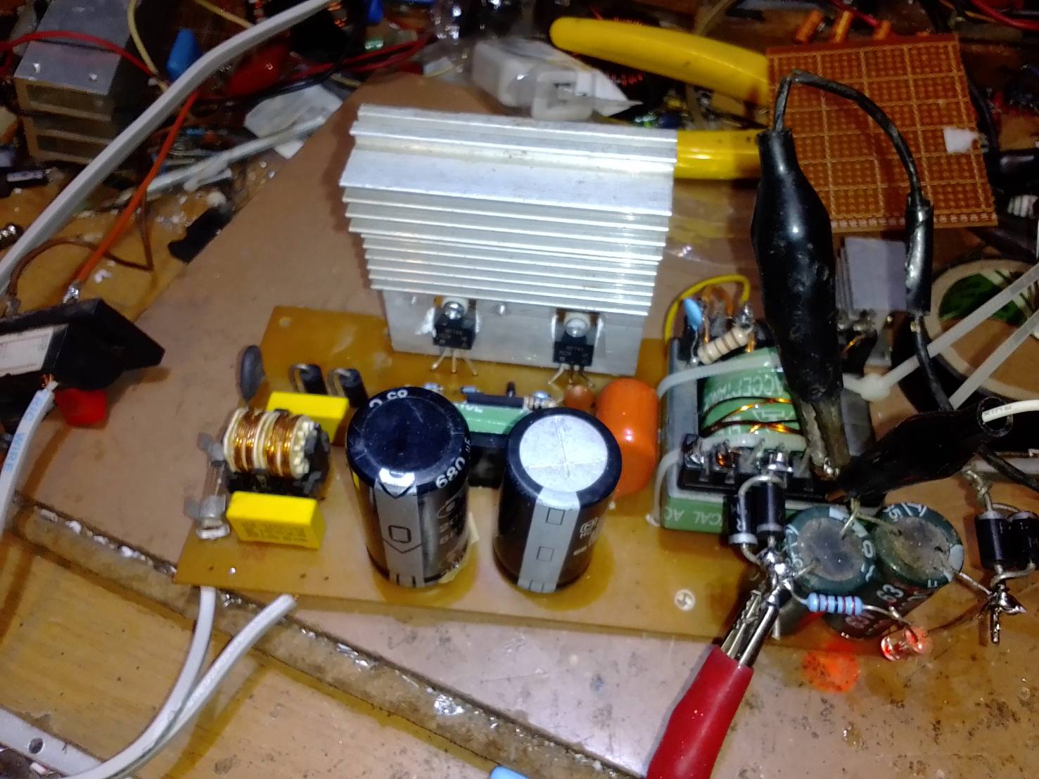

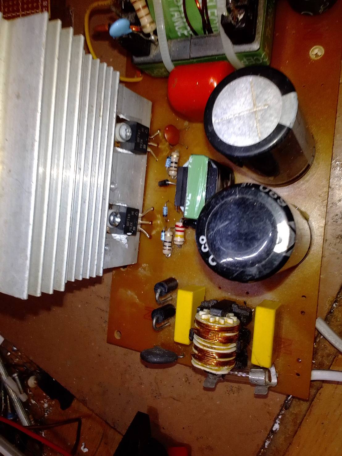

self osc smps circuit
osc tranformer use ee-19 dri gate 20turn
