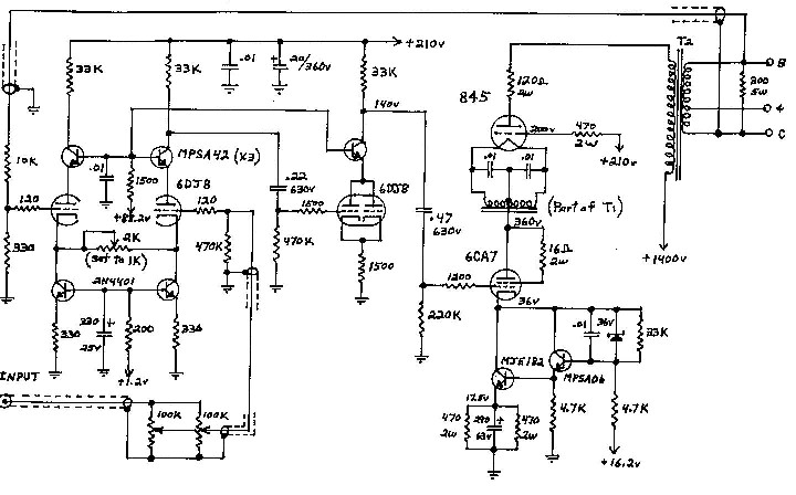

Most of the design for the bigger tubes i searched used the fixed biasing, eg. Ongaku 211, Ankoru 845, and many others. Is there any specific reasons why self-bias using high power resistors at the DHT cathode is not use, be it for sonic or safety reasons? can anyone enlighten?
Large tubes like these require higher voltages to operate correctly. In order to use self (cathode) bias, a large value resistor would be needed which would seriously hurt efficiency. So it's a matter of practicality. It also gived better control.

Actually I know of one 845 SE design that uses a kind of cathode bias in a grounded grid arrangement. The cathode is driven from a triode below which is current sourced through a transistor. If I can find the diagram, I'll try and post it.

It makes me dizzy just to think about it 😀the design u mentioned sounds interesting
To give a bit more input on fixed vs. cathode bias, as HollowState says, efficiency has a lot to do with it. Another is the class of operation and a third is consideration of B+.
At first glance, cathode bias appears to suit Class A perfectly well; however, it does have its downside. You need a higher B+ because some of it is taken up with the cathode bias voltage. Another disadvantage is the need for cathode bypass caps. These need to be of high capacitance and are usually electrolytic type, which do not give the best sound.
You can avoid using a bypass cap if you use Class A push-pull with a single shared bias resistor (or a CCS); however, the OP tubes must be really well-matched or else you will get a DC offset in the transformer primary, causing some DC saturation of the core. Separate cathode bias resistors give a useful degree of automatic balancing, but then you need bypass caps.
In any (PP) class other than A, fixed bias is called for. Sure, mild Class AB1 (close to Class A) can use cathode bias but separate, bypassed cathode resistors are essential and efficiency is impaired. With deeper Class AB1 and with Class AB2 or Class B, cathode bias is not viable. Fixed bias is the only solution.

commstech said:Most of the design for the bigger tubes i searched used the fixed biasing, eg. Ongaku 211, Ankoru 845, and many others. Is there any specific reasons why self-bias using high power resistors at the DHT cathode is not use, be it for sonic or safety reasons? can anyone enlighten?
Those "big tubes" mentioned there are low u triodes. That means a relatively high negative bias to set a Q-Point. Cathode bias would rob Vpk. The high wattage resistors tend to be more inductive, and really should not be used if fidelity is the design goal. Even if you parallel up a whole bunch of smaller resistors, you still have the heat problem. Besides, fixed bias tends to produce less distortion, sometimes much less.
Other times, the "big tubes" were originally designed as RF finals. In these cases, the amplification factors are so high that they require positive grid bias to set any sort of practical Q-Point. Here, cathode bias isn't possible anyway.

Yes exactly. We were not talking about 6L6s or 7591s. These are not "large tubes". The original poster was refering to 211s and 845s. These tubes work at 1000 plate volts (or more) and negative 80 and 150 grid volts respectively because of their low µ. Under these conditions fixed bias is far more pragmatic.
With smaller tubes like the 6L6 etc, I tend to agree with you. Self bias can be more easily implemented because the losses are smaller. Both bias systems have their pros and cons with these smaller tubes. However, I am of the opinion that fixed bias is generally superior for all but the lowest power output tubes. Self bias is popular with some DIY's because it is simpler, and it raises the bottom line for manufactures. So here, it comes down to designer's choice.
