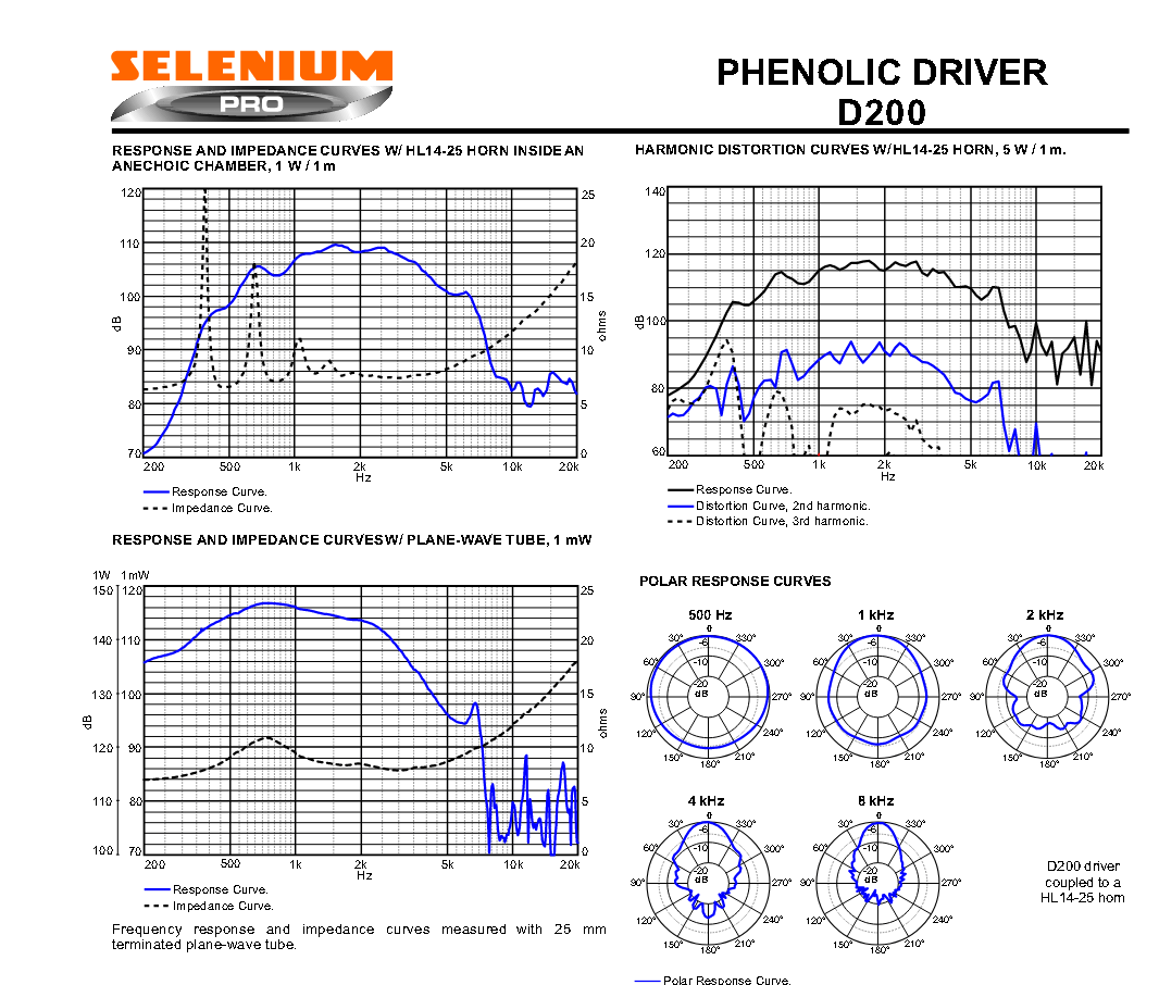

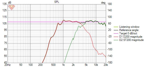

Anyone tried this driver? Looks pretty interesting. Screw on midrange 1" down to 500hz and possibly use WITHOUT a crossover???
That response is measured with a HL 14-25 Horn
Which is nice to include
otherwise your seeing the low end cut off created by the Horn.
So yes it would need a crossover.
But the bandwidth is relatively good to add a tweeter around 4 to 5 k
which is another benefit to reduce distortion found with typical 3 k crossover points.

likewise I liked a reasonable reference that Selenium datasheets include.
which include measurements with specific horns and stated horn model numbers

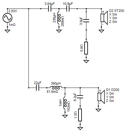

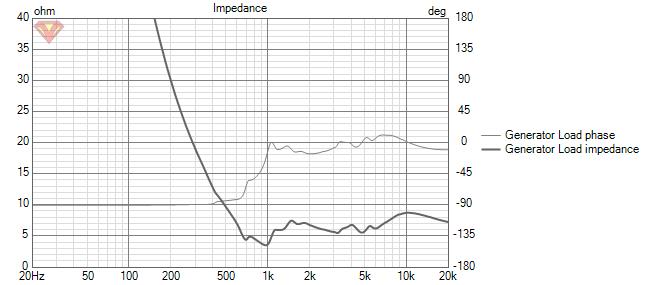

Just a Quick play around with the D200 impedance curve/frd with the HL 14-25 Horn
and the ST200 Bullet
They work, no pad needed with the bullet with such midrange output on the mid.
different story with woofer of course.
As with some horns the impedance curve can be a roller coaster.
I was able to get it to behave.
But the impedance compensation networks included, almost mandatory
to make it friendly
2nd orders on mid 3rd order on bullet
around 680 Hz and 4K crossing points
Reactions: freddi and EliGuy

As mentioned with some passive networks designed wrong
you can get horrible impedance dips below 4 ohms.
Even in this simple model, I had to use friendly crossover points.
And also use impedance compensation to keep away dips.
AKA overheat amps easily with 3 ohm or lower dips
this case the compensation kept the curve friendly and was needed
for flattest response.

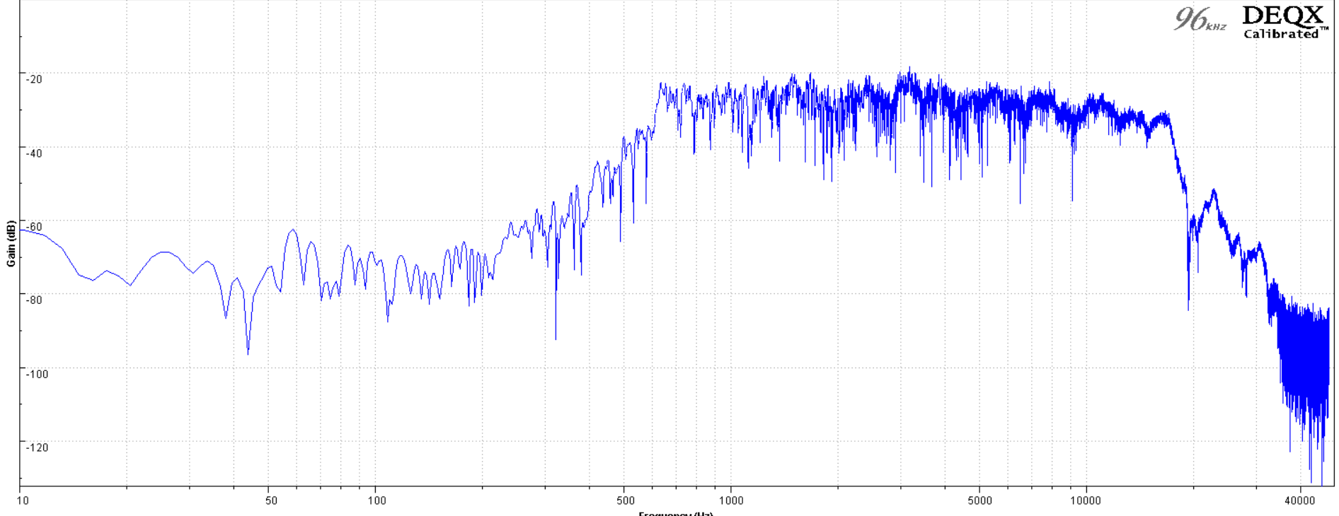

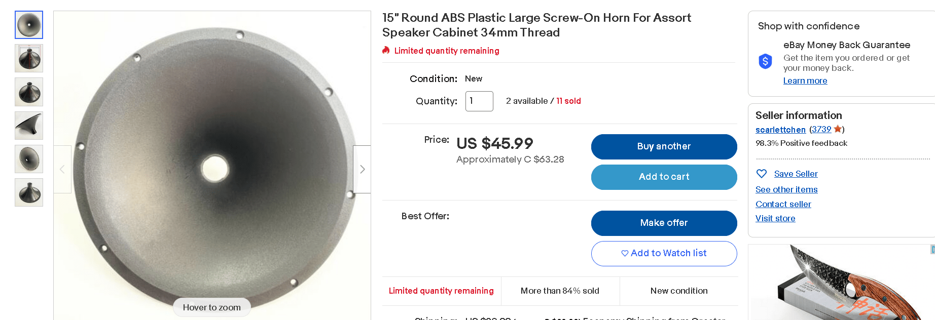

Here's the horn. Pretty good deal from CHina. I like the frequency response of these
Here's a measurement in room with a DE250 in it. View attachment 1158222

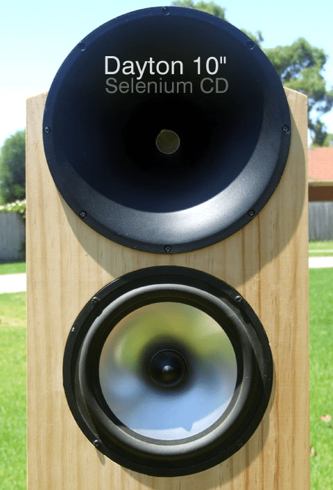

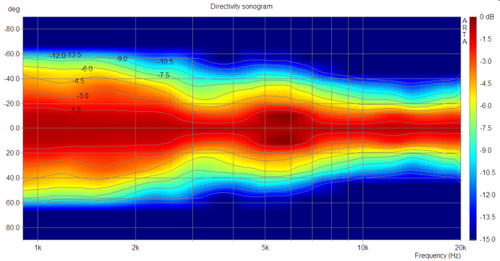

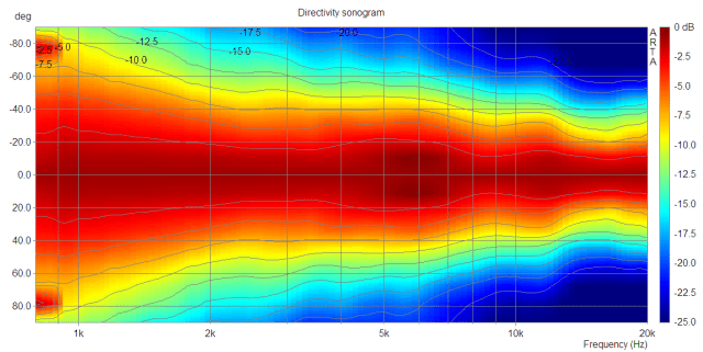

Would be interesting to see off-axis measurements.
The biggest issue with these horns is the screw-on throat, which is a tube section.
When you mount a regular (bolt-on) driver by using an adapter you basically end up with 2 throat sections, a source of waist-banding.
Paul Spencer measured the 10" (Dayton) with Selenium D220Ti (screw-on) and the resulting polar response isn't to be sniffed at.
The same horn with B&C DE250:
