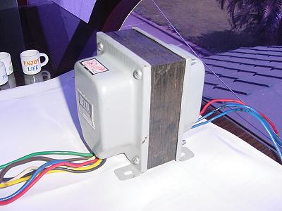

How does one select the core size of a transformer meant for audio use. For a power transformer we use the power line frequency and the maximum operational flux density in the core.
For audio do we use say 20Hz as the frequency and the same flux density as for the line frequency? The core will be CRGO silicon steel core.

Hi Ashok
Thanks for starting this thread, which will specifically help DIY’er in countries such as India. While NOS and OUS Tube are available quite easily the biggest problem in India is the output trannies.
But it is easy to get a good quality trannies custom made in India from specialist or small shops. While these folks usually lack the theory they are quite skilled and if given exact specs then good quality trannies can be expected rather cheaply.
So I take the liberty to add to your query and wonder if some can help with the following:
EL84 SE Transformer capable of max 10 watts at 20hz to 20khz, 50mA.
What core size?
What Wire gauge for primary and secondary
What gap?
Same specs for a 6L6 SE also.
Any help will be greatly appreciated.

Hi Corbato,
There are many transformers winders here who claim that they can wind audio transformers. Most are younger than me and so they would not have gone through the 'tube era'. That does not mean that they cannot do it but that they have not spent enough time with these things.
I still have people come in and see the tubes and ask me what they are. In the electronic market in Chennai, Mumbai and Delhi shop keepers have smiled and said "why do you want those things. Transistors are far better. Tubes are ancient things, no one uses them nowadays".
So I would prefer to wind my own audio transformers. As I understand the CRGO cores should be good enough. I would like to know what winding schemes are the best and what core sizes to use.
I am sure there are are many DIY'ers or experts who would not mind sharing their expertise. I used to wind my own power transformers several years ago.

Hi Ashok
You right in implying that experience in vital. The sound of trannies I had “reversed engineered’ are nowhere near the original that were probably made by Philips India in the ‘60s.
Tubes are ancient. No body wants them. Perhaps that is the reason (thankfully) that they are cheap here. You can find an ok collection of trannies for tubes such as ECL82/86 (radio use), but I guess high quality amps were not made that abundantly during the tube era, so finding matching trannies is a tall order. Few months ago I bought a pair of DELTA Push Pull items (4K primary) that I intend to put to use in a 4 x EL84 amp someday. These are I guess still made to order by them. But not UL taps and certainly no full coverage of the audio band. Pic is attached.
I have more than 50 NOS and OUS output tubes with me. Sadly no output trannies to match.
