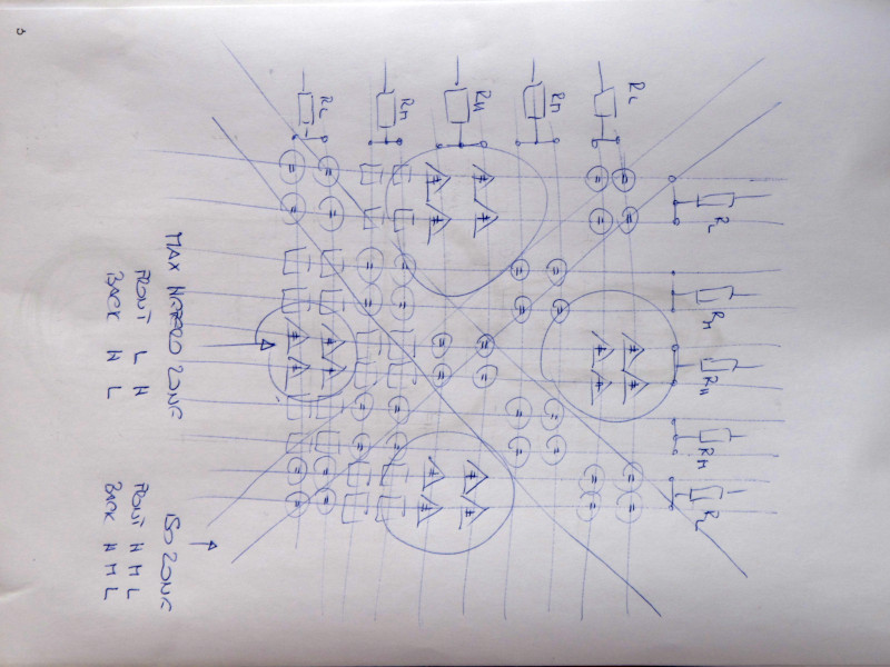

My basic idea is starting from vertically a segmented ESL. Now, why not double- or X-wise segment the two stators? By including another, a horizontal segmentation on one of the two stators, along with the vertical segmentation of the other stator? This would/might provide a more or less narrow HF-extended area in the middle, and more and more HF-attenuation not only horizontally, such as in all the «standard» segmented designs I know, but maybe also vertically.
Such a X-wise, or 2-dimensional segmentation would create zones of symmetrically applied forces, when both HT audio signals have the same frequency cutoff (I call it the IS-Zone), and also asymmetrically driven zones, when the back- and the front stator rods are fed with audio HT having different HF rolloffs (which I call the hetereo zones).
So there are questions over questions: Can such a setup like such an ESLX work at all? Maybe I neglect something important? And if it works, what would the expected drawbacks be? More phase distortion? More harmonic distortions emanating from the hetero zones? Is there any knowledge base about such ESLX approaches – and where to find these infos, if any?
And what about cross-wise segmentation? I am quite shure that many ESL-designers und -builders already had the same idea about a crosswise segmented ESL. But I cannot find neither references, nor threads. So please point me to the correct references if there are any.... The series form is actually an RC transmission line - look up the telegrapher's equations on wikipedia. Think of each ESL segment as a capacitor to see how this works in the equations. For a narrow, tall, ideally floor-to-ceiling ESL, this form has a couple of pieces of magic. Firstly, it provides near perfect equalisation - a flat frequency response over a very wide range of frequencies - for a full range ESL you need about 10 segments.
The other piece of magic is that it creates a very flat polar response - it gives the same SPL as you move off axis to either side of the centre of the speaker. In this respect it is better than most conventional loudspeakers. ESLs have a reputation for having a very small sweet spot -the head-in-a-vise effect. The RC transmission line design completely eliminates this problem. At high frequencies, only the central segments radiate a lot of acoustic power. At low frequencies, the whole panel radiates.

Thank you! These three models show that life is not meant to be easy ... and indeed are helpful in terms of motivator. I think by now, best thing to do, if I want to proceed into ESL's DIY, is to start a learning-by-doing experience with a small HW functional proto, e.g. some 20cm*40cm and then look how it behaves. And then try to understand the specific behavior.
I can see this working.
I have had in mind for a few years of trying to use a segmented front stator with a vertical orientation and a rear segmented stator tha has horizontal orientation.
The 45 degree offset as shown in post 4 IMHO would be labor intense and would serve no purpose to get the same effect.
I think if one were to give this a try I think that a square or circular shaped pattern for the diaphragm should be used.
If one were to choose a rectangular shaped diaphragm, I think that it would result in a distorted radiation pattern than what was intended and would be better off with just sticking to the front and back stators both in same direction as normally done in regular construction practices.
