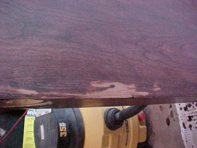

I'm getting close to finishing up my Kit281s, and have veneered them and stained them. The stain is just not soaking into areas as you can see below. My best guess is that I got overzealous with the sanding, and created some thin spots that are no obsorbing the stain. I need a product or technique that could help this out because right now it is driving me mad. Check out the pictures.

It looks like you sanded through the veneer a little too much....my suggestion is without redoing it is to seal it and go with a little darker stain as the above post suggested...it will still look good just not the colour you were looking for....yikes

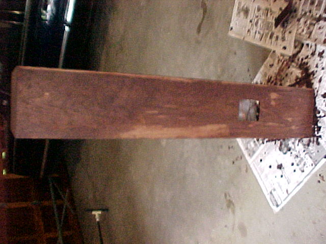

Thanks for the suggestions, and maybe some more information would help. I agree that I probably sanded it a little too thin... this being my first speaker/woodworking project if this is the only problem i think I will be ok. The pictures are after 3-coats of stain, and the guy at the local hardware store said a pre-treatment wouldn't have helped it since it is just veneer. Basically my problem is not too-much absorption, it is too-little.
Since it was apparent after the first coat that there was a problem in those areas, I had expected them to go away as I increased the coats. While the dark areas have continued to get darker, the light areas have no changed much since the first coat. Because of this, I am skeptical to try a darker stain since it doesn't seem like it will change the color that much. I wish I would have just gone with a light stain, then I wouldn't have been able to see these areas.
Since that is about $100 of veneer on there, I really hate to just rip it off and start over. I think if it comes to that, I will probably paint the back and sides a piano-black, and leave the front finished in that color. The fronts really look great as they are, no spots of splotches on them for whatever reason.

You're problem was not too-little absorption, it was uneven absorption.

Looking at your photos, another reason for your problem comes to mind. Did you get wood glue on the veneer, and not clean it up properly? This sometimes causes the effect you have, if you don't take off carpenters glue with plenty of water when it is still wet, or scrape it off when fully dry.
Or was the surface contaminated with oil, grease or silicon polish?
There had been some wood glue on the veneer, but oddly not in the spots that were miscolored. I think when I was trying to send the remnants of the wood-glue is when I probably sanded the veneer too thin. My best guess is that the light spots are the paper-backing showing through, and that the paper backing refuses to stain the correct color. What shades are the anoline dyes available in?
there was also not really any conaminates at all on the wood. I sanded with 150grit, then used mineral spirits to clean them. I let the wood dry overnight, and then stained them. 3-coats over 2 days, but it was apparent from the first one that I would have problems. The light spots didn't show up until the stain was wiped off during the first coat.

Yep, definitely looks like you sanded thru the veneer. Nothing will fix it except re-veneering, unfortunately. The smaller spots may be due to glue contamination, but those are beyond help, as well.
Next time, just sand the veneer lightly with 220 grit to remove any fuzzies. Veneer doesn't need much to get a nice flat finish. The most important step is making sure the substrate is near perfect before applying the veneer.

what interests me is it doesn't fully look like a sanding pattern. I lean towards the glue bleed thru theory

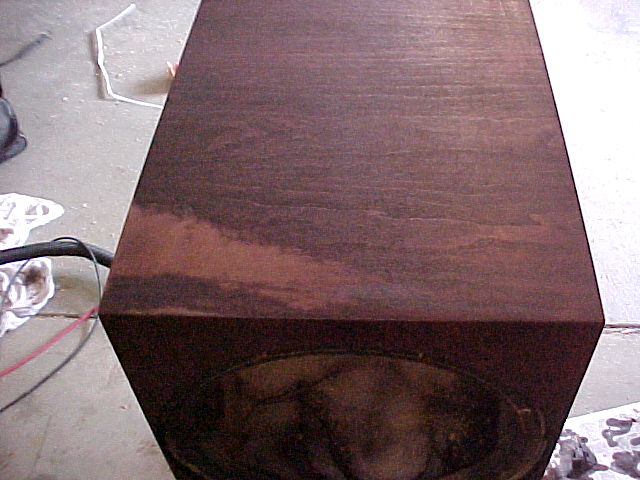

Take agood look at your work.
Are there any wood grain lines on the lighter areas?
If not or they slowly disappear you have sanded down to the paper backing.
Some of the advice is good. In this order
1 Seal your applied veneer with a shellac
2 sand it with no less than 220 grit paper with a black and by hand.
3 seal it again with shellac, then hand sand it one more time
4 wipe clean
5 one light coat of shellac
6 stain to desired colour
7 apply finish thinned 1/2 with appropriate thinner
8 second coat of finish full strength
9 sand with 400 and wipe
10 coat #3
11 sand with the finest you can get
12 last coat of finnish

I personally think its a combination sanding through and the glue soaking through. On the top (pic 3) I can definetely see that I sanded through or near-through. On the back picture though, the splotchiness can not be anything but glue. I am baffled by it since almost all of the sides look fine except for the back on one, and a side on the other, and a small spot on the top. I think that I used the glue pretty much the same on every piece, but well.... I've learned alot on this project.
The next project (center channel and surrounds) will be done with contact cement... is this easier?

Instead of the analine dyes you could try glazing over the pale areas with artists oil cover, brushed well out you should be able to feather out the pale patches, allow to dry for a week or two before varnishing.
The sure result is painting black, if you bleach it out, you will still have to control the blotching.
I would say the artists oil is a low risk process, if it looks good then you are home.
Using a sealer to control the blotching works by reducing the stain penetration, so you may not be able to get the depth of colour you seem to be aiming for.
Ripping off and reveneering, unless you use different veneer still leaves you having to control the blotching, often wiping the wood surface with turps or white spirit will show up the finished appearance, and highlilght potential blotching.
