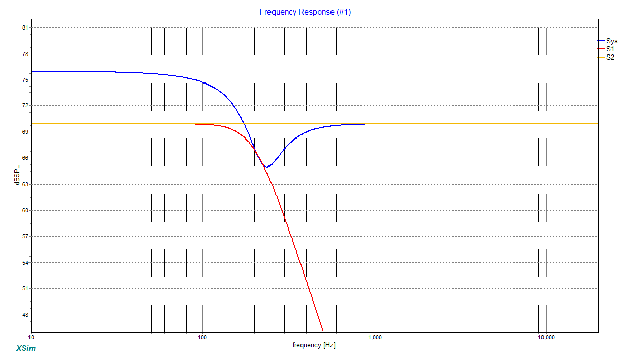

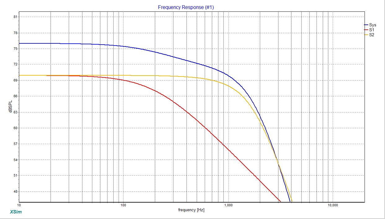

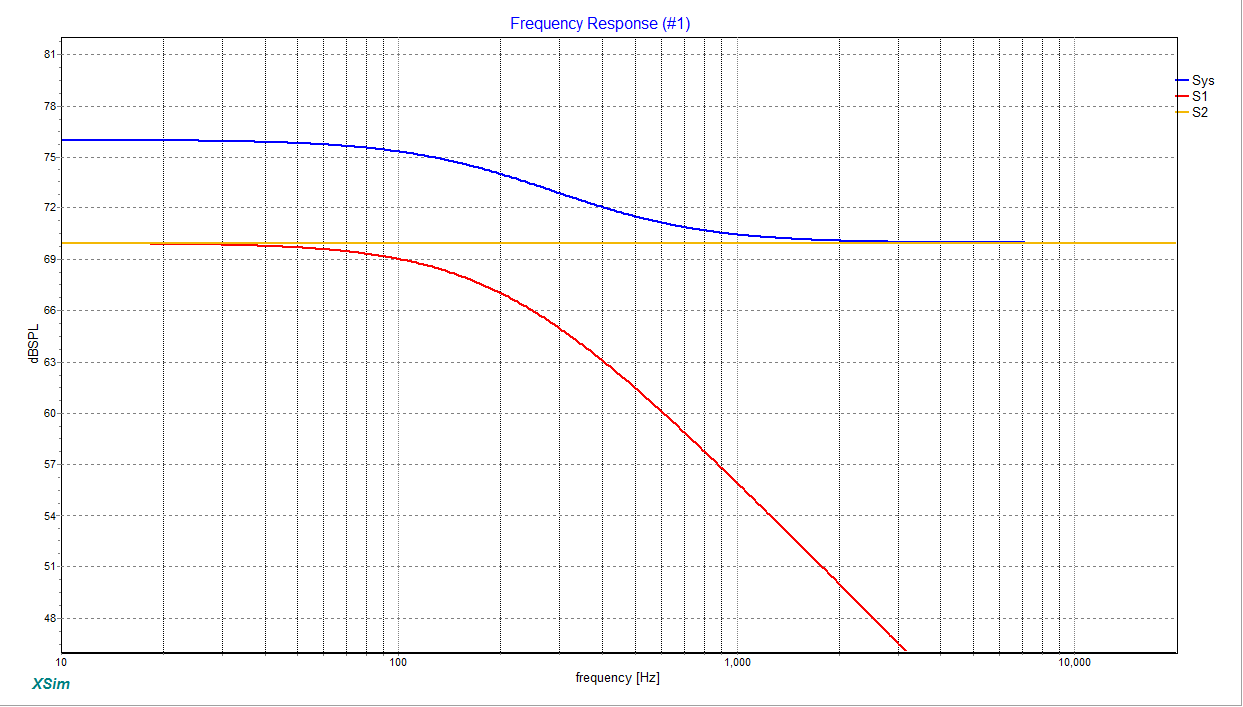

In theory (for now), you shouldn't worry about trying to match 6dB and 18dB. The 18dB crossover is at a higher frequency and you don't reach it until the helper woofer is down and crossed where it doesn't matter any more.
So the 6dB is not about the upper woofer's crossover region, it's about the upper woofer's passband. In a 2.5 way, the 6dB crossover allows the two woofers to work together until one is reduced in level. If you used an 18dB crossover on the helper woofer in a 2.5 way, you'd get a notch due to phase on the way down.

I think you have it. I have an example of rolling off slowly vs fast, showing the notch I mentioned.

Here's the basic example where 6dB for the lower rolloff doesn't cause a notch even when the 18dB cross is there. (Although real drivers are different, most of this is relative so you should find that it works if all else is the same.)At an 18db way up at 1.2khz, the 12" woofer's phase would be way different than down at say 200hz.
