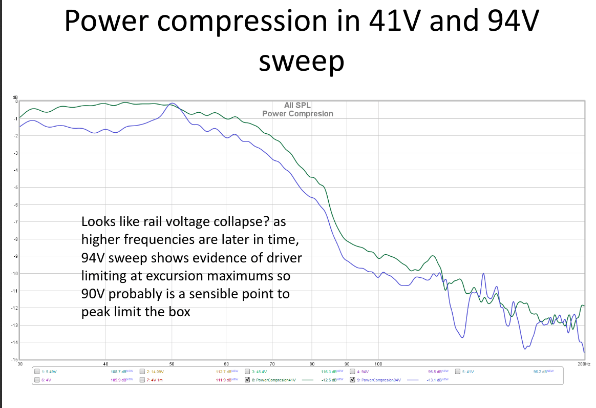

Beyond xmax isn't very useful at the frequencies where xmax would be exceeded as the sound is compressed. This is a graph of the relative change in response of one of my subwoofers under high voltage sweeps:
Ignore beyond 50Hz as you start to see the amp misbehave. The box is tuned to ~30Hz and you can see the compression maximum below 50Hz corresponds to the maximum excursion of the driver ~40Hz. At this frequency the box will simply not get appreciably louder so there is no point putting more power in. Outside of this the box can get louder but the frequency response will be altered. My opinion is that unless your trying to get extra bass extension using side chain limiting or amplitude dependent high pass filtering the best solution is using a combination of high pass filter and look ahead peak limiting to avoid over excursion.
