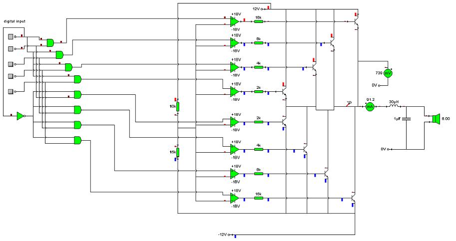

While on the subject of pure digital amplifiers i was just messing about with good old crocclips and i came up with what is essentail a pure digital amplifier, It is basicaly a ADC with a power output stage but the signal remains digital until it gets to the speaker.
in my simultions it seems to work but i dont know if it would in real life.

bob123 said:i was just messing about with good old crocclips and i came up with what is essentail a pure digital amplifier,
Interesting idea, Bob. I tried to build something similar about 10 years ago, but it had ultrasonic transducers for each bit/channel. Never could get it to work right.
The idea was to use the air as the low pass filter / intergrator with drivers that were optimised for one, and only one, signal level and frequency. Nice idea, but I could never get it to work.
Is anyone else doing the sort of amp Bob came up with?
