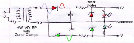

For 30mA output, no need to complicate things more than necessary: use two half wave rectifiers (voltage doubler) on the 18V or the 12V winding, and regulate with 7812/7912.
That way, a ground will be created
like this ?
No, that will give a 9-0-9 or 6-0-6 supply.
Look up half wave voltage doubler, or the op-amp psu project - AC plugpack version on the schematic on my website.

I would just wire it as a normal -/+ supply as I outlined earlier with the windings in series. One bridge rectifier and two reservoir caps. One cap will see around 25 volts ad the other around 16 volts. Thats no problem, 16 volts is enough overhead for a 78/7912.
The centre OV rail of the new supply (which is the junction of the two windings) connects to your main 0V line.
Another option... and it maybe better as the current requirement is so low... is to use a simple zener shunt regulator off the main rails. Two resistors and two zeners, it gives better performance than a 78/7912, and no multiple grounds to deal with.
like this ?
like this ?
Sort of 😀
I was thinking direct of the main DC rails, but yes, either or 🙂
