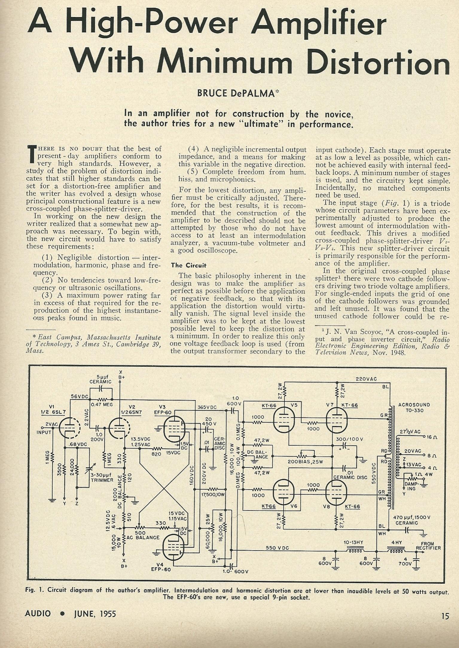

Out of curiosity I remembered reading about an amplifier that used the secondary emission EFP60. So I dug around in my old Audio magazines and found it. They're not triode connected though but are none the less odd tubes. I have a bunch of these but no sockets. Maybe someday. 😉 The full article can be found here.

@HollowState: thanks for the article find, will study ...

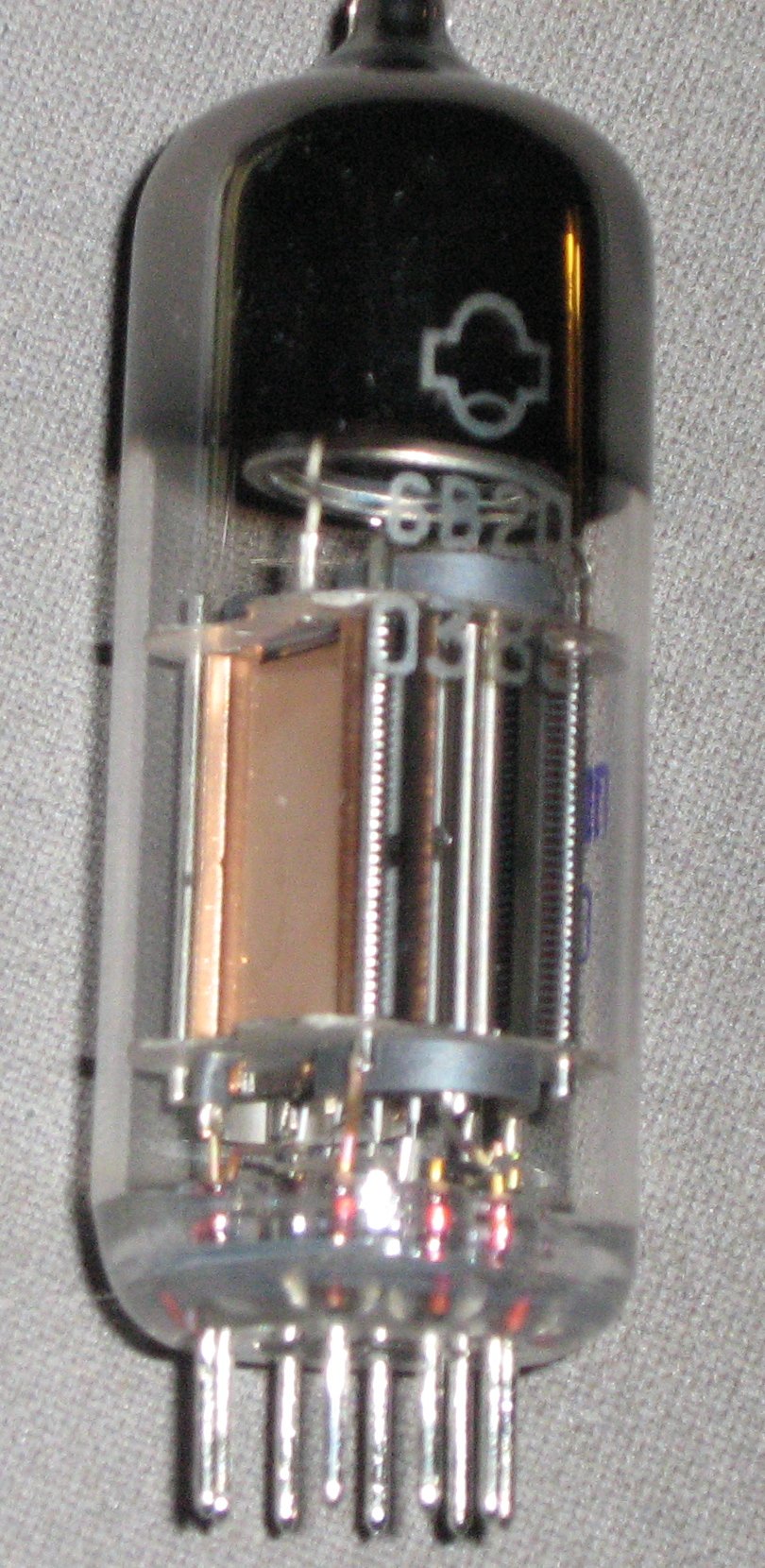

The Sovjet 6V2P is described in another source as suitable for "application in nanoseconds pulse circuits of stationary installations" --> that could mean ground based radar ...
and a scientific paper from 1965 mentions it:
A NANOSECOND LIGHT-PULSE GENERATOR WITH EXTERNAL SYNCHRONIZATION
A. P. Onuchin
Institute of Nuclear Physics, Siberian Division, Academy of Sciences, USSR (Novosibirsk)
(Received June 28, 1965)
A generator of light pulses of 1 nsec is described.
"the 6V2P was tested for this purpose. In its usual state the tube is closed. Pulses 100 v in amplitude with a rise time of 5 nsec are delivered to the control grid. Discharge time of capacitance C„ is 2 nsec. This circuit operated for a long time at a frequency of 10 kHz. Synchronization accuracy was better than 0.3 nsec"
today femto sec pulses are common but in 1965 1ns was possibly a great thing ...

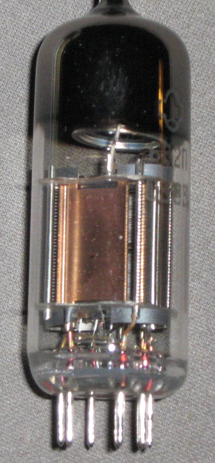

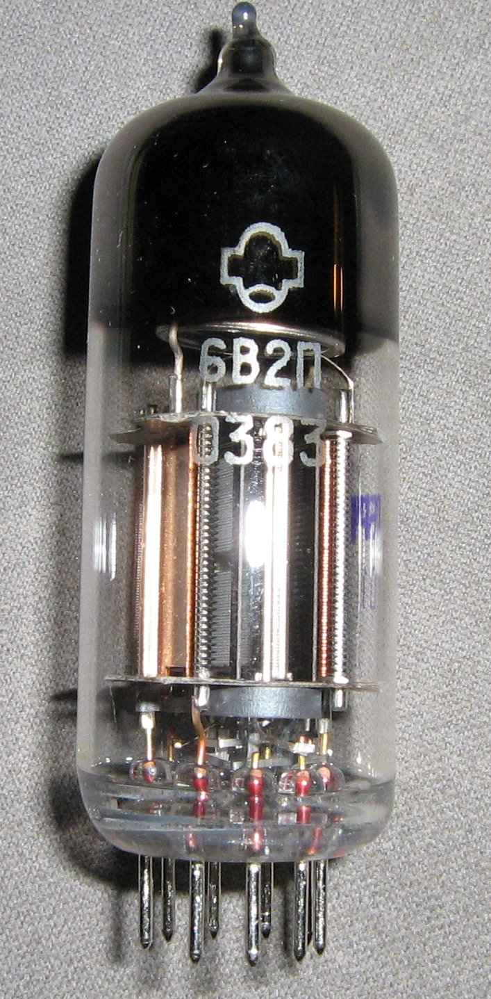

even if not suitable for anything here, at least it looks good as a collector's item, it actually does have frame grids (control and screen) and solid gold plates 😉 well, don't know, could be brass, or nickel-copper alloy or whatever produces maximum secondary emissions ... looks goldish though ...
can try to plot some curves ...

A little more thinking about these, and it occurred to me that the electron multiplication will not occur if the dynode and the plate are at the same potential. Normally the dynode is less positive than the plate, so the cloud of secondaries fly off to the plate. In triode, this would not happen if the dynode is connected to the plate. Just a cloud of secondary emission getting re-absorbed by the dynode.
One could prevent the secondaries altogether by grounding the dynode (to cathode), but this may reduce the grid 1 gm some by acting as a shield (from the + plate, but not from + g2, so g2 will soak up the cathode current instead, melting). Maybe set the dynode up at just +50 V as a compromise to minimize the secondaries, but allow the primary cathode stream to pass. The EFP60 datasheet has a secondary generation curve on page C. The dynode starts soaking up the secondaries above +160 V. Becoming a net electron absorber at +230 V.
If the dynode is connected to the plate (along with g2), you will want to measure dissipation in these electrodes. Looks like the dynode may be constructed like a Venetian blind, with near total intercept of the cathode stream. In which case, the dynode will become the plate essentially. Probably melting down. Although some of the secondary emission materials are oxide coatings, so it might self protect in this case. At least for a while. Wikipedia mentions that these secondary emission surfaces tend to have a shorter lifetime. (than tubes in general)
took some measurements today on 6V2P sovjet impulse SETetrode and I did exactly that:
1) tied the plate, the dynode and the screen together as anode; took (by hand, no curve tracer) some curves, up to 300v they look exactly like an ordinary triode's; gm=10, mu=25.
2) screen at 150v, plate and dynode tied together as anode; curves are those of an ordinary tetrode;
3) screen tied to dynode at 150v; plate at 300v; G1 scan starts with the tube cut off:
-12 v 0 mA
-6V 0.9 mA
-5.5v 2.5 mA within a few mv below -5.5v the current jumped to 150 mA and hit the current limit of my regulator
-5.2v 150 mA + (PS limit)
-12v 7mA
-20v 0 mA
it seems that the SE effect is like massive positive feedback and shows hysteresis, it takes -20v to cut the tube off again; this tube is clearly designed to produce sharp pulses and not for linear amplification; once fired the on-resistance could be very low ...
