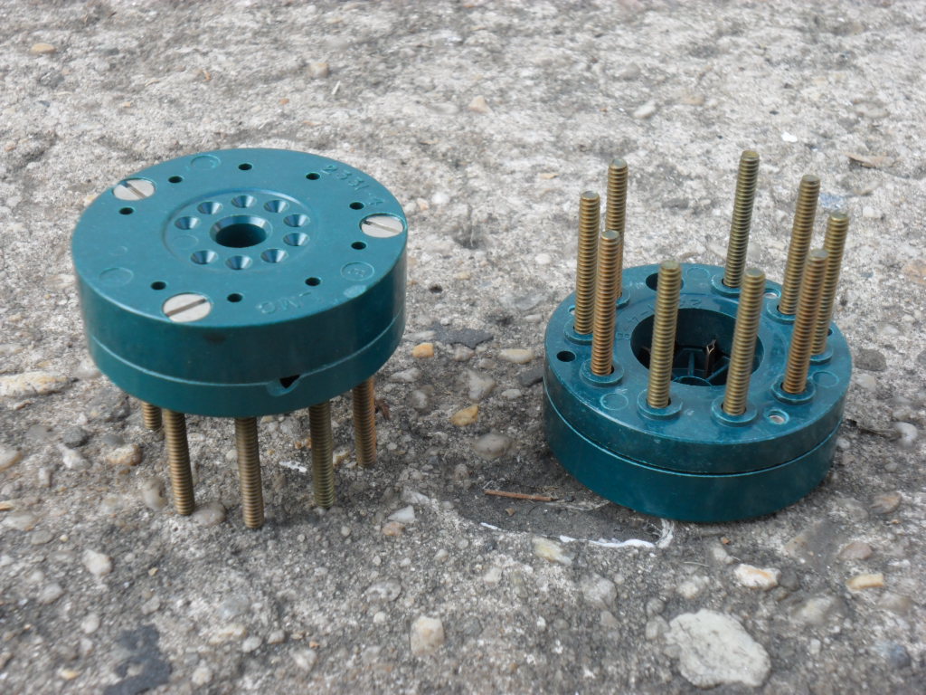

You can also tell if a semi new tube has been used is by the pins.
There will be lines in the pins from putting in and out of the socket.
But afaik, in-factory testing and curing is done before packaging and delivery. So, they get in/out the socket at least two times. That's in a best case scenario. But nice point to look for.
Regarding marks on NOS tube pins, if you see any, they were most likely made after leaving the factory. Manufactures used "production sockets" that were designed for many insertions and removals and left no visible marks. I actually have some of them that I acquired from my friend's testing lab when it closed. And they originally came from the RCA plant in Harrison New Jersey after it shut down many years ago. I also have some of the nice (and expensive) Westinghouse panel meters from there too. Anyway, I found some pictures of one on the web.
