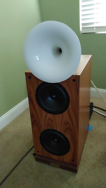

I am using Seas U22REX woofers. I initially bought them as pure bass drivers to use below 140 Hz with a different top module, and they worked very well as bass drivers. However, I currently use horn/compression driver and cross the U22REX at 1kHz at 18dB slope via active crossover, and the midrange is surprisingly very nice, both weighty and fast.
The Curv cone is woven polypropylene and feels very different when touched/tapped from traditional heavier polypropylene drivers. Curv feels stiffer/lighter, less "dead" sounding.
