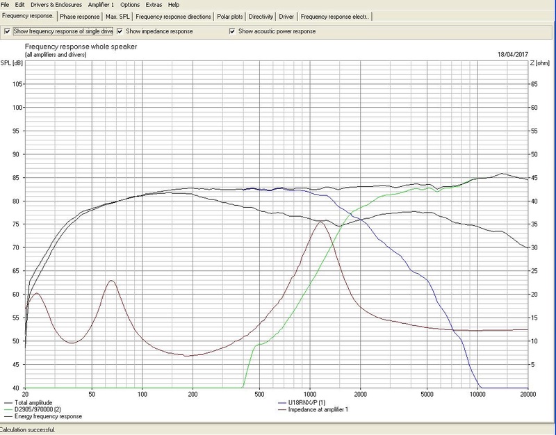

I have realized a 2 way speaker based on seas Idunn, same box, same woofer but different tweeter.
Unfortunatelly I can't make any measurement, but I imported the frd and zma files for the woofer.
For the d2905 I have the measured files.
I tried to realize the system, maintaining the same crossover of idunn for the woofer, but it seems too forward on the mid side.
So I tried to make some simulations, and i found that that the woofer requires a bigger BSC (3,3mH) to compensate the baffle step and get alligned withe the bass zone.
this is the sim, I would like to know what you people are thinking about, thre 3.3mH BSC seems too large.
regards

The SS tweeter and the Seas DXT are totally different animals, so that i would rather try to rework the filter on the tweeter side than the woofer side.
And yes 3.3mh is way too big, suggesting you need to atenuate the mids. Seems to be more straightforward to remove part of the attenuation on the tweeter...

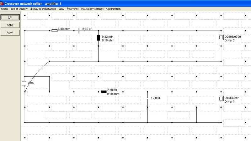

I tried with 2.2mh/10uf on woofer like seas idunn but the tweeter is very difficult.
2nd order 6.8uf/0.30mh damped with 5 ohm series sounds too midy; reducing the cap to 5.6uf there is a dip and also is not good with 3 order. Dont know what to do
Hi Cucicu,
I'm a little worried about the final tweeter tilt. I think 3rd order may work well for you, but the issue I see is the tilt of the tweeter. I don't usually want it going upwards like that. I would make 100% sure that is your desired tweeter tilt before worrying about the woofer.

I seriously doubt that the frd and zma files you are using a any raliable, and what you hear has probably nothing in common with your simulation.
It's the problem with simulating vs measuring: simulating is not a short path to avoid measurments.
If you don't measure, better build a kit.😉

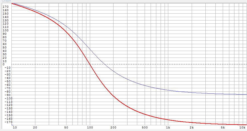

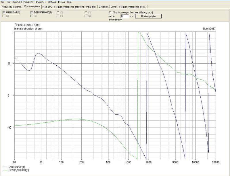

Coils and caps introduce 90 degrees of phase, just in different directions when you view them as phasors. How does Jeff Bagby get 45 degrees difference between a 3rd and 4th order asymmetrical cross over in that post?
The phase difference changes with frequency; it's 45 degrees at the crossover point and increases to 90 degrees as the frequency increases. I attached the phase plot of an example speaker, one with a 1st order and the second with a 2nd order, both at 100 Hz.
Oh okay taking the continuously varying impedance of the drivers you can calculate the phase difference. Crossovers though can only offer orthogonal phase shifts. But blended with the drivers' impedances you get the 45.
Yes, the tweeter has a rising response. Maybe it needs a zobel network?
I agree also about 3rd order on tweeter. Maybe would be better a 2nd order.
