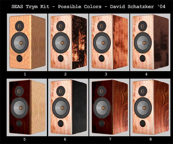

I've (99% sure) decided to go with building a pair of slightly modified Seas Trym speakers (the 22cm excel woofer and the 002 tweeter, crossed over at 1.6k).
Before shelling out for the drivers, i've decided to build the cabinets (the most fun part anyhow [well, maybe 2nd most, i really liked putting the crossovers togeather last time]) - I've sawed up the MDF and am looking at veneers.
I tried out some different color combos in photoshop (see pic - #1 is the picture on the seas web site), and I think that i'll go with #8. The back is rosewood, which I ordered in an auction, but I'm not sure what wood would be best to use for the front, to get that look - any ideas?
A question also, about the seas speakers, and this one in particular: how will they likely compare to commercial designs? I havn't listed much to many high end speakers - the set i've heard the most is the B&W CDM1-SE (their second-from-top range, i believe) - those speakers cost more than twice as much, and have smaller (6 inch or so) woofers. Any ideas how the seas speakers would compare?
Also, one last Q (so excited, so many questions!): Looking at the seas sensitivity plots (for the different kits), i see that the Trym is slightly less even than the others - does this mean that the sound quality will be inferior, and if so, how signifigantly? I assume there is more to the sound than the response plot - right?

Well, The Seas Excel range is considered one of the finest available, but the woofers are tricky to use, so using an established design as you are is a good idea. They should seriously good!
I liked similar or the same veneer on the front and sides.

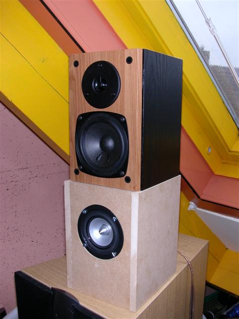

Stylish speaker...
The cherry front on yours turned out close to what i was looking for - perhaps thats what i need ...

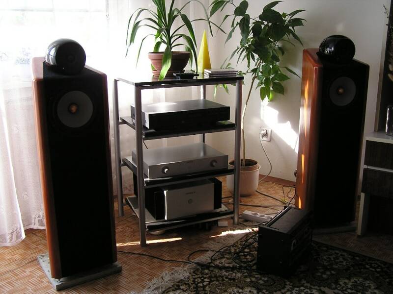

Please find enclosed my modified SEAS Trym speakers. The picture is too dark(bad quality). Now I am going to rebuild them to active. For about 4 weeks I should have finished the new amplifier with built in active crossover(on the lowest shelf of rack).
Those look AMAZING, honestly some of THE finest DIY speakers ive seen to date.
I bet they sound amazing. Is that cabinet sealed or vented? and what volume are they, interesting to see how much you changed the original design.
michael
The volume, vent, woofer ...are the same. Only the shape is different. The vent is on the rear wall. The used tweeter is T25-001(not 002). It is much cheaper then the millinium(in quality there are no big differences- In my opinion).
I think the volume of the box is little big for my room. I have some problems with low freq.
FM
