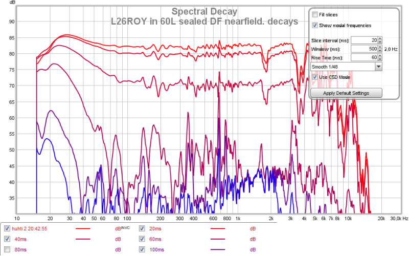

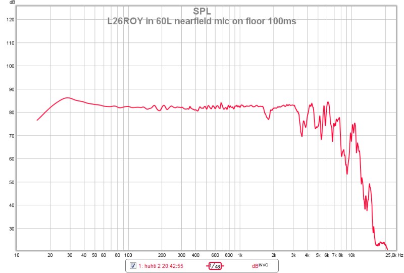

Yep, my nearfield measurement in a 60 liter cabinet ( a too big protocab), downfire. Measured with mic on the floor at the edge of cabinet. a 25liter is ideal, Q=0.7. The motor is very strong and when driven without a coil, cap etc with a Dclass amplifier with DF around 2000 - a beast for it's size! :deer:
I recommend a sealed cab, place near the floor and trust on floor gain! No eq needed!

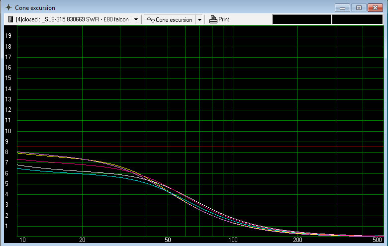

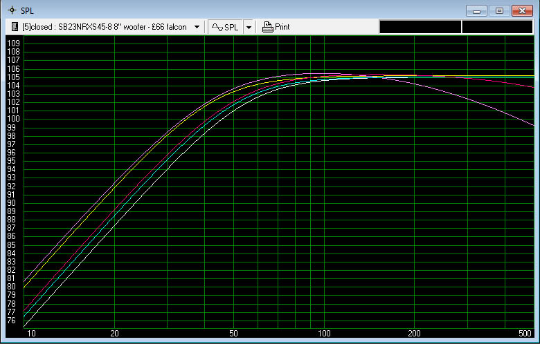

Well I plotted some drivers, all just with sealed enclosures of Qtc=0.7 just to compare. A couple of the drivers are what have been recomended and I chose two 8" ones that looked promising just to see how they match up. Working from higher to lower frequency drop-off, the:
# White line is the 10" SEAS L26ROY in 20L @ 65w - £145
# Blue Line is 2x SB acoustics 8" SB23NRX45-8 in a total of 80L @ 23w - total of £130
# Red Line is 2x Peerless 8" SLS 830667 in a total of 90L @ 35W - total of £110
# Yellow Line is the SB acoustics 12" SB34SWNRX-S75 in 47L @ 65W - £135
# Pink line is the 12" Peerless SLS-315 830669 in 150L @ 30W- £80
(the ones that drop off at higher frequencies have the advanced parameters entered, the ones with flat response just have the standard ones, so ignore the higher drop-off, it isn't comparable)
So, all are within X-max for the respective drivers at the SPLs plotted, some 'well' within. Prices are 'fairly' similar except the peerless driver (suggested above) which is usefully cheaper - though it also has the biggest enclosure requirements. The 12" drivers clearly perform well and go usefully low. But it seems less likely for a 12" to have as smooth an upper frequency response as the smaller and very rigid-coned L26 ROY, so without lots of support for that I'd be nervous of using them in my application. The two 8" drivers seem pretty comparable (when paired) with the L26ROY, the differences seem mainly that they need a much larger (total) enclosure than the single ROY (and the ROY needs more power, but thats not really an issue for me). Being only 8" I'd have reasonable confidence in their distortion being low up to the midrange x-over point. There are certainly other 8" ones I could try simulating too, these are just to get a feel for the differences.
Probably what may swing it is the x-max. There's not a massive difference between the drivers in the cone excursions, but the two 8" drivers are close to their X-max at the SPLs plotted, whilst the ROY is barely half way along its linear travel - which should presumably mean its going to be pretty untroubled in terms of distortion. It will also give me more scope with the volume knob; I've plotted this for around 105dB which i'd imagine would be enough, but as an upper limit theres no harm in having a bit of headroom, possibly even some gentle eq if I later feel the need after building it.
Do these conclusions seem reasonable?
