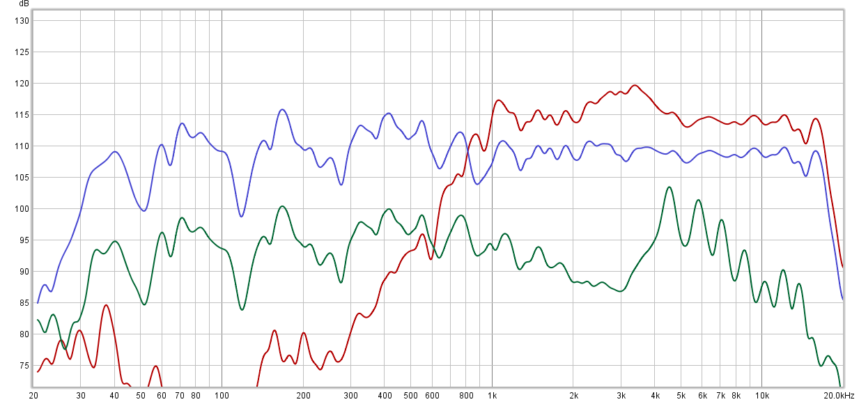

Installed the drivers, and took some graphs. These are in-room, mic at about 1m on axis with the woofer, cabinet back to the wall. Nothing calibrated, but the mic is flat. Should be pretty obvious which curve is which. The HF section will be fairly easy to work with - just needs a shallow notch in there to get the 3.2kHz peak down to flat.
The full-range response is just something I threw together in DSP so I could listen while I assembled the second speaker - 1kHz low- and high-pass, plus an EQ filter to drop that 3.2kHz peak.

It looks like the smoothing applied to the graph smooths the cone resonances. You could try to use less or no smoothing when setting the DSP notches.
The only DSP notch was on the HF driver, to smooth the 3-4kHz range.
The crossover filters I'm using are Powersoft's "FIR" slope, which I set for 1kHz. It's 24dB down at 1.4kHz, so I think that's enough attenuation for the woofer's peaks.

Yeah the 4.5kHz breakup needs a 4th order @ 1300Hz or lower so with the DE250 you'll be fine. The breakup of the 4.5kHz creates a peak in the 3rd order hamornic distortion of a similar magnitude to the amplitude peak in the frequency response.
So a 1.5kHz HD3 peak with a potential rise of 18dB. Your xover being 24dB down at 1.4kHz should be perfect. With that low xover you've basically handled all the issues metal cones have.

Looks like I need to try some high-level sweeps. At the levels I tested at (comfortable in my living room), the distortion profile appears to be flat, but also very close to the noise floor.
