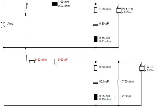

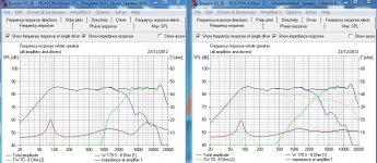

Hei Jouko,
sreten is trying to explain the concept of "design axis" which is practically never 90¤ to the front plane. Usually this axis is at tweeter level measured 1 or 2m from the speaker. If you increase distance, the optimal listening/measuring level is higher and vice versa (supposing the tweeter is above the woofer). How and how easily the effect of this is heard depends on many factors.
One issue of Idunn is the booming of 2 kHz area despite of the claims of not happening. Check the attached graphs of Idunn and MarkK's ER18DXT, which is better (different scale). ER has 2nd order xo instead of 4th of Idunn - thus the tweeter plays earlier in frequencies.
The graphs are copied from these original pages
Idunn
The Seas ER18DXT ported two way

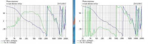

Hei Juha,
thank you for your informative remarks. I am still in the process of learning the
theory and terms of loudspeaker design😕 Being retired I have more time but the transformation from a legal background to acoustics and related electronics will take some time.
I fully agree with the 2Khz boost based on the graphs and it is even more visible on the woofer graph of the manufacturer. I need to listen first and then come back to find out if there are ways to filter it out without spoiling the good sides of the consept. Again, looking at the graphs it paradoxically seems that the Idunn should sound best from a 30 degrees angle which the tweeter is able to handle pretty well.

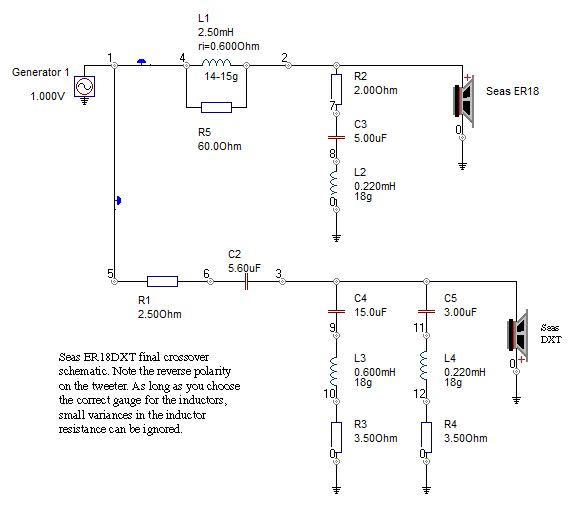

And here is Zaph's graph of vertical polar pattern that I wanted to show
System7, can you please specify the ER18DXT tweeter notch problem?. Mark says that he used the two notch circuits to achieve acoustic 2nd LR. XO is electric 1st order an drivers' own roll-off makes acoustic 2nd LR.
By the way I made Zaph's LR18 first but was not happy. Then I used that box and converted it to ER18DXT and now I'm happy (avatar pic). Zaph himself has said that MarkK's speaker is an upgrade to his SR71 which uses the same reed cone midwoofer. The L18 has conventional LR4 xo and a quite bad horizontal dispersion by today's standards.
Also I'd like to thank You sreten for your wise and nice writings here at diyaudio.com!
Juha

Juhazi, you are hijacking the thread with too much discussion of MarkK's ER18DXT project. 😀
FWIW, MarkK and I had a heated and interesting discussion of the supposed advantages of his "First Order" DXT tweeter filter here:
http://www.diyaudio.com/forums/multi-way/220694-erse-inductors-europe-3.html#post3185582
In practise it turns out to model almost identically to the much simpler third order DXT tweeter crossover in the SEAS Idunn. That is when it is accurately and properly executed, which his IS NOT! 😀
His filter and speaker is goodish overall, but not for the reasons he thinks. Too much Snake Oil in this game. It doesn't make me popular to point this sort of stuff out, but someone's got to do it. 😉
Typically a 2-way with 2nd order LR xo, the polar
radiation tends to be tilted to the woofer's side.
Juha
Not if you make the output purposely slightly assymetric
for both LR2 and LR4 acoustic to tilt the optimum axis.
Here is an example of assymetry to fix path length differences :
My RS180 MTM Design
Note the perfect phase wrap at the x/o point.
rgds, sreten.
