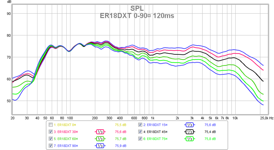

I have those too, with xo built as per MarkK's recipe. Have you measured the response? To which speakers are you comparing the sound to ? I think that the sound balance of mine is just right, but my sons say they are shy on bass...

I'm using the DXT in a 3-way project. The tweeter is very sensitive about front baffle design. Below is the off axis measurements of the ER18DXT from Mark K's website (hope it's okay to post this part) with a more "informative" scale (0.4-20kHz, 10dB per section):
As you can see there is (in my opinion) way to much energy between 2-5kHz if you sum up the on axis and off axis measurements. The on axis measurement is nearly flat, so the off axis sound pressure rise between 2-5kHz is a result of the front baffle design.
regards, haf

haf, I can see the same in my version, which has sightly different baffle dimensions than MarkK original. That hump is obviously a bit higher now.
Because of low xo it is not compensated by vertical off-axis interference.

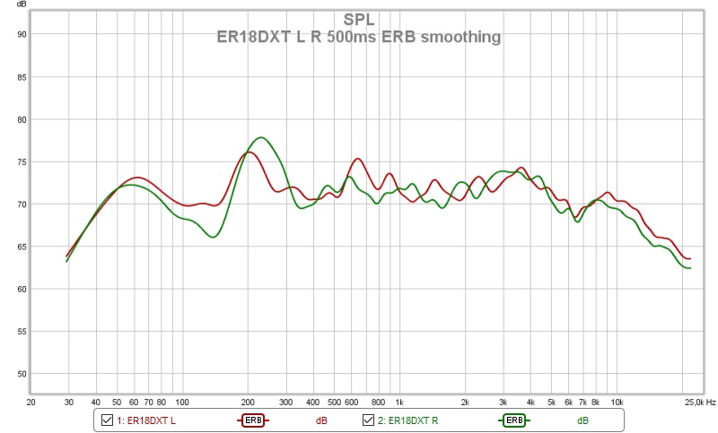

Here my room-response measured almost 3m from the speaker
Overall sound is a bit on "clear" side rather than dull.
The measurements show exactly your listening experience.
Voices and distorted guitar could sound shrill. The dip at 7kHz could cause hi-hat and cymbals sound a bit dull/thin.

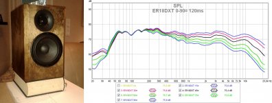

This is my version, the box has bevels on sides but xo is per MarkK
@Juhazi
It's not bad at all.
The hump is consistent on all axis/off axis measurements, so it seems possible to adjust the xo to get rid of the hump.
By changing the front baffle dimension (and chassis position?), in most cases, at least the adjustment of the notch filter is necessary.
