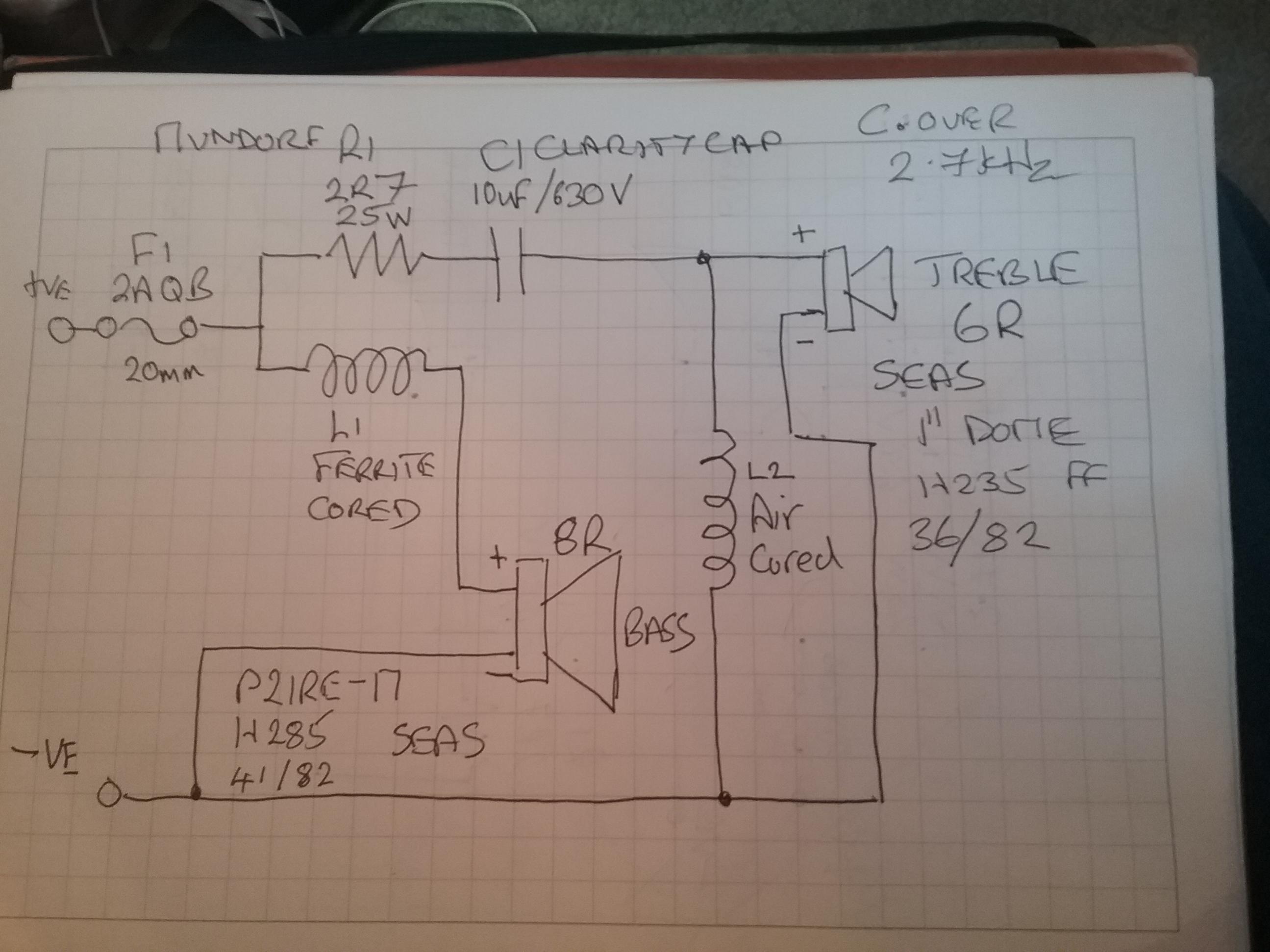

Looking to work out values of inductors on the crossover. I know the resistor and cap value as I've updated those. I know the impedance of the drivers but not at the crossover frequency of 2.7KHz.

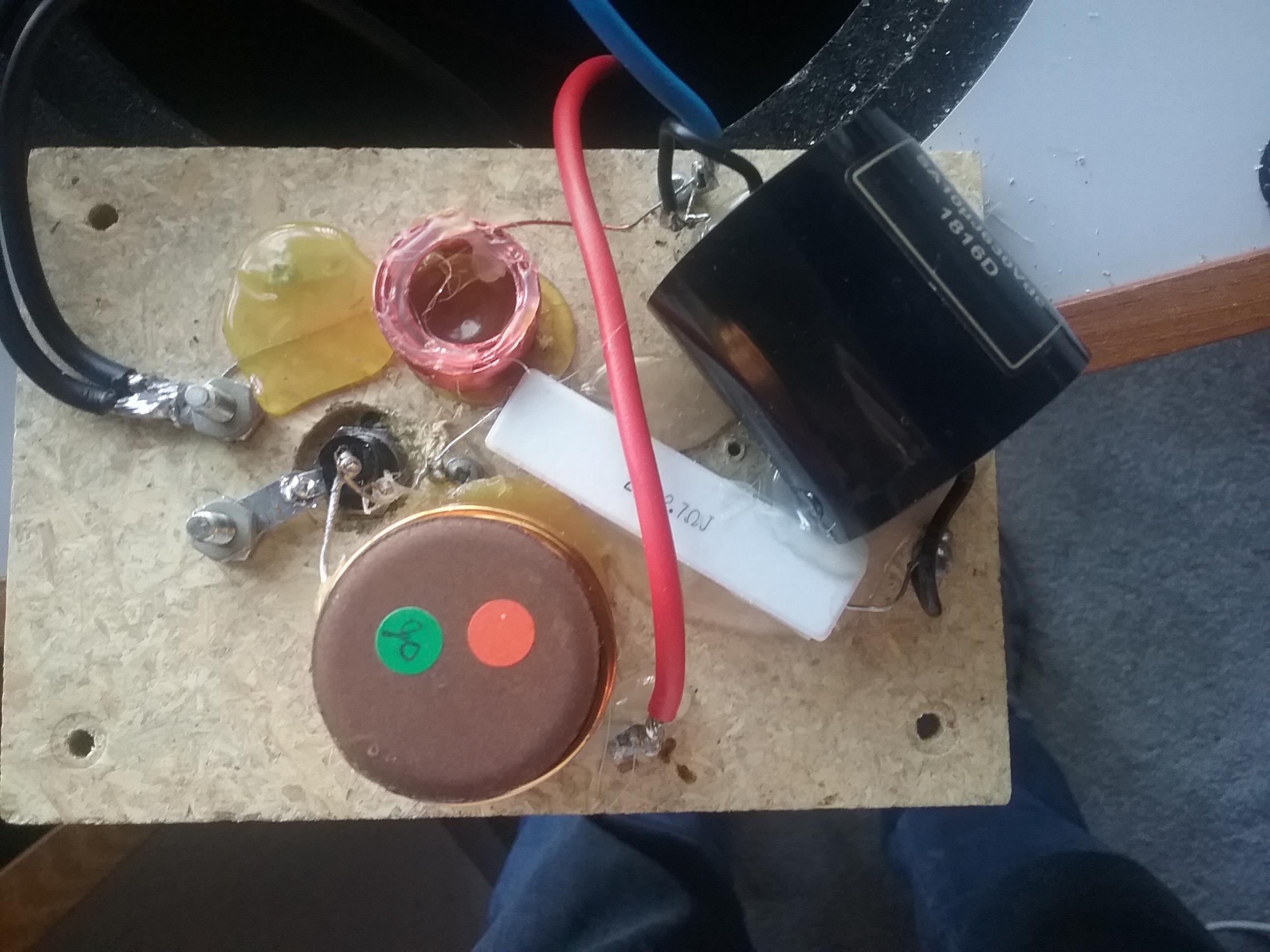

Cheers Steve. I updated the resistor and cap a couple of years ago. From basic to Mundorf wire wound in ceramic 2R7 25W and Clarity Cap 10uf. I was just thinking of updating the coils but can't get to the required values. I've attached a pic and the circuit diagram I've drawn out whilst I was replacing a broken fuse holder. I also was wo dering if the coils should not be in the same orientation but at 90° to each other?

I fail to see how you can update a coil. A coil won't deteriorate over time so there is no need to change it. The only problem that a cored coil can exhibit is the saturation, but this problem is grossly overemphasized because any sensible mfg will use a cored coil that won't saturate in normal conditions.
The reason that Mission used an air core coil for the treble and a cored one for the bass is:
a 0.x mH air core coil used for the treble is inexpensive and cost equal or less than a cored coil with the same inductance,
the bigger coil used for the bass (>1mH), has a way lower DCR if cored vs air at constant AWG. To match the DCR the wire diameter for the air core coil should be bigger, and the coil will cost more without sensible performance difference. Just as an example, a 2.2mH coil with a 1mm wire, has a DCR of 0.8 Ohm if air core, and 0.34 Ohm if cored, and only an air core coil with a 1.8 mm wire can match the 0.34 Ohm DCR, with more than 1 Kg of copper...
If you want to replace the cored coil, you need to match inductance and DCR. The only way to know those values is with a measure, a datasheet won't tell you nothing. The easiest way is with a multimeter, even a cheap one will do the trick, but IMHO changing the coils is useless.

Hi Steve. I've been reading another thread that you commented on a lot in relation to the crossovers of 770 in response to Slipmyster from 2014 onwards. I think I understood in 1 post that you thought there was a better crossover design to use. I know Slipmyster changed the tweeters. I have retained the original SEAS drivers. The circuit is currently as attached.
