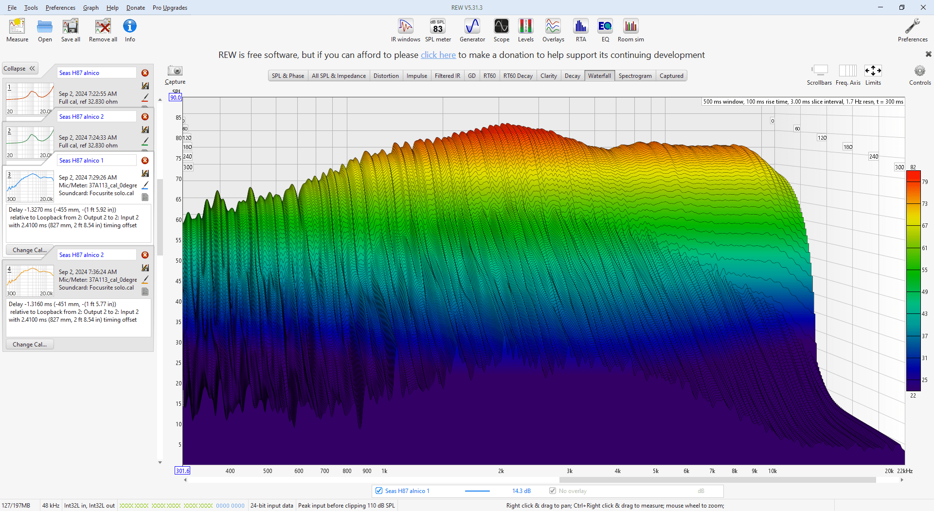

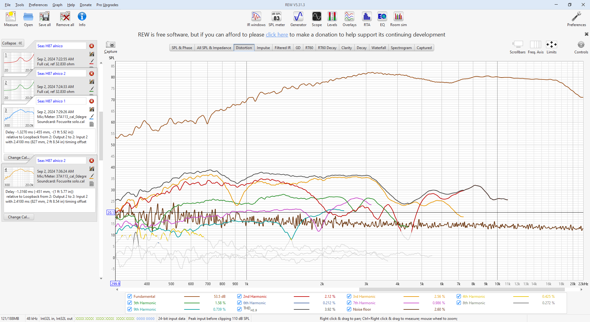

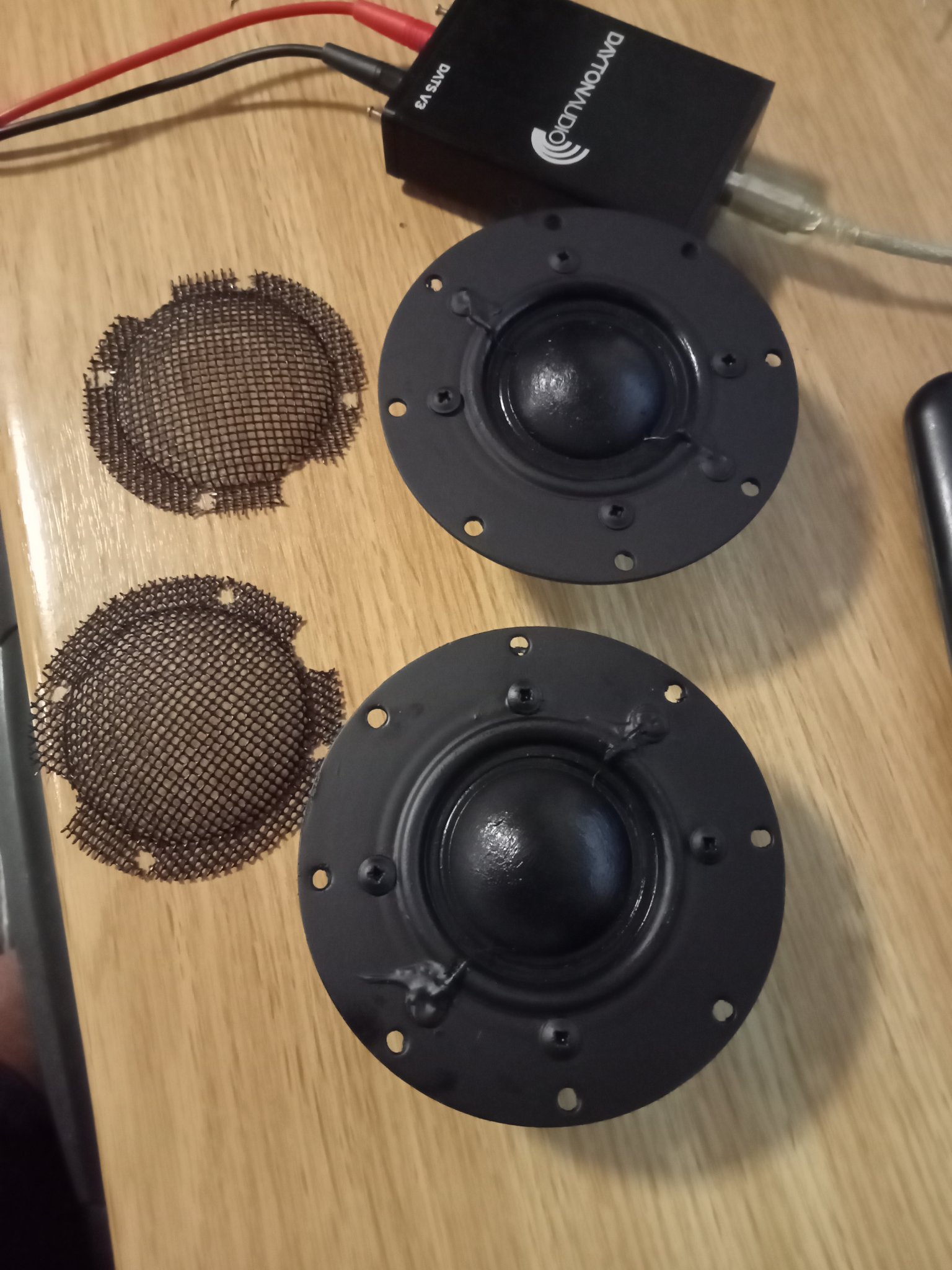

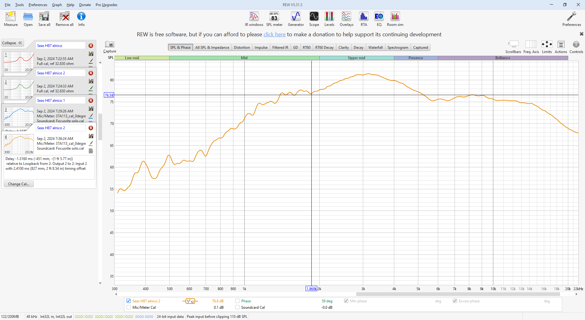

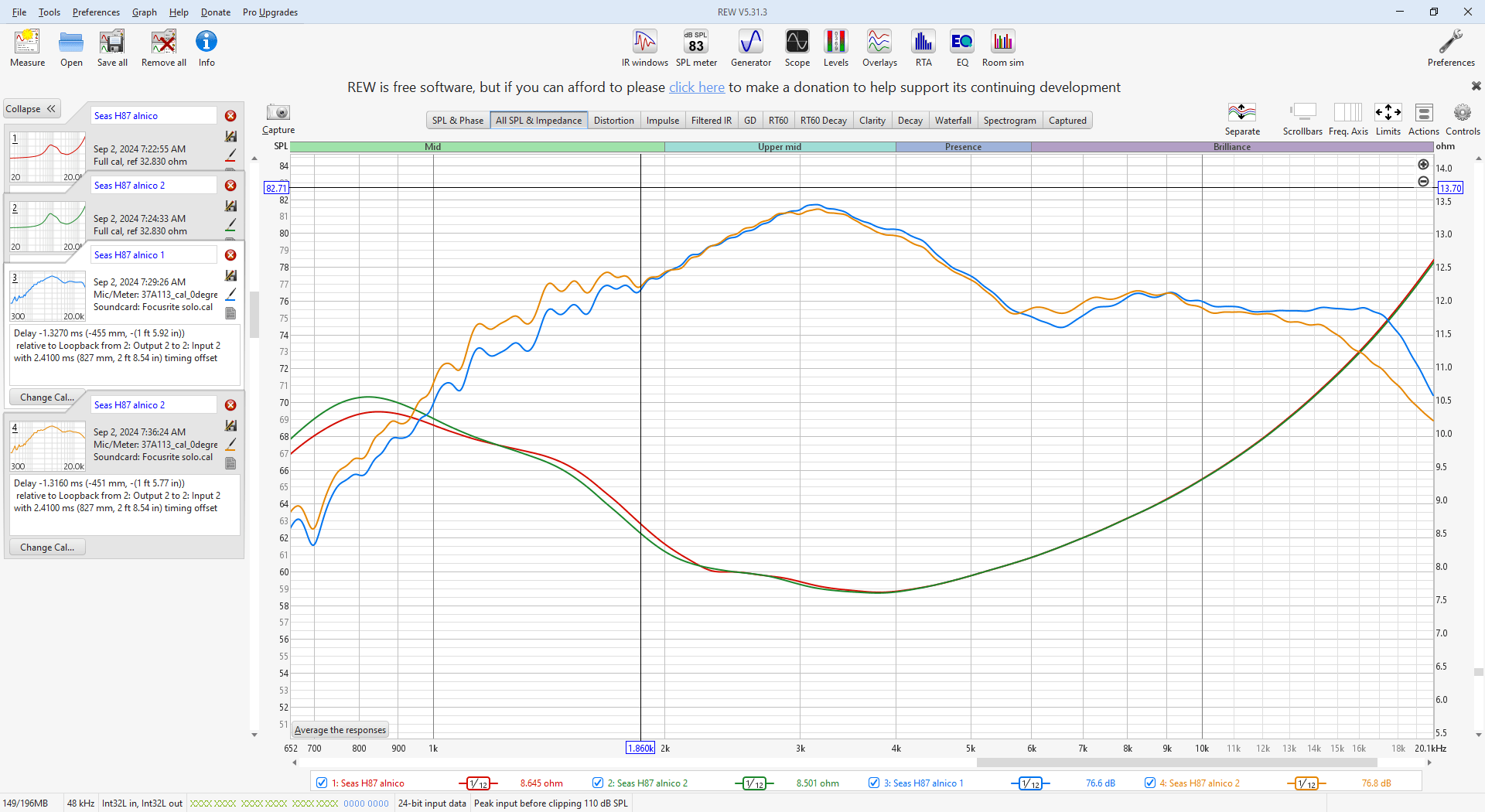

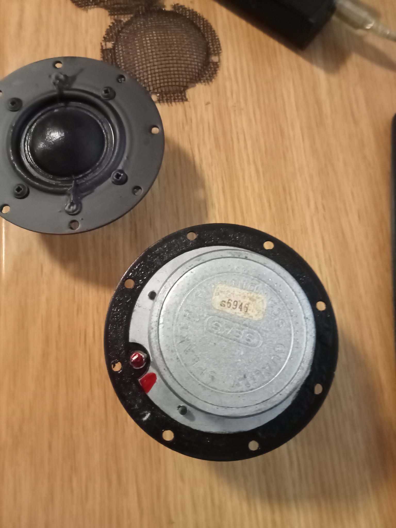

Test seas h87 1969, disassembled and centered with Arta/Limp and dats v3, for their age they are very good, we are looking for these mid/tweeters for something fullrange alnico, about the same age, I want to build something omnidirectional only with old speakers, for amplifier on lamps.
