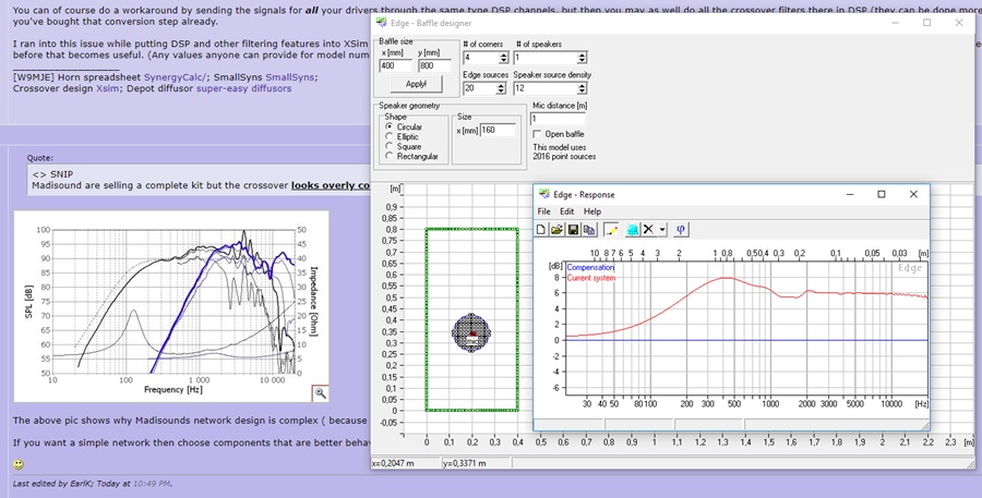

Madisound are selling a complete kit but the crossover looks overly complex to me.
The above pic shows why Madisounds network design is complex ( because it needs to be to hammer that mess into something linear )!
If you want a simple network then choose components that are better behaved within their pass bands ( & stop bands ).
Yes it looks challenging.The big peak at around 4-5k looks especially troublesome.
Perhaps the first approach would be to try less steep crossover slopes and just see how it sounds.A bit of uneven response in these point source type drivers may not be as much of an issue as in more conventional types.I suspect the older Tannoy dual concentrics do not measure perfectly but that does not stop them sounding very good.

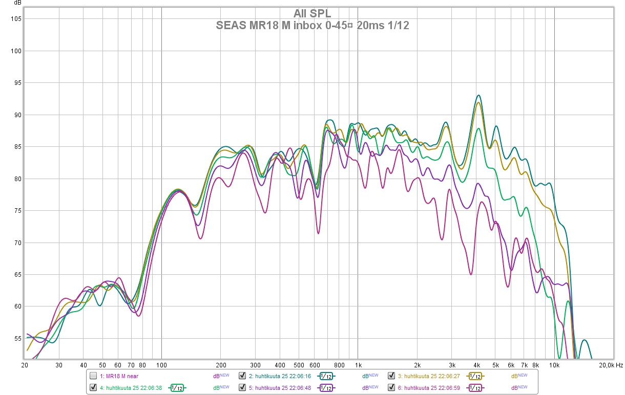

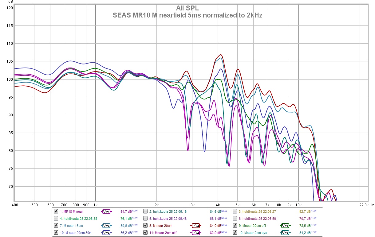

So, now I have a pair of MR18 in my hands! My plan is to make a semiactive 3-way using it and SB29NRX woofers, floorstanding sealed box and minidsp PowerICE-125 amplifier-dsp boards.
Here are my first measurements of MR18 in a 7 liter closed box, baffle 19x28cm. We can see from nearfield measurements, that the peak at 5kHz is NOT exactly cone resonance, but more like a cavity resonance based on geometry. Look how nearfield off-axis measurement changes in normalized graph!
Looks like the tweeter shows directivity only in low treble and is exceptionally non-directive up to 10kHz. Crossing around 2,5 - 3,5kHz should be ok. Peak attenuation at 5kHz is perhaps not needed at all. Lower xo around 400Hz LR2 should be easy too.

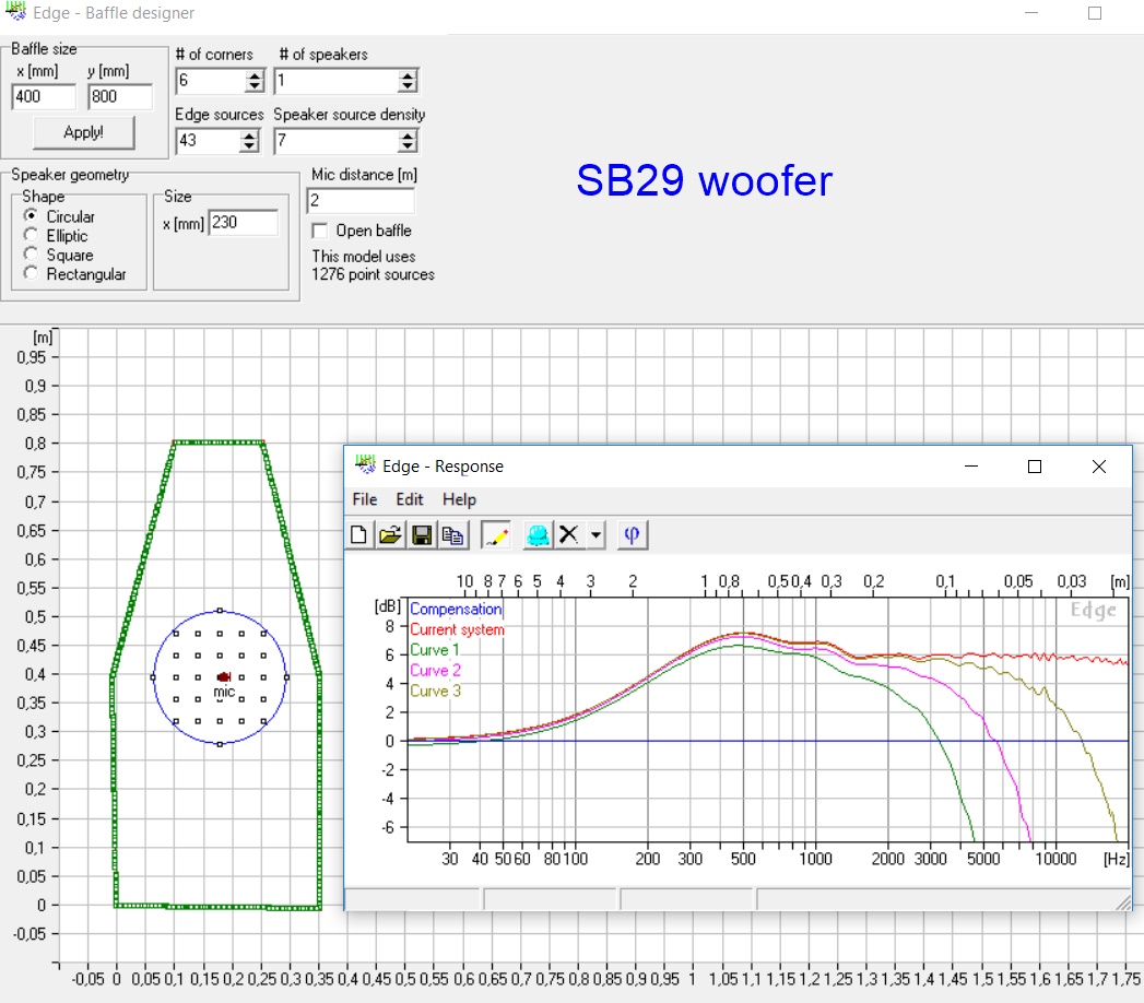

Here some Edge simulations and a 3d sketch of the box. Top part of the baffle will be tilted and I will add diamond cuts to edges following the style of Avalon speakers. Box material will be MDF with birch veneer, tinted and waxed. These speakers will be a joint project with my older son.
