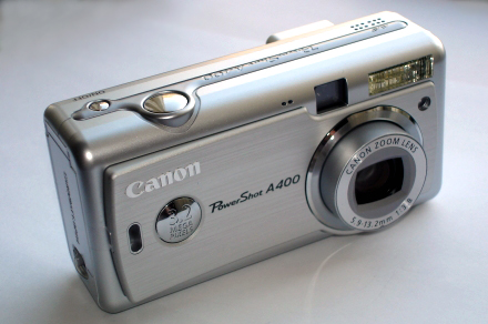

I bought a new Canon A470 7.1 MP camera in early 2008.
http://best4digitalcameras.com/files/canon-red-digital-camera.jpg
I had gotten later an old Canon A400 4.x MP camera for free because it was broken.
http://www.ferra.ru/images/170/170416.jpg
It had printer ink spilled on it, so I took it apart and cleaned out the controlls and cleaned the contacts on the ribbon cable for the little LCD screen. It worked perfectly after! It took beautiful prictures.
A friend of mine in Luxembourg didn't own a camera so I sent hom the A400
and kept my new A470. He loves it, and he is very thankful. I enjoyed fixing it, and I am happy a friend can enjoy using it.
The A470 ATE batteries, I blamed the rechargable batteries, but later on I read no, it is just a PIG.
This was after I sent the A400 to me mate in Luxembourg. The one I sent him was good on batteries. Oh well.
