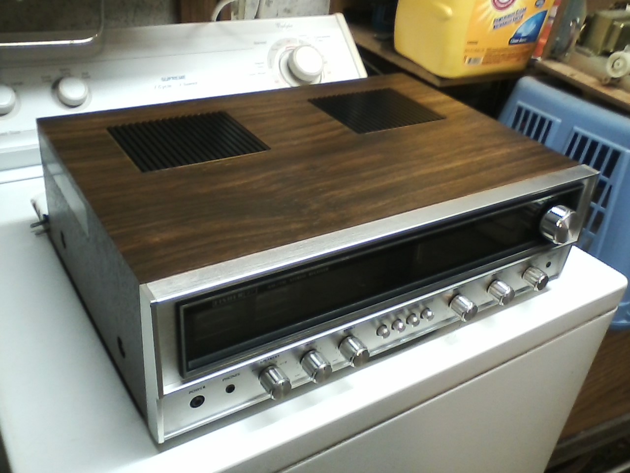

I was given an old Sears/Fisher receiver the other day, its in great physical condition but it won't so much as light up. The Sears P/N is 143 92533800.

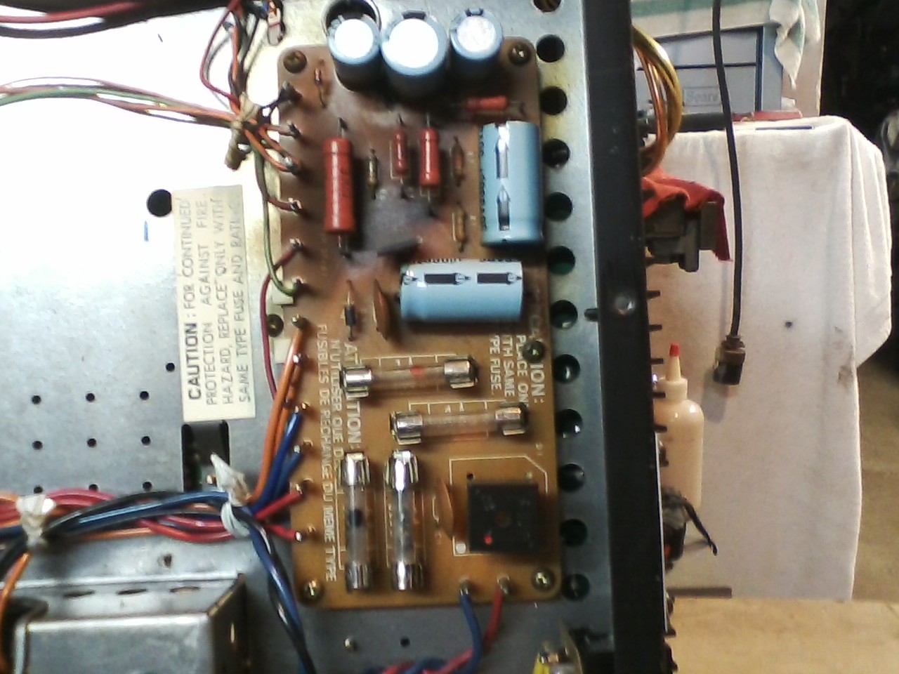

I removed the top and bottom covers and found two blown 6 amp fuses, these are on a small circuit board with the rectifier. The board is badly discolored and one transistor appears to have gotten very hot. The fuses blow instantly on power up.
I did an online search for this model and came up empty as far as a circuit diagram or manual. It uses twin STK082 amp chips so I'm guessing its around 32 wpc. This also leads me to believe this was likely built by Sanyo for Fisher.
Does any one have any pointers as to how to go about fixing this thing?

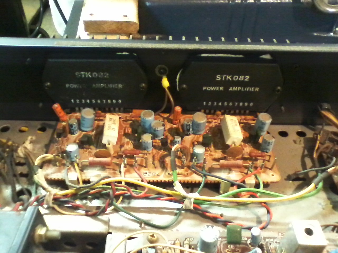

Considering the blown fuses, its most likely that one or both STK082 hybrid power amp. modules has also fried. These are replaceable with refurbished (very dicey), copied versions (soewhat dicey), pulls (maybe good if the source properly tested them) or NOS parts (no, don't believe it).
A good, economical and DIY friendly alternative is to remove the hybrids and the rest of the damaged power amplifier section and replace with a current Chipamp design such as LM3886 based modules, kits of parts or just the PCBs. These are cheap, plentiful and work just fine as long as the scant information you get with them is sufficient for correct connections and you have an adequate power supply and heatsinks to suit the same power output as previous, which you'll need to control by the maximum amount of input signal fed to it. If you aren't careful with this, the amplifiers may deliver too much and the little power supply overloads and the fuses blow, before the inbuilt limiting of the chipamp can kick in.

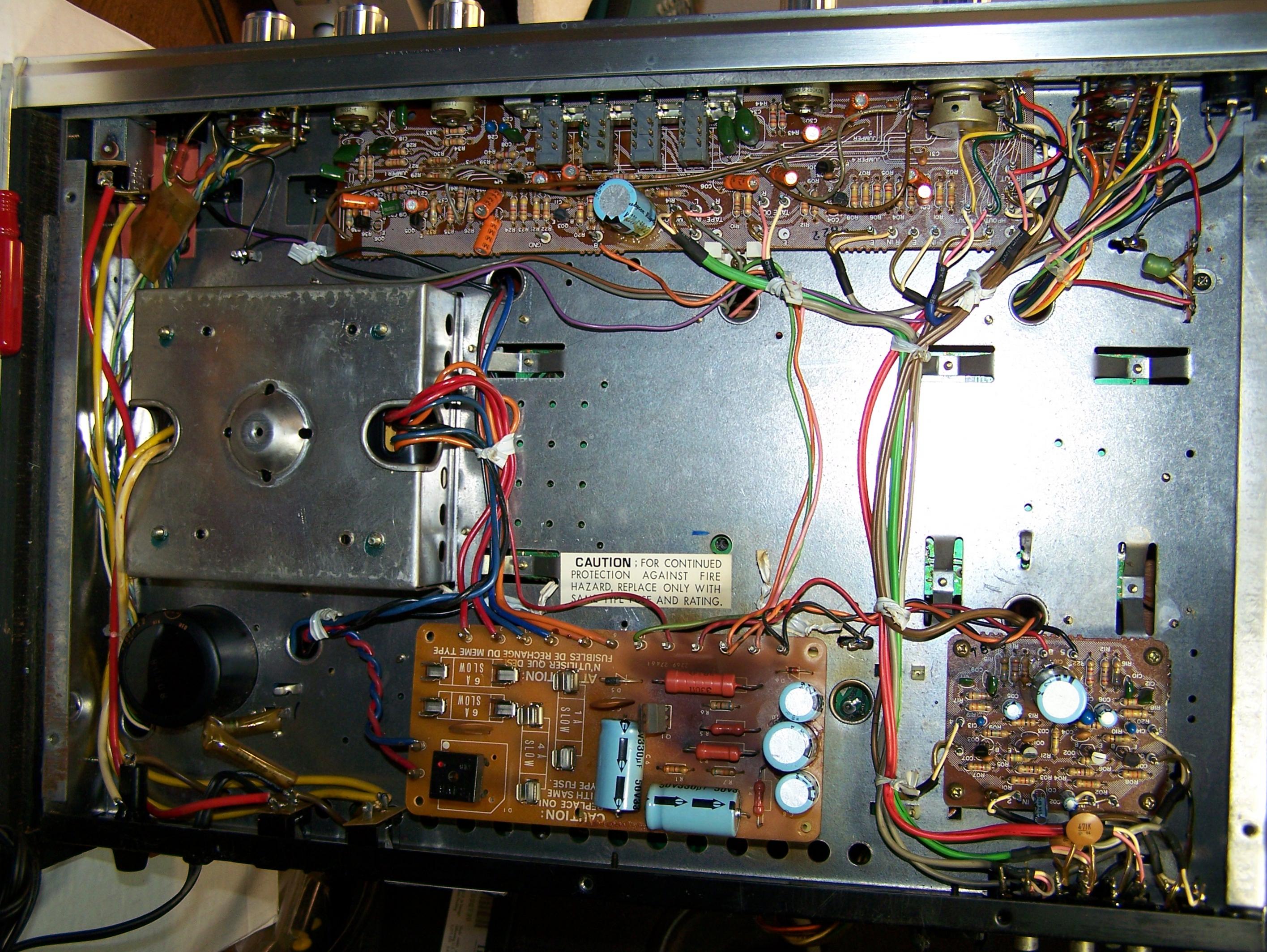

The two 330uF caps on the p/s board are the largest normal looking caps in the whole receiver. There is a 3 pin capacitor in one corner that sits recessed into the chassis with 6 wires on it. There are are few numbers on it and some Japanese writing but no values I can see other than one marking reading 85°C.
Am I correct in thinking that this board is what supplies power to the rest of the receiver?
The two largest wires on the output side of the transformer appear to go directly to the pair of 6A fuses, then from the fuses to the rectifier.

There is no sign of heat or burnt pins on either chips, the blurred lettering on the left chip is from me touching it, they both have a coating of something sticky, when I touched the chip, the paint wiped right off. I had pulled both chips back to add some fresh heat sink compound but the original grease was still soft. I wiped them off and replaced the grease anyhow.

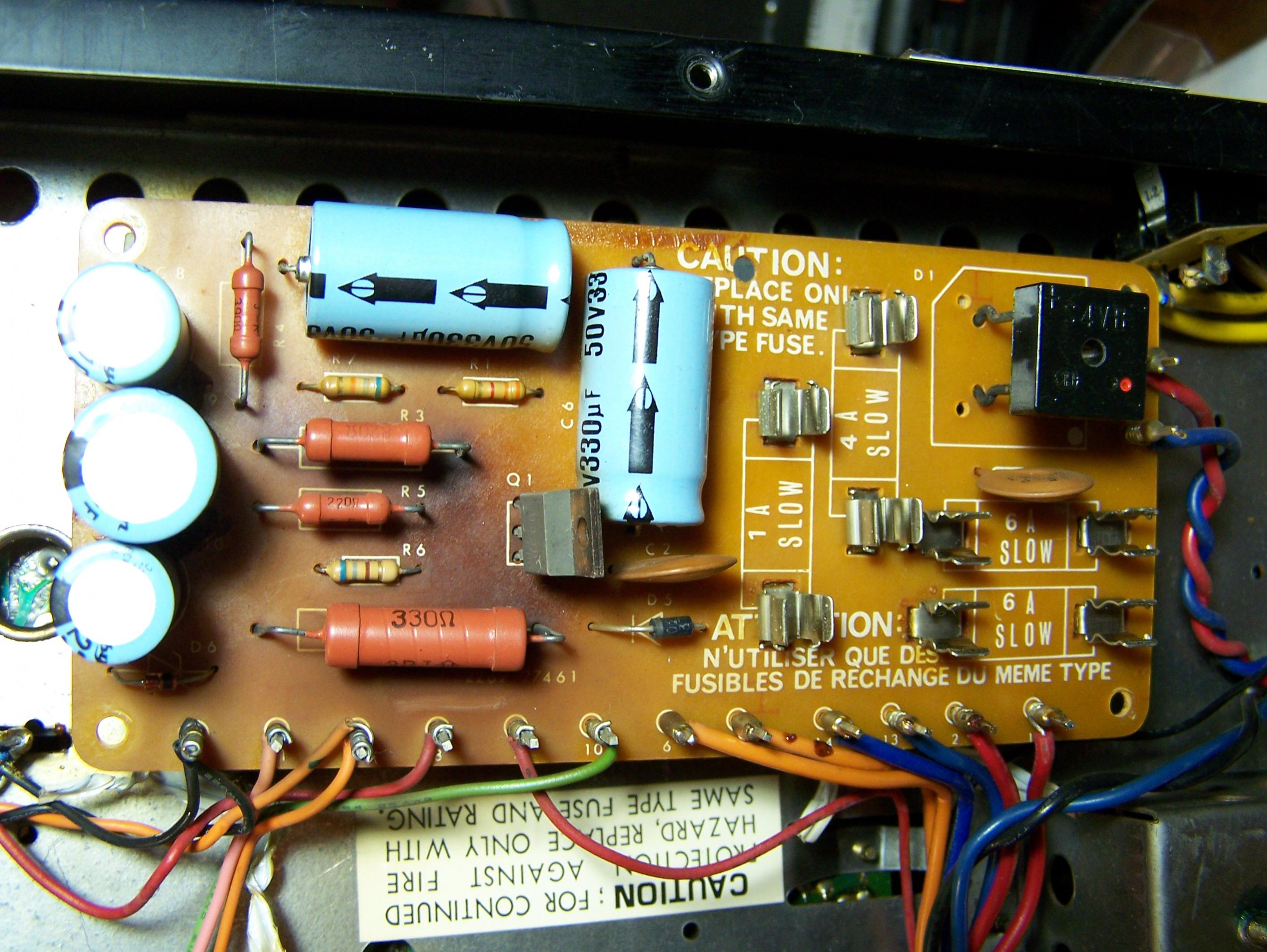

What's all that black on the power supply board? Is it just from heat from the power resistors or is something blown up there? Looks almost like a disk ceramic cap blown up, hard to tell from the photo though. Looks a lot like lightning damage.
All that black is in front of the D330 transistor, the transistor is badly discolored as is the wire wound resistor facing it. The burn and discoloration goes right through the board and it left a burnt mark on the metal chassis above it as well.
I don't think its lightning damage, it more looks like an area that's been exposed to a lot of heat over time. A quick flash of heat wouldn't 'cook' the circuit board so deeply. The transistor looks like it was in a fire for a hour. The aluminum tab on it was burnt and turned colors from heat, but not melted and there is no other physical damage to the transistor.
All three legs of the transistor are shorted together, in all directions at all times.

Several of the caps on the burnt board have something leaking from them, it looks like brown tar. Those caps have no capacitance and only a few ohms of resistance. Only one of the 330uF caps tests ok.

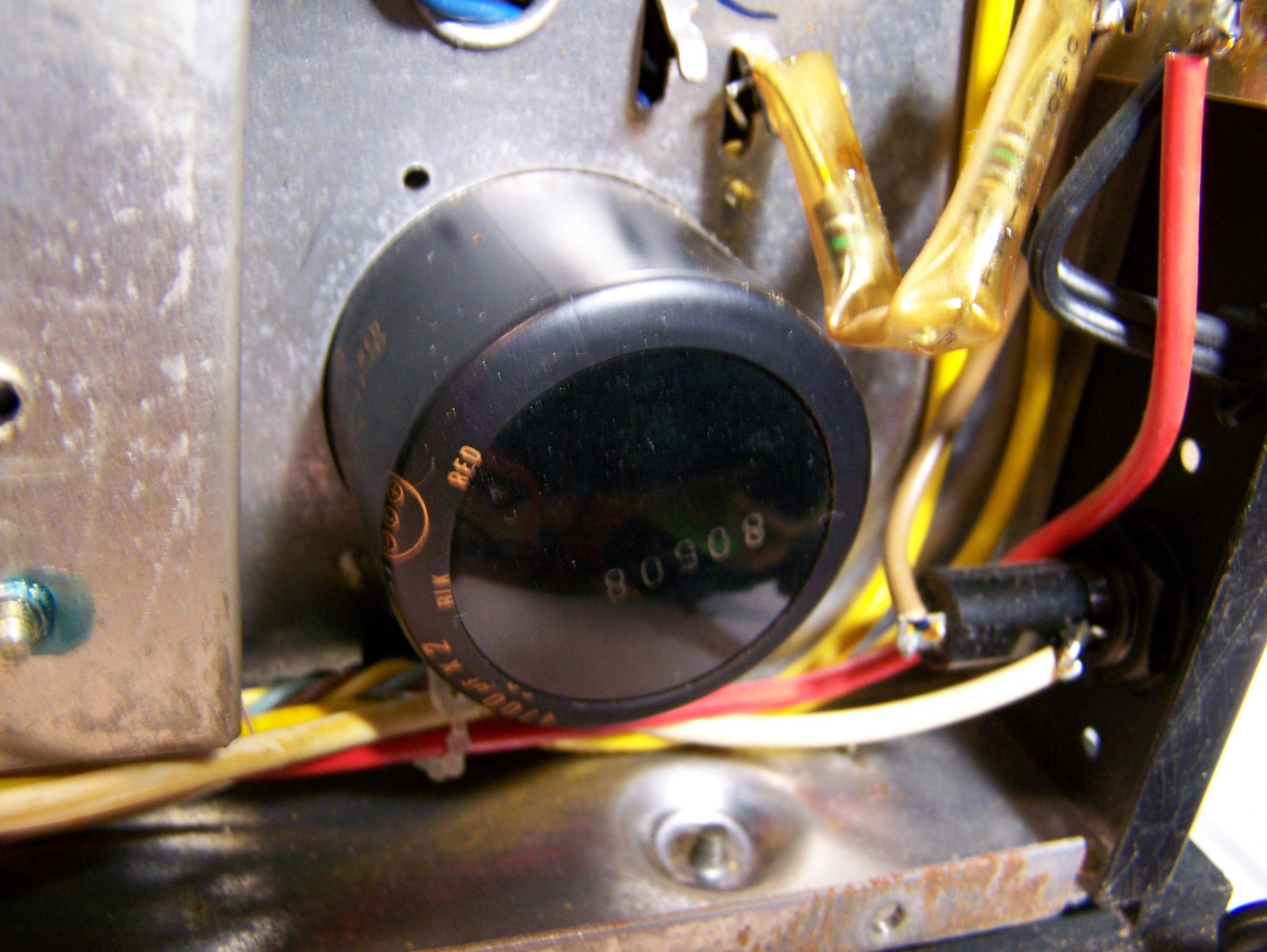

The only larger cap is a single three terminal can in one corner of the unit, I have no clue as to what its specs are as its not marked in anything but Asian script.

The heat damage on the power supply board is very localized. I would think that if a load high enough to produce enough heat to make this kind of burn mark was present in the amp board, it would have melted wires or shown some signs of burning elsewhere?
The burn mark looks as if someone held a flame in that one spot for a long time. the surface of the surrounding board is burnt like firewood, but the trace on the other side is unhurt. It almost looks like the transistor got red hot.

If you look at the pic of the burnt board, all of the heavier insulated wires on the right side go to the secondary side of the transformer, the two black wires are the primary side wires, also connected to one receptacle on the rear of the unit. The red and blue wires are the higher voltage, orange and blue gives half voltage. No power is making past this board with the fuses blown, with the fuses replaced, with low voltage applied, I can follow the voltage to the rectifier, where it stops, nothing beyond it. AC volts go in, nothing comes out, as the volts increase, it gets warm and pops the fuse pretty fast. I'm thinking I need to start with fixing the obvious damage first, a handful of new caps, a new transistor, a diode, and probably a new rectifier. Then see what happens as I bring up the voltage and try to get it to power up. If it needs amp chips, I guess I'll borrow a pair from another unit for now.

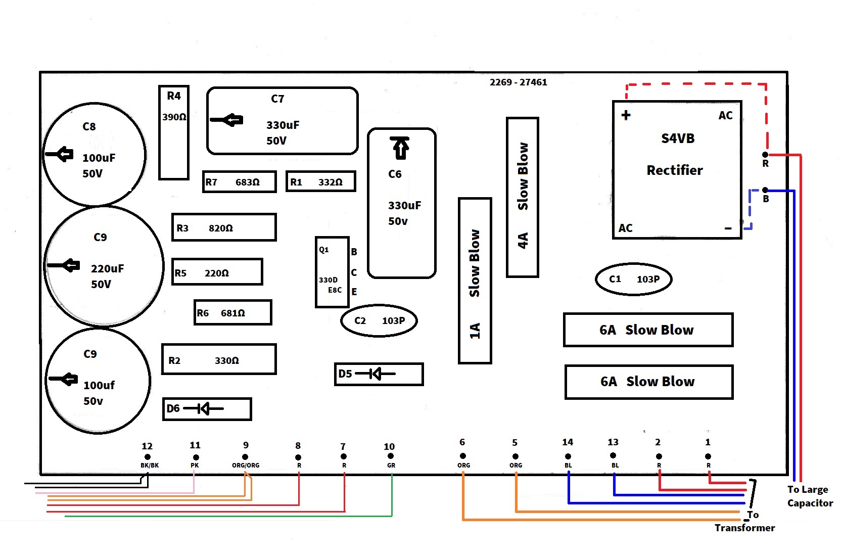

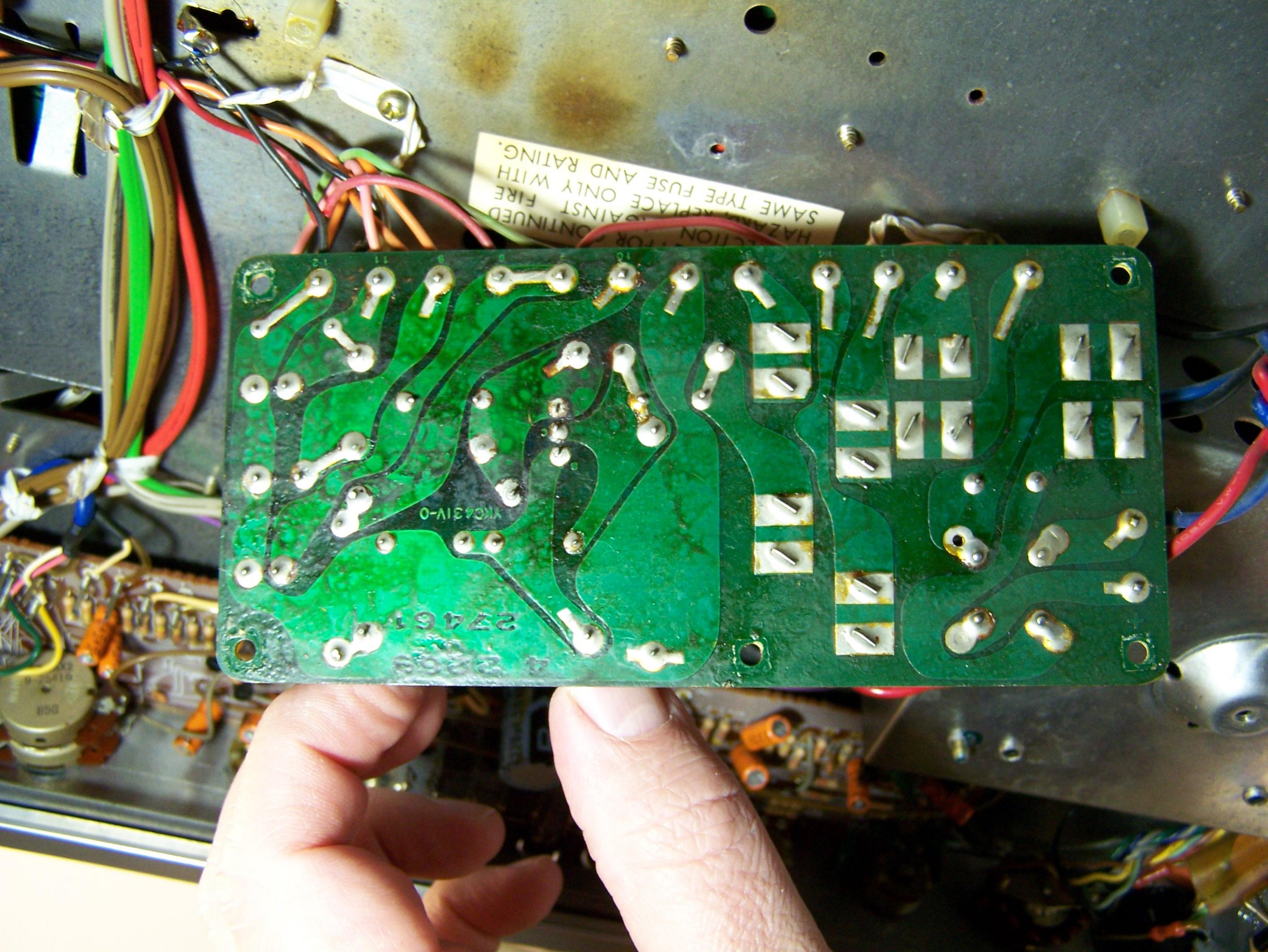

I took a few better pics of the power supply board and did some testing.

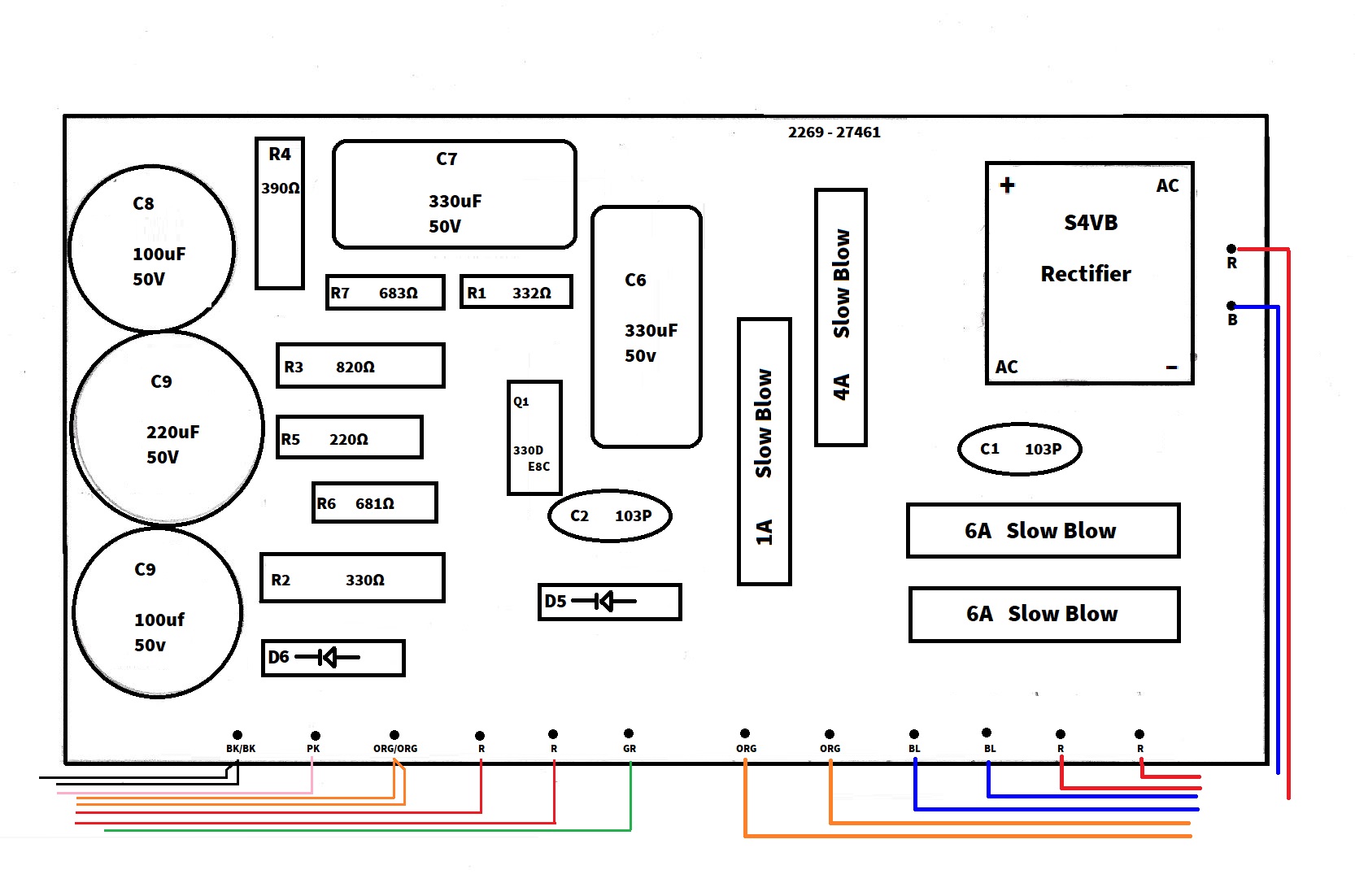

I also drew up a diagram of the front of the board with the marked values. The values marked on this diagram are what is marked on each component along with the location number marked on the board itself.
I removed both STK chips and temporarily installed each one in another (LXI) receiver and both work perfectly.
While looking at the p/s board, I noticed that the red and blue wires next to the rectifier, which come out of the transformer secondary side, connect to the + and - terminals of the rectifier? These wires become live when the switch is turned on even without any fuses on installed on this board. All of the six heavier gauge wires on the rigt side of this board go into a hole in the transformer casing, the other six go from this board to various other boards on the unit and ground.
With the switch on, there is voltage at each of the six heavier wires, coming from the transformer, but nothing leaving the board with or without the fuses in place. With the 1, 4, and 6a fuses installed. I used a dim bulb tester to test for a short here first. This remains even if I remove the six smaller gauge wires to the other boards.
I tested each component, five of the resistors read less than half of their rated ohms, and only one capacitor functions at all. The one 330uF cap nearest the transistor is a dead short with .007Ω resistance and zero capacitance, I got the same from the single 220uF cap, and C8 showed twice the capacitance and a very low ESR reading.
R4 = 180Ω
R3 = 549Ω
R5 = 79Ω
R2 = 102Ω
R7 = 1000Ω
R1 = 320Ω
There is continuity between the + terminal and upper right AC terminal on the rectifier in both directions.
All three legs of the transistor, (Q1), are shorted together with zero resistance with it removed from the board.

I also included a wider view pic showing the single large cap in the corner, it has three posts on top and six wires on it. I can't read the value on it. Its about 4" tall and 2.1" in diameter
To be sure on that rectifier, you'll have to take it out of circuit... you may simply be reading a short due to the transformer winding.
That 2SD330 transistor is probably best replaced. A TIP31C will do the job.

The rectifier was tested out of circuit, there's no doubt its bad. The same with the transistor. It reads zero ohms between all three pins.
What surprised me the most is how far off the resistors are, none of the larger power resistors are anywhere close to what they're marked.
I'm also not clear on why the two wires on the dc legs of the rectifier go back into the transformer? The two red wires each feed one of the 6A fuses through pins 1 & 2, the fuses are connected through the traces to the rectifier on the ac side. The small ceramic cap is across the two AC feeds on the rectifier. These parts do not connect to the rest of the board at all, the rectifier, the two 6a fuses, and the one small cap are separated. The power comes in from wires that come from the transformer, and the two DC wires go over to the big single capacitor in the corner.
I have a good used rectifier, but I'm not seeing what caused this yet. The rectifier isn't directly related to the transistor that overheated so bad, and both STK chips test out fine and work. I'm assuming the extreme heat from the transistor is the cause of the resistors being so far off, and maybe even the caps around it leaking. But what caused the transistor to get so hot?
I did figure out how to test the big capacitor, one pin is common, if I test it in two halves, I get 6750uf and 6737uf per side. The markings on it are in Japanese with only the 85°C marking being in normal text.
Is it possible for an STK chip to test out fine cold and act up hot? Both of these played fine in an LXI receiver I have here but I only put them in that circuit as temporary installation, soldered just enough to make contact with only a pair of spring clamps to ground the heat sinks. I let it play for about 3 or 4 minutes tops.

In your latest pics, it's pretty clear that those large red resistors and the transistor have been running hot for a long time and it wasn't unexpected, judging by their spacing from the board. The transistor appears to be a regulator for a low voltage supply such as for the preamp, tuner, maybe even the lamps. As those caps have been replaced, it's harder to know what the actual cause of the transistor failure was but you'd think it would most likely be downstream, not in the power amplifier.
What makes you say the caps were replaced? I've not yet changed any parts, the pics were all taken before I unsoldered anything.
As to parts on hand, I have an identical rectifier here, not sure what it came from but it tests good. The transistor, caps and larger resistors will have to be ordered.
I also found a box of new old STK modules here, but no 082 chips, but I do have a pair of brand new STK086 Sanyo OEM chips here. (I bought a bunch of parts at an auction about 20 years ago, those are from that lot of parts). I'm not sure how to go about figuring out what the replacement resistors should be, I have values but not wattage.
The LXI receiver I tested the STK082 chips in has cement type resistors on its power supply board.
The red resistors don't show the heat damage that the transistor does, the cap right next to it is actually melted. If it were the red resistors making the heat, the transistor would have shielded the cap or I'd see an outline of the transistor shape on the side of the cap. The transistor seems to be the hot item on the board. I don't doubt that the resistors also got hot but I don't think they were the source of the heat.
What gets me is that none of the thin wires leading from this board are burn, they can't be more than 20ga. at best.
Caps C9, and C6 are shorted, C9 is a dead short with the neg. side connected to chassis ground via the black wire on pin 12.
It seems like there was a lot of heat for a long time before it blew the fuses?
All the fuses were correct and nothing in this thing appears to have been repaired before. The caps in this are unbranded, but they match every cap in this thing except for two orange colored caps on the amp board and the big filter cap in the corner. Do they not look correct for one of these?
The few replacements I've got on hand are Nippon branded. I'll have to order a few of the values I need plus the transistor and those wire wound resistors.
I assumed the small caps on the power board were replaced because 30+ years ago, the printing on Japanese caps was not as sharp as we see now. I could well be wrong and admittedly, those on the amplifier board look quite similar, under the dust. I certainly wouldn't expect them to still have low ESR after that time, though.
Looking at the pic of the power board, there is a darkened area behind most of the red caps. No manufacturer fits large resistors unless they need to dissipate heat and larger sizes are necessary to give the resistor more power rating and extra surface area to dissipate more heat. Phenolic type boards like that, all darken over time but heat accelerates it. It's not necessarily charring, which is plain to see with epoxy/glass fibre boards, but a gradual darkening of the phenolic type resin itself, sped up by heat. I can say this because it was once my job to research and develop replacement materials.
It won't take much current, certainly not as much as needed to heat or burn small wiring, to overheat the regulator transistor. When there is no heatsink, it can only supply a fraction of its rated maximum power. Many Japanese designed TVs used numbers of such simple regs and even with small heatsinks fitted, they normally were roasting. A fault like a short downstream could easily overload the transistor and cause it to overheat and fail so as I wrote previously, you should check loads on power supplies first, just by disconnecting them if you don't have gear like a bench power supply to test the load current independently.
The only markings on these blue caps is the value and the letters CE-W in tiny print.
The board is charred on the surface in front of that transistor, enough so that the top layer is gone. I wiped off the char on the board and some of the components with some cleaner so I could read what they were. I don't think the board is damaged enough to be an issue though. Until I get hold of the new parts for this board, I can't do much more testing without any equipment here. The 6A fuses both blow even with all the board's outputs disconnected, but I was figuring that was due to the shorted transistor or rectifier. However, after following the traces on the back of this board, the rectifier and fuses are not directly connected to the rest of this board, they lead only to the dual 4700uF cap on the other side of the chassis. The shorted transistor and caps aren't in the same circuit as the blown fuses. Only the rectifier, larger cap, and eventually the main amp are.
I don't see any burnt damage or signs of heat on the main board, but if I remove both the STK chips the fuses survive me applying power and the dim bulb tester doesn't light the instant I turn on the switch. The pinout of the amps gives me voltages to look for but since I can't power them up in this board, I can't do that. All I can do is check for resistance between pins. Plus, both amps played fine in the other receiver.

In the right picture on the capacitor top upside down says 4700uF x 2. So it's (are) the main rail capacitors. Six wires makes sense. Two incoming + & - from rectifier, two outgoing to amp, and two for star grounding ?? Red1 and 2 on the left board (6A fuses) would go to this Capacitor and from there to the amp...No ! based on the chassis picture, the two red come from the transformer enter the fuses, get rectified and the the red and blue (should be + & - rail voltage ) goes to the large capacitor... and that black wire would be Your Ground. Check if these 3 wires, red, blue and black go to the capacitor. They Must !
The two small black wires go to chassis ground right next to the board, soldered to a tab. The middle wires on the big cap go to ground via a lug bolted to the heatsink between the two STK modules.
The red and blue wire leaving the rectifier go to the outer terminals on the 4700uF cap. The two red wires come from the transformer, go through the fuses, then to the rectifier. The heavier red and blue wires are what leave the power board and go to the capacitor.
