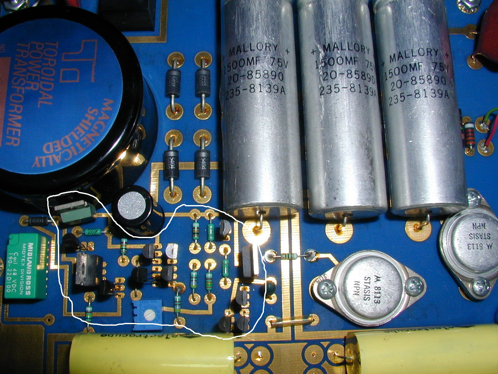

Got a Fet One today. Seems to have a defective Power Supply.
(A Lot of Transistors MPSA92, MPSA42, MPS6571, FPN4250A, FT317).
Output signal is not symmetric, same on both channels.
Has anybody the schematic?

As I said, a lot of transistors (13).
The Caps are all ok. Resistors too.
Did that already.
Found 4 completely shortened and one partial shortened.
Want to understand what happened and to avoid it happen again.
And of course what's the sense of it at all......
Is it sooo hard to understand, why I'm trying t reach a schematic?
Why?
Nominal capacitance 1.5 mF, measured 1.9/2.0 mF.
Typical ESR 170 mOhm, measured 120/130 mOhm.
Same advice as "change everything"?
